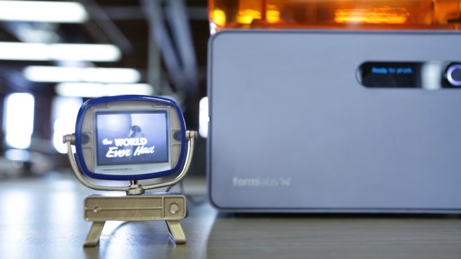

The Tiny TV is inspired by the Philco Predicta, an iconic if flawed hallmark of the 1950’s, and concept art by Dave Schultze. Built around a 2” LCD display from our friends at Adafruit, the Tiny TV was printed on the Form 1+ in Formlabs clear resin. The front lens was polished clear, and the body was sanded and painted. It works best when paired with hottest coming attractions of the 1950’s.
Download the .form files here to build your own Tiny TV.
After the print was finished, I went through the usual steps of rinsing, drying, and snapping off the support structures.
Then, I sanded it twice to get the smoothness I wanted, first with a rougher grain, then with a finer grain.
Finally, I spraypainted the body, and painted on the finer details, before connecting it to the 2" NTSC/PAL display from Adafruit.
