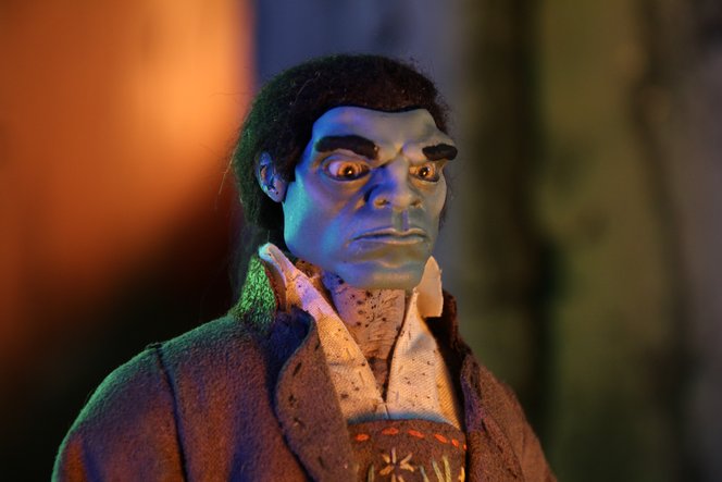

Creator Dawn Brown harnessed the power of 3D printing to make House of Monsters, a spooky stop-motion animation series. Using the Form 1+ 3D printer, her creative team printed hundreds of faces and props for the wacky characters.

The creators used magnets to switch between 3D printed faces quickly. The creators used magnets to switch between 3D printed faces quickly. We printed about 300 faces and props for the show using the Form 1+. It came to about $11 per piece, all costs considered. Previously, the same work would have cost over $30,000.

We exclusively used the black resin and printed at 25 microns for all the character faces. I do the IPA rinses as per the Formlabs recommendation. Sometimes if the pieces are still a little sticky, I post cure them in the sun for a few moments. Then they are sprayed with Kryon Fusion primer, airbrushed with traditional acrylic airbrush paints, and sealed with Krylon Matte Finish.
