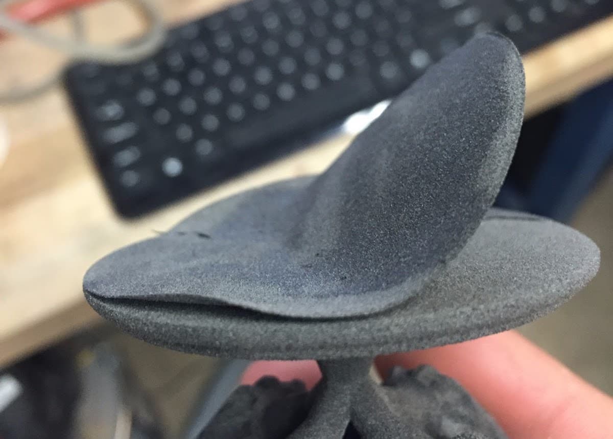

Delamination describes when layers of a print peel away, either partially or completely, from previous layers.
Visual symptoms
- Some layers are not fully sintered to previous layers
- Unexpected gaps between printed layers
- Delamination may be partial or total
