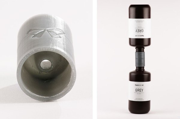

While working at the Formlabs printer farm at HQ, we’ve noticed that there’s always a bit of resin left in a nearly-empty bottle. It’s almost impossible to get that resin into a Form 1 for printing, but throwing it away would be a shame!
After thinking about how restaurants deal with nearly-empty containers, our designer Will modified the design of a ketchup-bottle joiner and printed the model on our Form 1s. The Form Funnel helps safely transfer that last bit of resin into a new bottle, so you can get more out of each bottle of resin. Here's how to make your own:
- Download the .form file here.
- Print the Form Funnel and clean it up like you would with any other Form 1 model.
- Wait until you have a bottle that no longer easily pours, but still contains a bit of resin.
- Place the Form Funnel on a fresh bottle of resin with the arrows pointing down.
- Quickly turn the nearly empty bottle over and nest it in the Form Funnel.
- After approximately 20 minutes, your remaining resin will have drained into the fresh bottle, and you’re ready to go!
