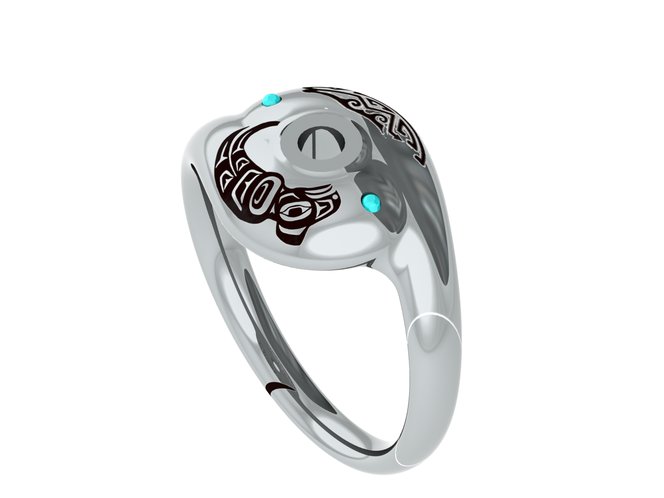

I loved that we could use Solidworks to have photo-realistic renderings of the ring in different metals. But on the screen it was enormous and out of context. So we printed this version on the Form 1+. The proportions didn't work. But we did like the idea of two sides of the ring coming together from separate worlds to form a continuous whole.
So we moved to more of a flattened vortex on top of which we would have the wolf and raven engraved. At the center of the vortex is the diamond. After looking at the design a bit, I realized I felt that just having a diamond at the center was too traditional. So Yoav and I brainstormed how to add more character. Turquoise is one of the key signatures of New Mexico, so we decided to add two small stones at the edges of the ring. Yoav carefully stashed prints of each iteration at my desk, keeping the process a secret. Once we agreed on the final design, he printed a version and sent it to a good friend who is an expert caster.
