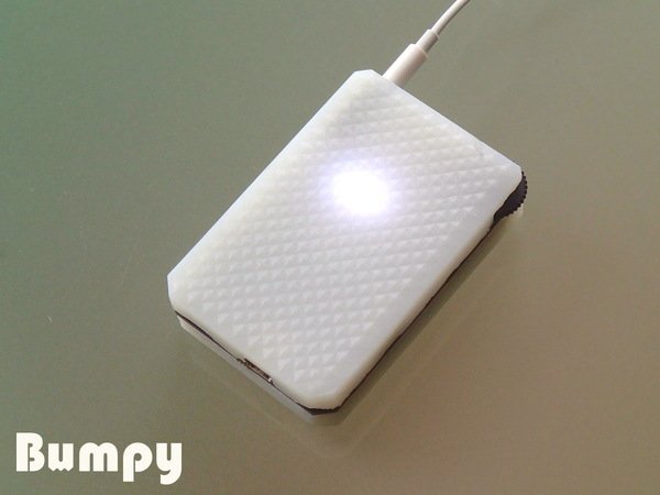

One of my goals for this project was to make something that looked like an actual consumer product. I didn’t want to finish the project with a bunch of bare circuit boards – I wanted to make a complete package, including the case.
In designing the case, I was trying to make it as thin and minimal as possible. The two case halves are bonded directly to the bare circuit board, and are very thin. The back case is only about 1mm thick where it presses up against the battery, and the top has small cutouts on the order of 1mm to fit electronics on the circuit board.
The eponymous texture was actually an after-thought. I printed a few versions with flat tops and bottoms but thought that it needed a little more character. It’s fairly subtle: the individual bumps are only 2 x 2 x 0.3mm, but it came out great.

I also switched from clear to white resin after an early test print, and I’m very happy with how the white resin diffuses the LEDs on the circuit board!
