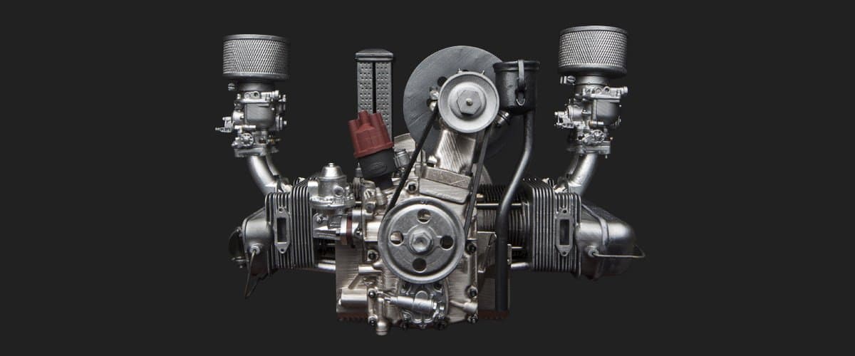

As an avid 3D printing user, Guerini decided to connect his two passions and create a 1:4 scale model of one of his favorites, the engine of a vintage 1952 Porsche 356, the first production automobile of the German company. This was far from an easy undertaking. It required disassembling the engine, scanning each component, and modeling and printing hundreds of parts.
Images of the model spread quickly in maker community, and requests started flowing in, prompting Guerini to start creating replicas to sell to collectors all over the world. What started out as a hobby might soon turn into a job.

Given their small size, many of the engine's components could be batched together for 3D printing. Manufacturing the 250 pieces–using three different resins, in five separate print jobs–took 45 hours altogether.
Once thoroughly washed and carefully separated from the support structures, all of the parts were post-cured. The most time-consuming part of the post-processing was reworking the tiny holes in some of the pieces. Many of these are threaded for M1.6, M2, M2.5 screws, while others are bored out, so the parts fit together perfectly.
Before painting, the surfaces of the parts were sanded to remove the attachment points of the support structures. Guerini then used specialized modeling metallic paints (AK Xtreme Metal and Vallejo Acrilics) to airbrush parts and achieve a color as close as possible to the original Porsche components.
Then, it was time for the last step: assembly. It took four hours to piece together the 250 delicate parts.
