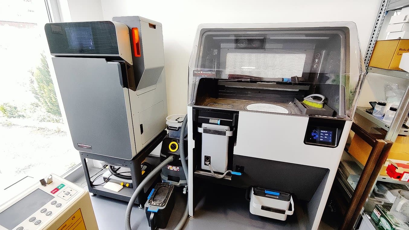

Fuse in Marcus Marienfeld Manufaktur
With this ambition, he decided to incorporate Formlabs material Nylon 11 Powder into his eyewear designs. First, many different designs, mainly of frame fronts printed on the Fuse 1, were tested in Marienfeld's studio. The Fuse 1 was also recently used for the first time for manufacturing a series. A total of 80 finished frame fronts could be produced in one print in a period of approx. 1.5 days.
80 frame fronts in the Fuse 1
Thanks to the large build volume of the Fuse 1, a total of 80 frame fronts could be stacked and produced in one print without supporting structures.

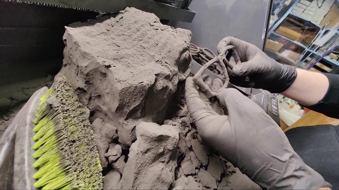

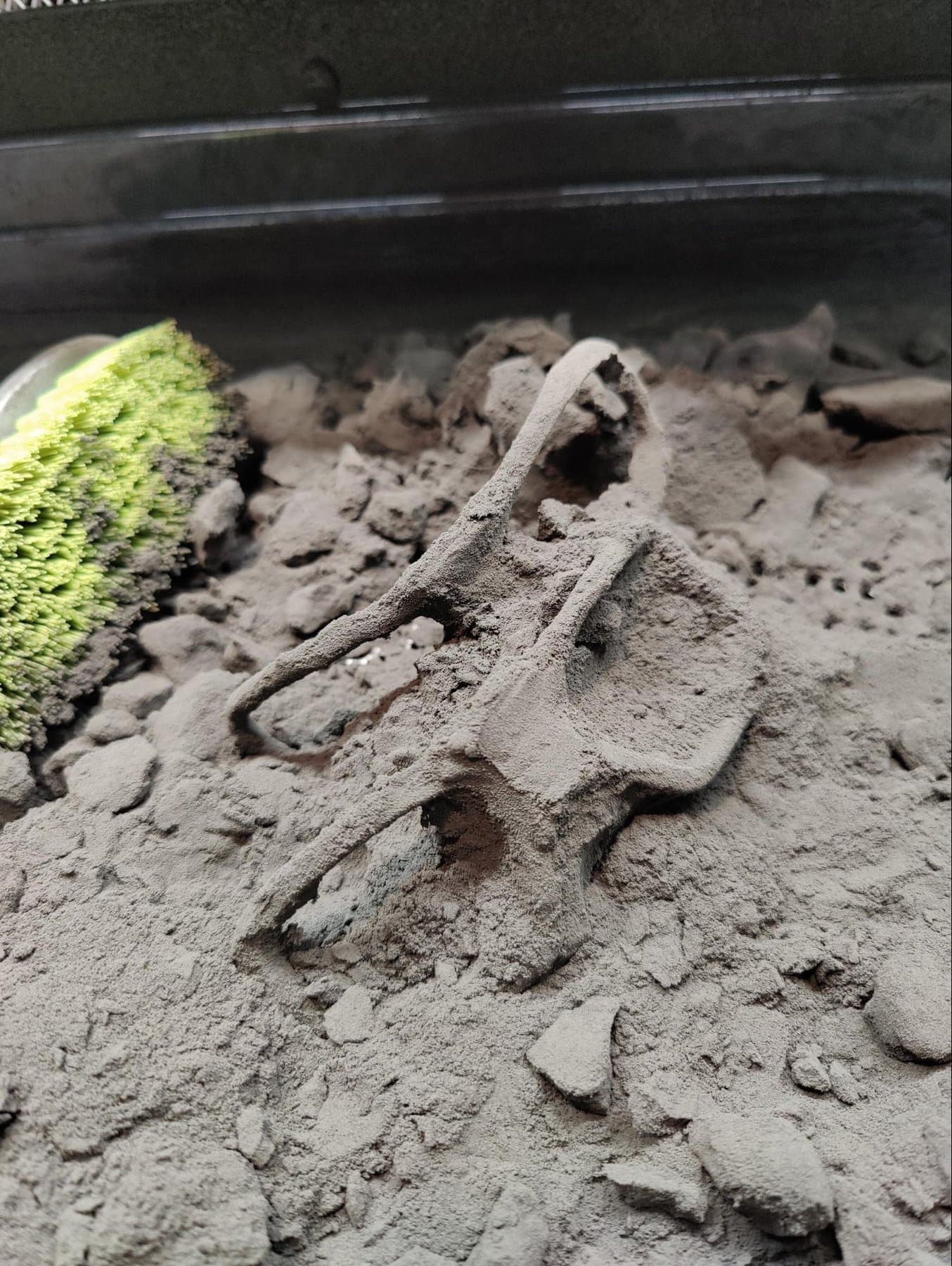

“One of the great things about SLS 3D printing is that it can print nested parts without support structures.”
Marcus Marienfeld
Brillenfront im Fuse Sift
Nylon 11 Powder eyewear frames undergoing post-processing in the Fuse Sift.

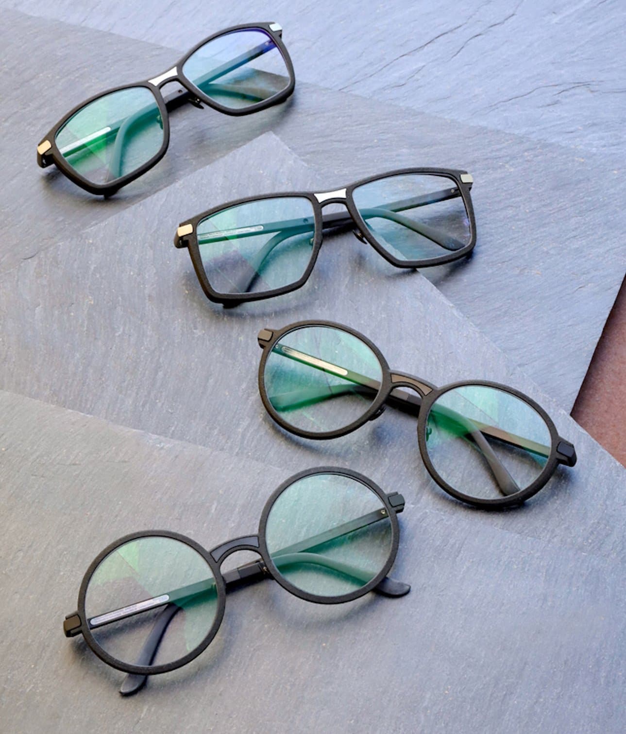

Fuse 1 keeps opening up new horizons for the designer. “We have designed special glasses that are not just flat, but thicker on the outside. They are constructed almost conically. To build something like this, 3D printing is key. We can easily implement special designs that would not work with other technologies,” explains Marienfeld.
Ready-made Marcus Marienfeld glasses made of Nylon 11 Powder and carbon.

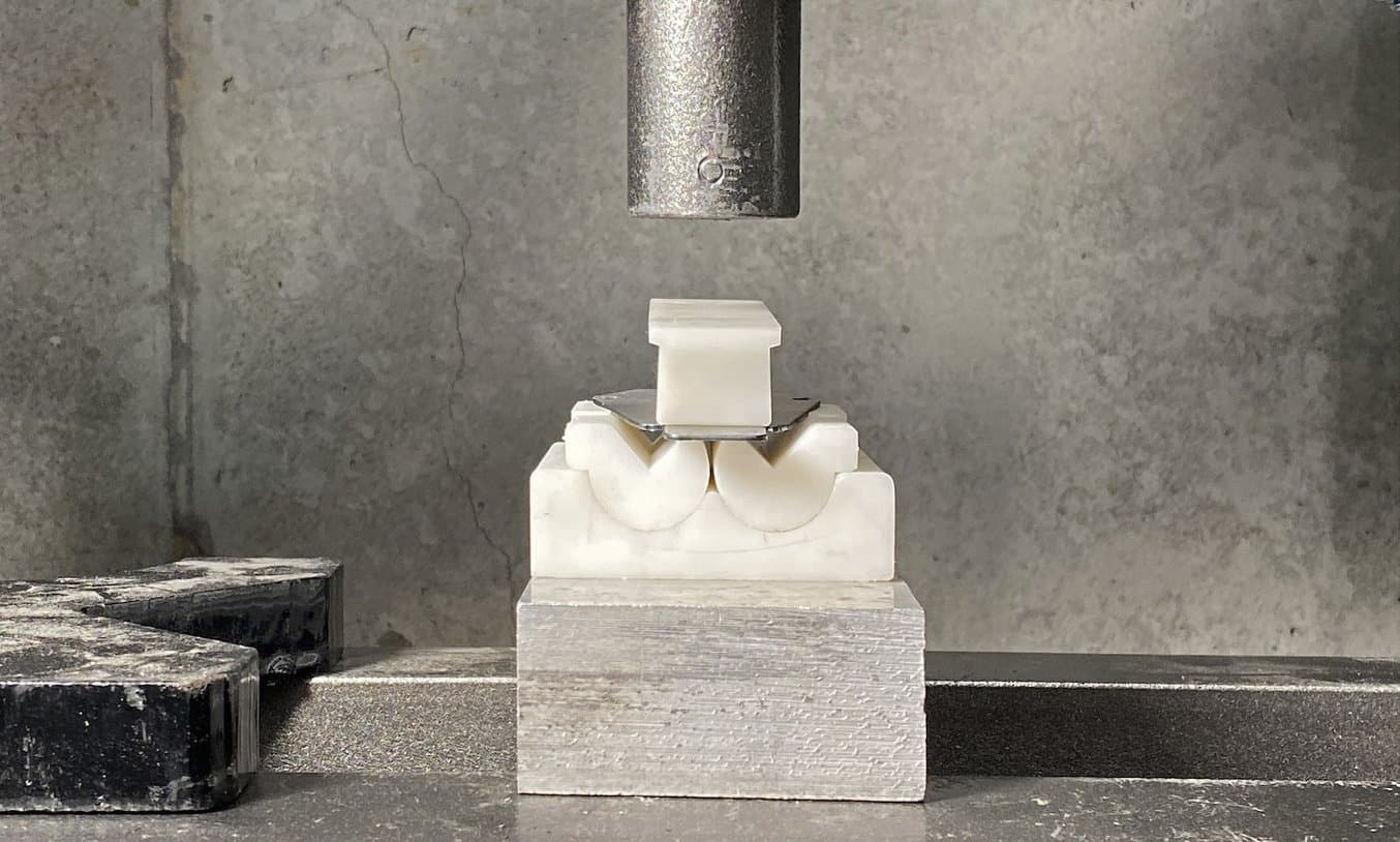

As well as manufacturing glasses with nylon elements, Marcus Marienfeld AG also produces its own tooling on the Fuse 1. Nylon 11 Powder is particularly suitable for producing tooling for glasses made of titanium due to its strength and dimensional stability.
“The disadvantage of titanium is that it is difficult to form, bend, or mill. But I had the idea of trying it with a 3D printed Nylon 11 Powder press tool, and it works perfectly.”
Marcus Marienfeld
“We make pressing tools to bend glass frames into the right shape. A different curvature of the frame needs to be created depending on the model of the glasses. We used to do this very laboriously with steel tools, which incur high costs per model,” says Marienfeld.
Such a manufacturing aid made of Nylon 11 Powder, consisting of an upper and lower tool, is screwed into a toggle press in the factory and can withstand a pressure of approx. 90 kilograms. Nylon 11 Powder's excellent dimensional stability prevents any indentations from appearing on the tools in the places where the titanium edges come in contact with the tool at such high pressure.
SLS 3D printed Nylon 11 press tool screwed into a toggle press.
SLS 3D printed Nylon 11 Powder press tool screwed into a toggle press.
