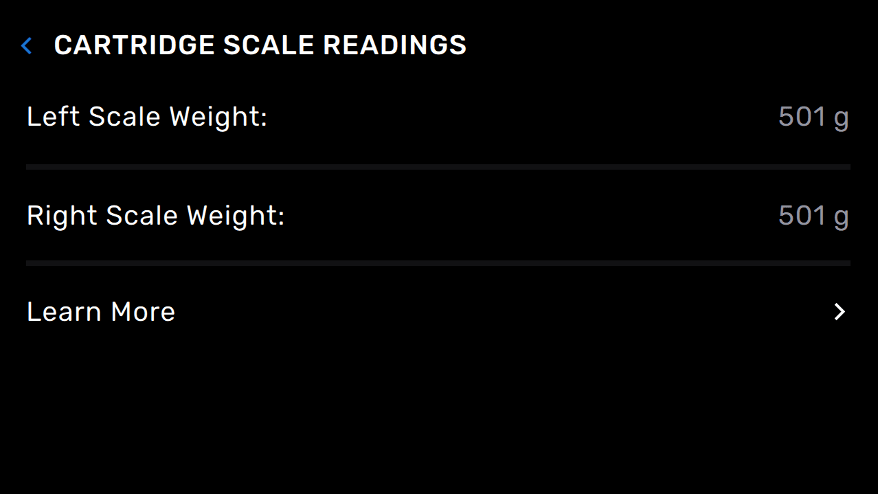

If taring the cartridge scales does not resolve the issue, check the scale readings when an empty cartridge is inserted and when the cartridge drawer is completely empty:
  1. On the touchscreen, tap Settings > System > Cartridge Scale Readings. The left and right scales should register between 500–600 g (+/- 100 g) each (for roughly 1 kg in total) when an empty powder cartridge is in the cartridge drawer. Take a photo of the touchscreen.
