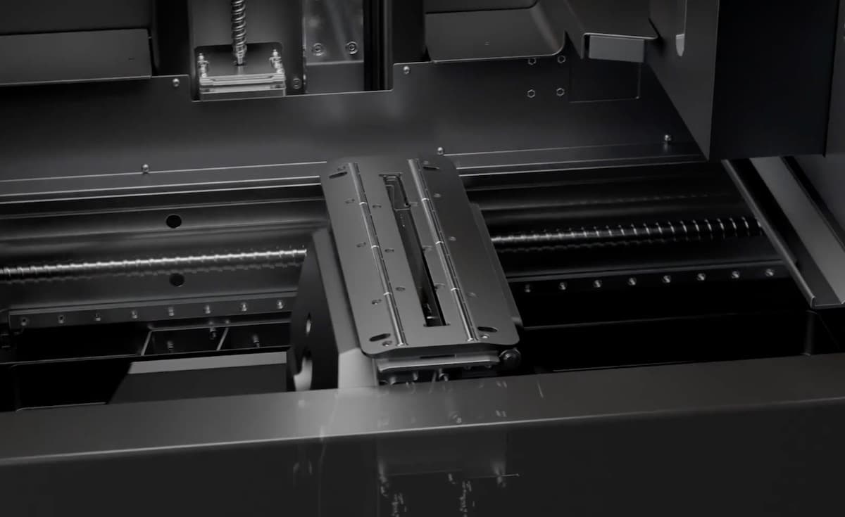

Form 3 maintenance position
  1. Disconnect the power cable before continuing with maintenance.
  2. The garage fiducial board is located in the LPU garage, the space on the right side of the printer where the LPU housing sits when the printer is idle. Use a small mirror, cell phone camera, or other similar device to look up at the ceiling of the LPU garage. Shine a secondary light source (for example, a flashlight, LED or cell phone light) onto the garage fiducial board to reveal any hidden contamination on the surface.
