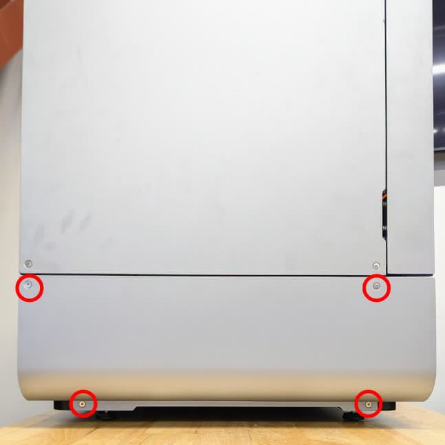

Use a 2.5 mm hex driver to remove the four screws securing the left panel to the printer. Set the screws aside.
Step 2: Remove the lower left side panel
Pull the side panel directly away from the printer. Set the panel aside.

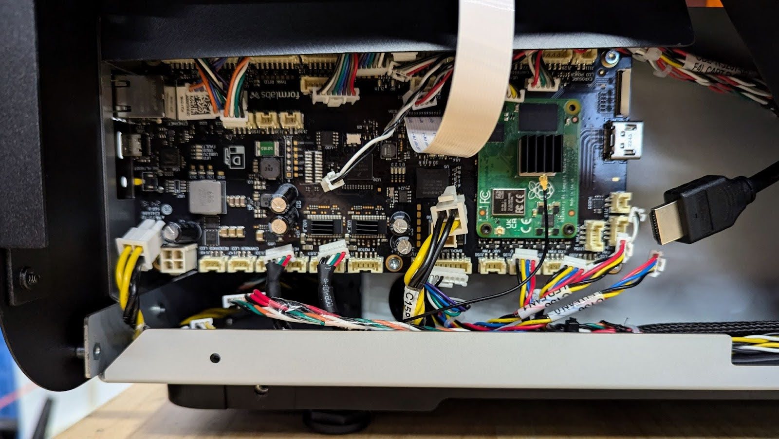

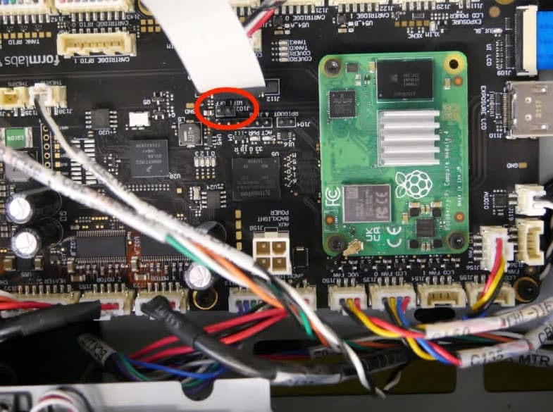

The Form 4L motherboard is installed upside down in the printer. Locate the header labeled WI-FI OFF near the center of the board below the camera ribbon cable.
Step 2: Install the Wi-Fi jumper
Place a 2-pin jumper (0.1 in / 2.54 mm pitch) on the header to disable Wi-Fi on the machine.
Step 2: Install the wi-fi jumper
