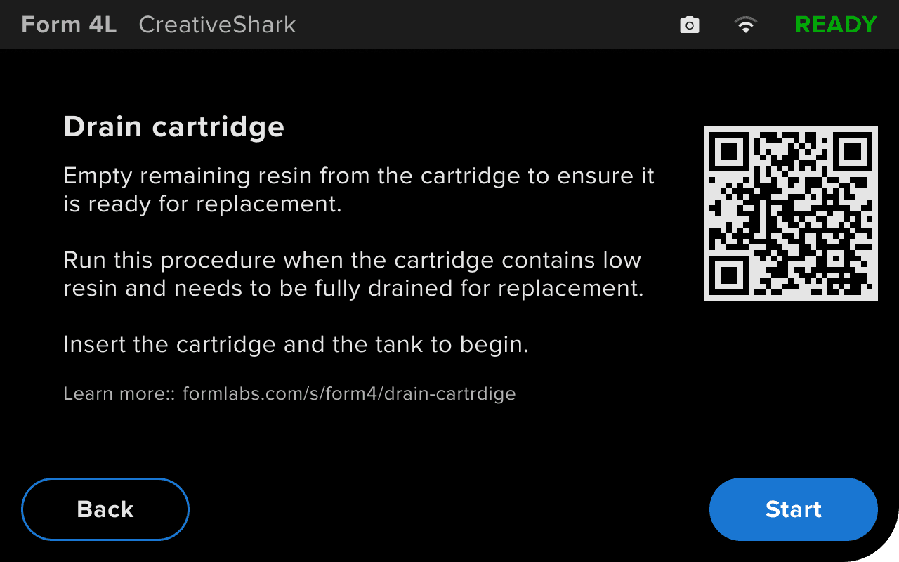

The Drain Cartridge tool allows Form 4 and Form 4L generation printers to safely empty resin cartridges into the tank and prevent material wastage. The Drain Cartridge tool requires the resin tank to match the resin type in the installed resin cartridge.

- On an idle Form 4 or Form 4L generation printer, tap the gear icon. The Settings screen appears. Tap Tools > Drain Cartridge.
- Follow the onscreen prompts to complete the procedure. The process may take several minutes.
