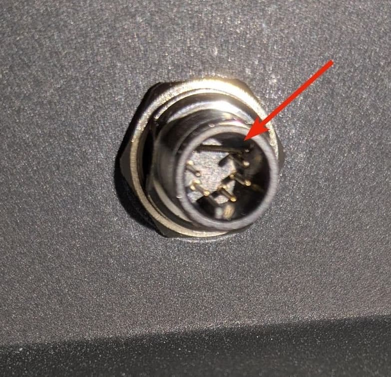

Inspect the foot pedal connector
The Fuse Blast is shipped with a foot pedal used for manual blasting and rinsing parts.
  1. Unplug the pedals from the Fuse Blast.
  2. Inspect the connector on the Fuse Blast for any bent pins.
  3. If there is a bent pin, gently try to straighten the pin. If a pin cannot be straightened or is fully broken, contact Formlabs Support with a photo for further assistance.
Fuse Blast foot pedal connector
