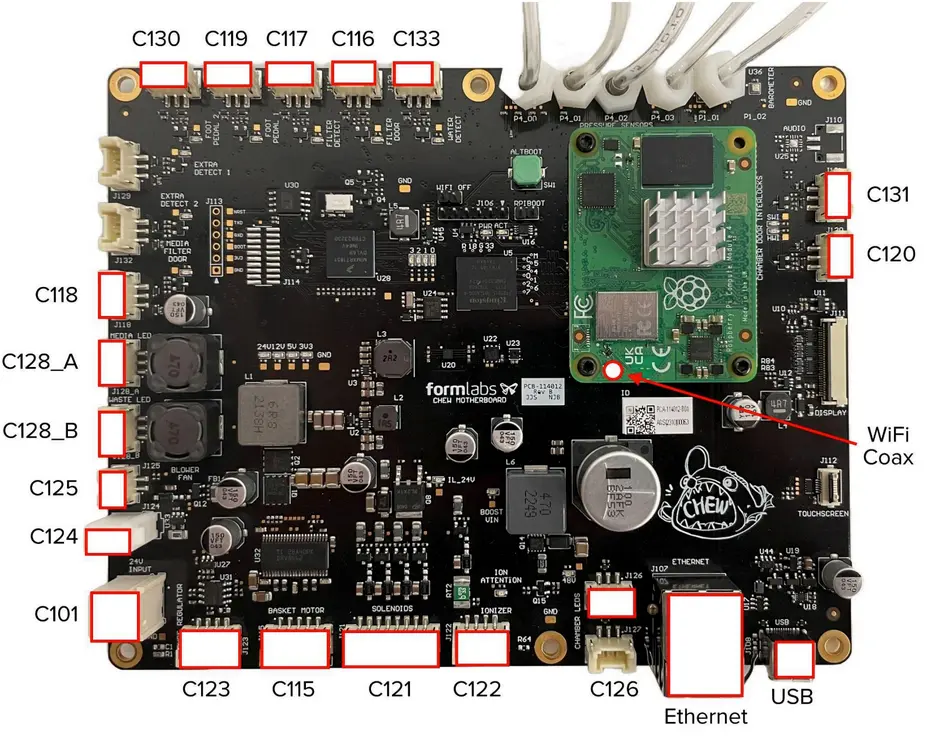

  6. If the machine appears in PreForm or appears to be receiving power, reseat the display cable. Follow the instructions in the guide Fuse Blast - Replacing the Motherboard and Display Assembly. The display ribbon cable connector is located on the right side of the motherboard, labeled DISPLAY. The display ribbon cable is secured in the connector with a latch. Lift the latch away from the motherboard to free the cable. Once the latch is in the upright unlocked position, the ribbon can be easily removed. Fully reseat the cable and close the latch.
  7. If the issue persists after reseating the display cable, the display may need to be replaced. The display and motherboard come as a single assembly, which is available for purchase on the Formlabs Store. To replace the component, follow the instructions in the guide Fuse Blast - Replacing the Motherboard and Display Assembly.
