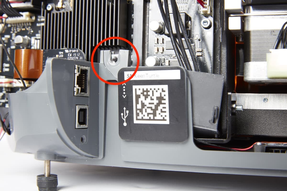

Step 1: Remove the rear shell screws (internal)

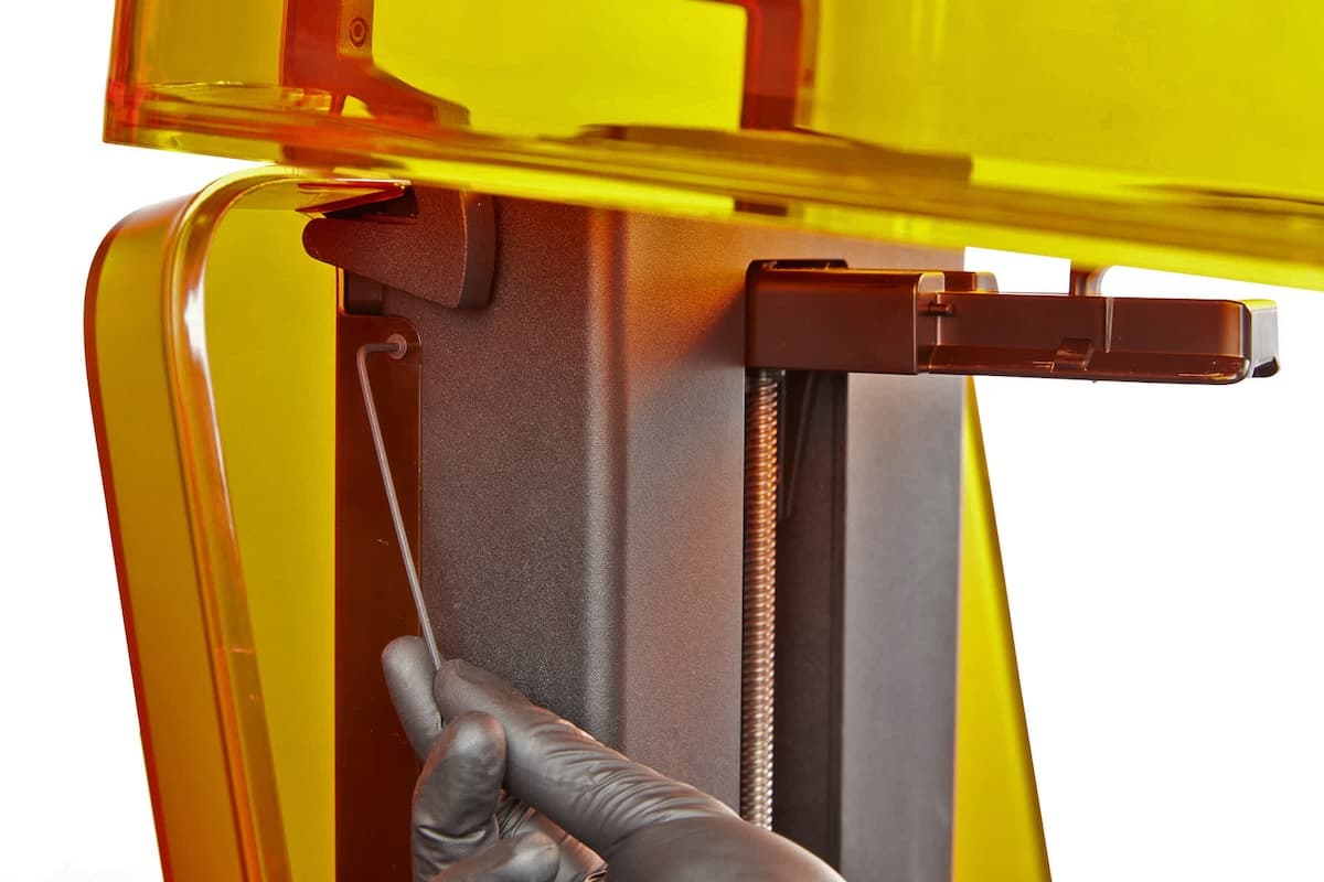

Open the printer cover. There is one screw on each side of the Z-tower. Depending on the age of your printer, they may be 2 mm hex screws or T10 Torx screws. Use the appropriate driver to loosen and remove the two screws on the side of the Z-tower.
Step 2: Remove the rear shell screws (external)

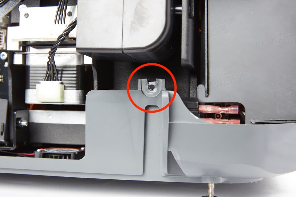

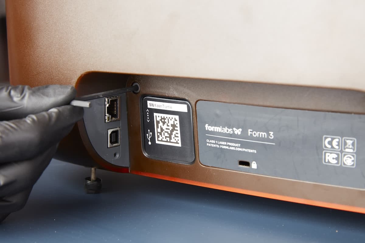

Rotate the printer to access the rear. Use a 3 mm hex driver to loosen and remove the two screws on the back of the printer, near the power and data ports.

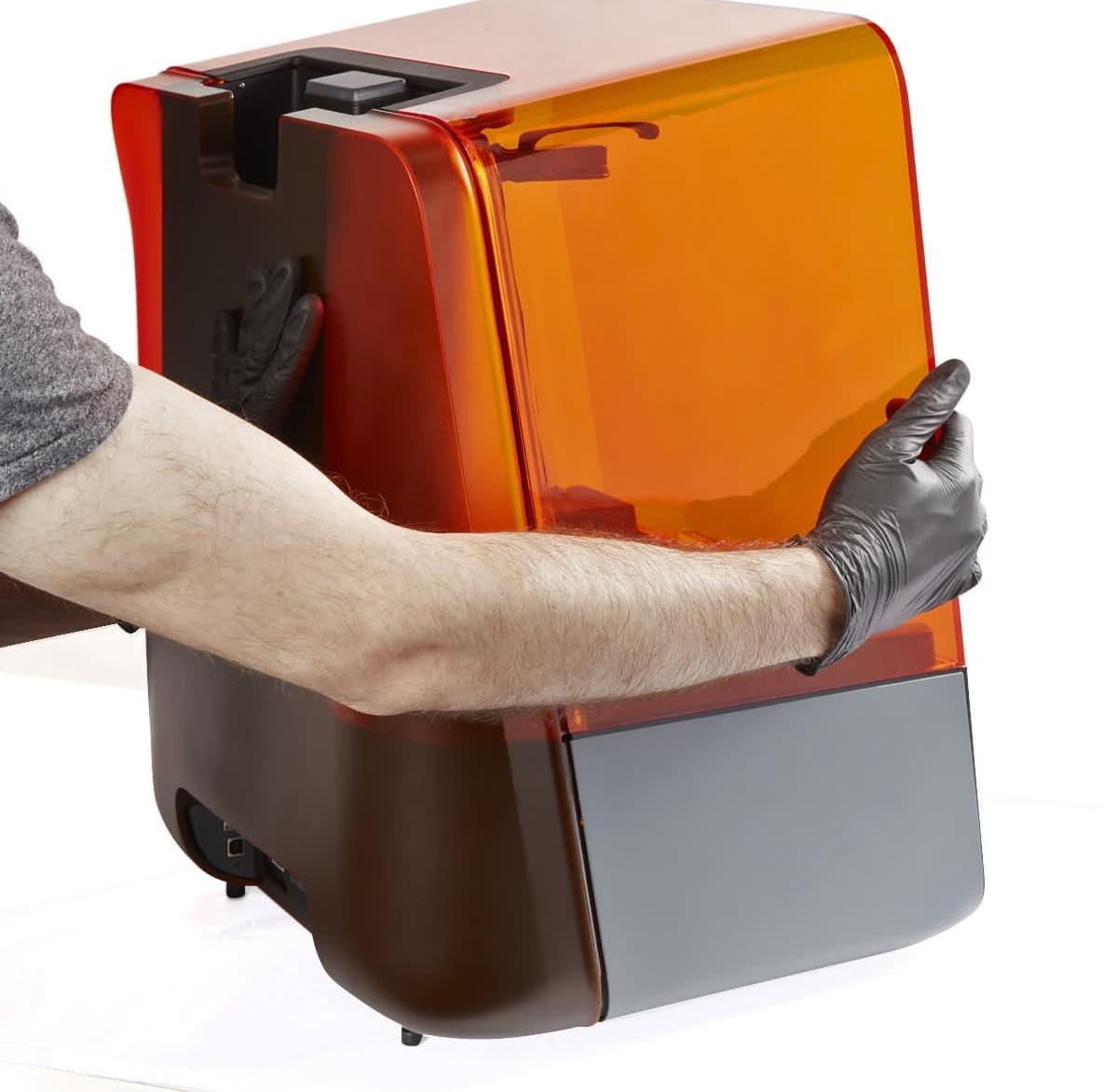

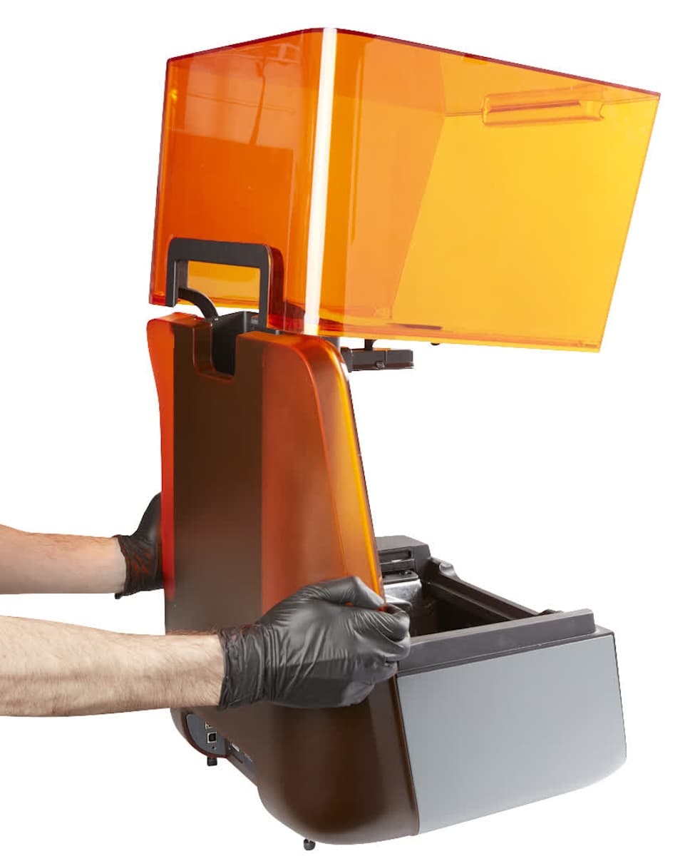

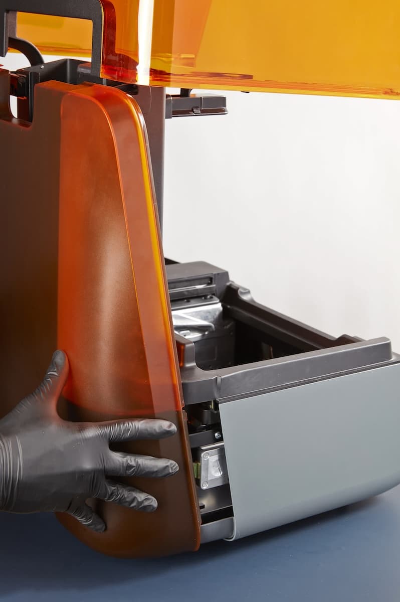

Gently flex the sides of the rear shell outwards to unclip it from the printer frame. Pull the rear shell directly away from the printer to remove it. Set the rear shell aside.

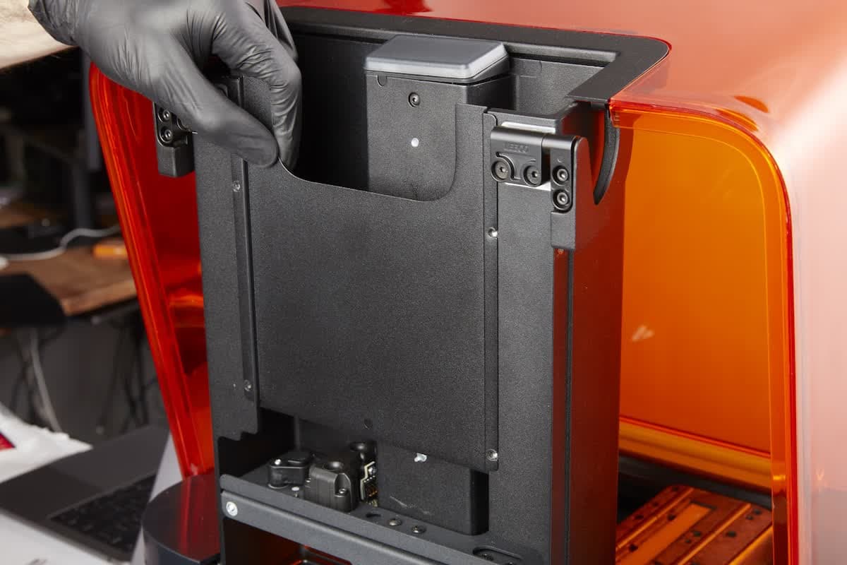

Removing the cartridge slot plate
Overview: Remove the plate that covers the resin cartridge slot to gain access to the cartridge dispense spring.

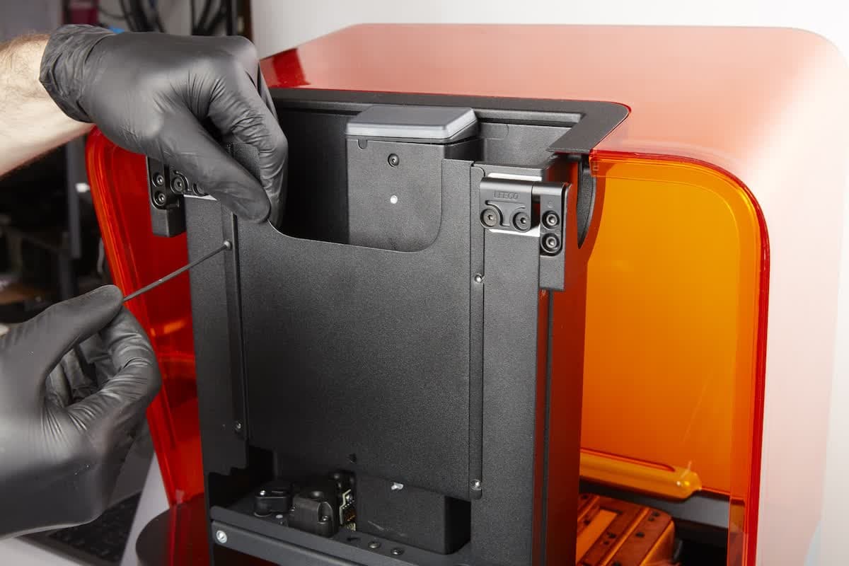

Step 1: Remove the cartridge slot plate screws

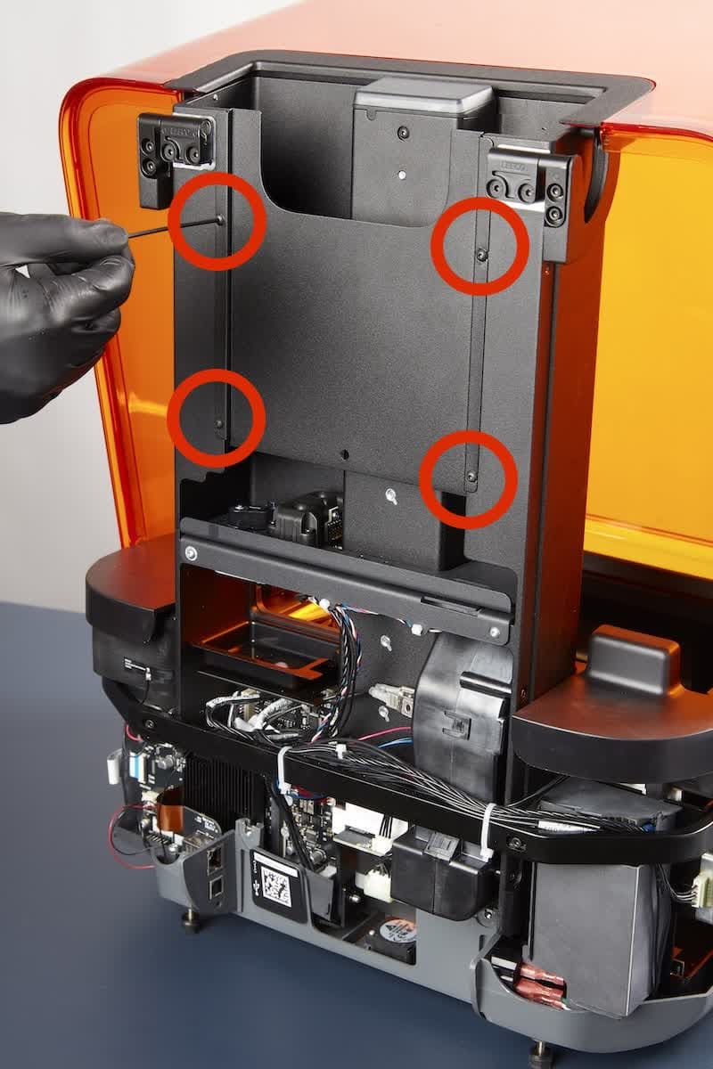

Use a 2 mm hex driver to loosen and remove the four screws holding the cartridge slot plate to the Z-tower.

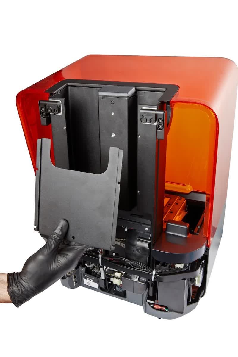

Step 2: Remove the cartridge slot plate
Remove the cartridge slot plate and set it aside.

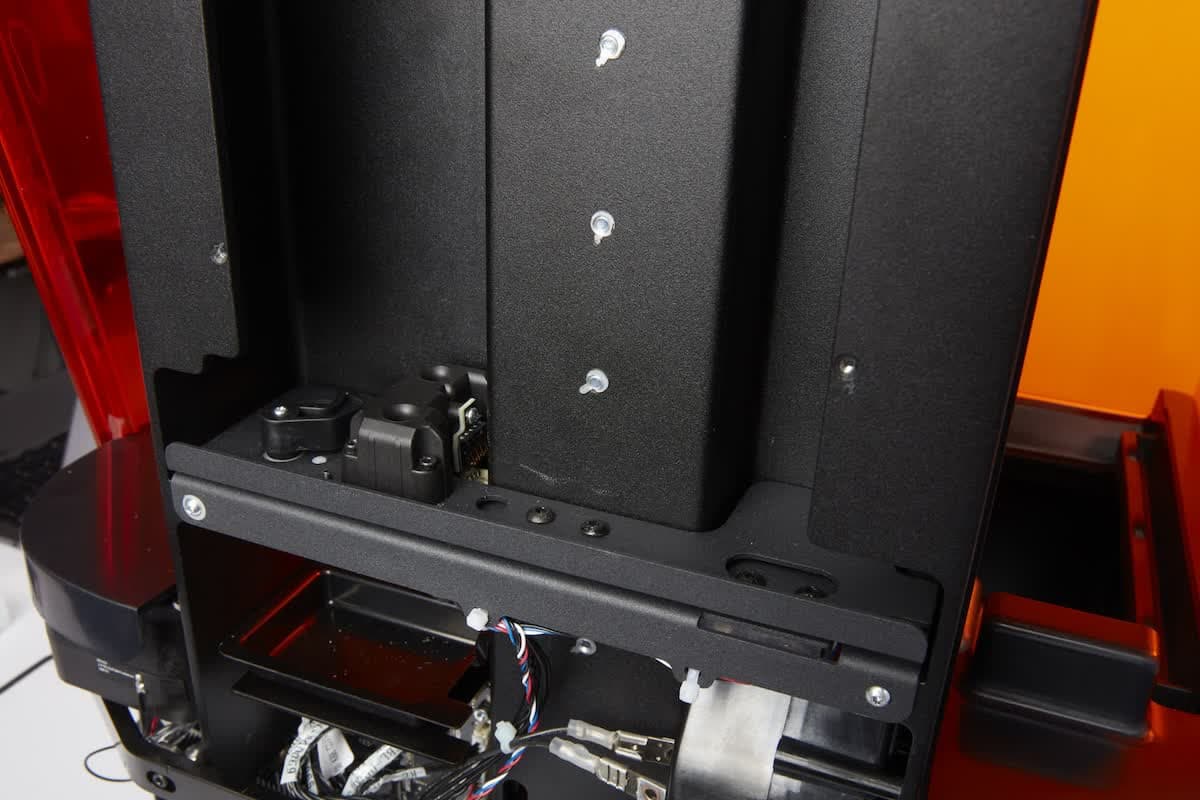

Removing the cartridge dispense spring
Overview: Clean the cartridge floor and remove the cartridge dispense spring from the printer.
Step 1: Clean the cartridge floor
Absorb any resin on the cartridge floor with a clean paper towel.

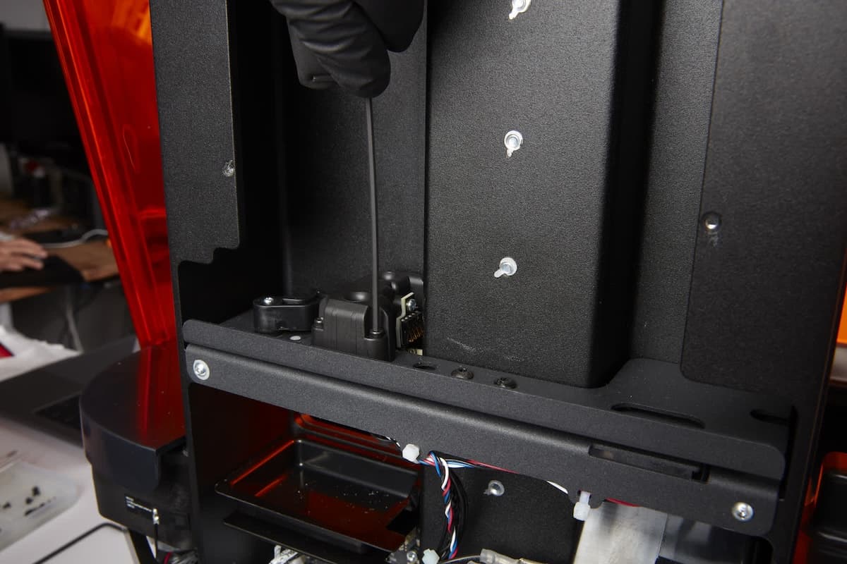

Step 2: Unscrew the cartridge spring finger assembly screws

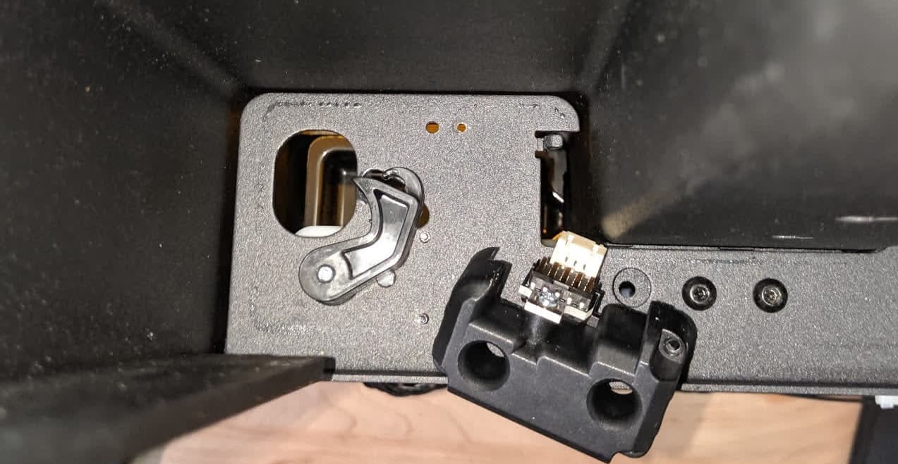

Use the 2 mm hex driver to loosen and remove the three screws that secure the cartridge spring finger assembly to the bottom of the cartridge slot.

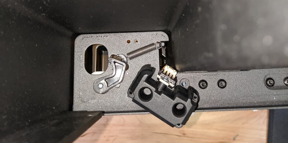

Move the cartridge spring finger assembly to the side to access the cartridge dispense spring. Do not unplug the cartridge spring finger assembly.

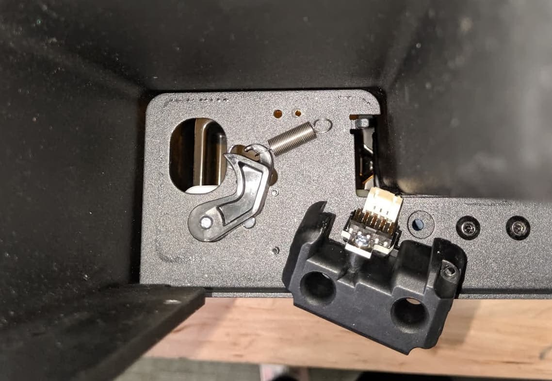

Step 3: Remove the cartridge dispense spring

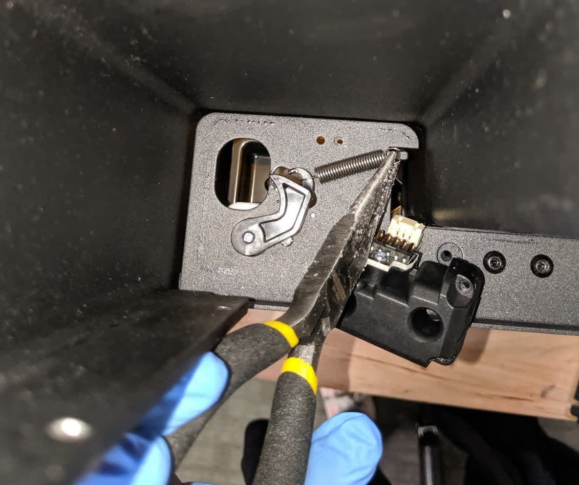

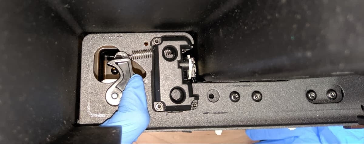

The cartridge dispense spring is attached to the resin dispense arm and to a metal tab on the cartridge floor. Gently remove the spring from the metal tab using needle nose pliers, tweezers, or another similar tool.
Remove the other end of the spring from the dispense arm. Set the spring aside.

Step 1: Install the cartridge dispense spring
Slip the ends of the cartridge dispense spring over the hook on the resin dispense arm and over the metal tab on the cartridge floor using needle nose pliers, tweezers, or another similar tool.
Step 2: Test the cartridge dispense spring
Push the dispense arm to extend the cartridge dispense spring. Release the dispense arm and ensure that the spring fully retracts.

Step 1: Align the cartridge slot plate
Orient the cartridge slot plate vertically, with the cutout at the top. Align the four holes in the cartridge slot plate with the four screw holes in the Z-tower.
Step 2: Install the cartridge slot plate screws
Thread one 2 mm hex screw into each of the four holes. Tighten the screws using a 2 mm hex driver. Do not overtighten to avoid stripping the screw threads.
