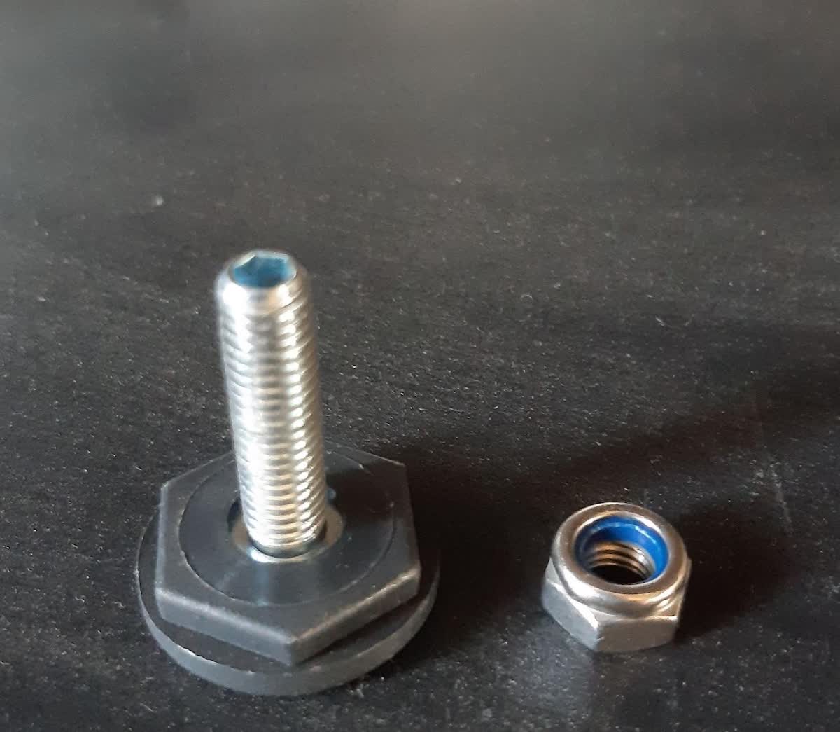

The Form 3L has four adjustable feet that raise the printer off the work surface and allow it to be leveled before printing. If one or more of the leveling feet is damaged or missing, it may be difficult to keep the printer level. Unleveled printers may cause print failures.
Use this guide to replace a leveling foot on your Form 3L.

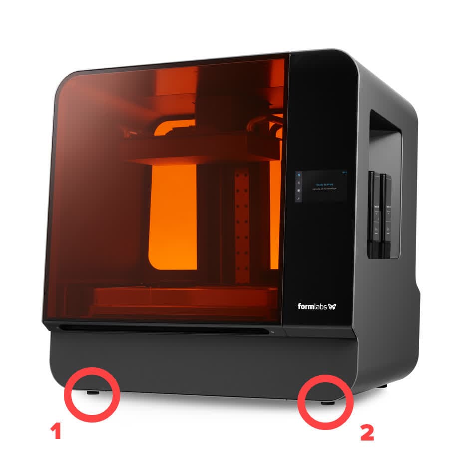

Accessing the leveling foot
Overview: Identify the leveling foot you wish to replace. Each leveling foot requires different access instructions. Proceed to the step that is most relevant for your repair needs and remove the leveling foot.
Step 1: Identify the leveling foot in need of replacement
