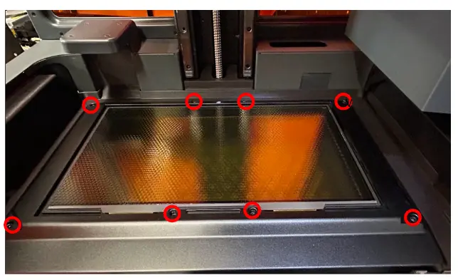

Step 1: Loosen the LPU housing screws
Open the printer cover. Use a 3 mm hex driver to loosen the eight captive hex screws in the LPU housing.

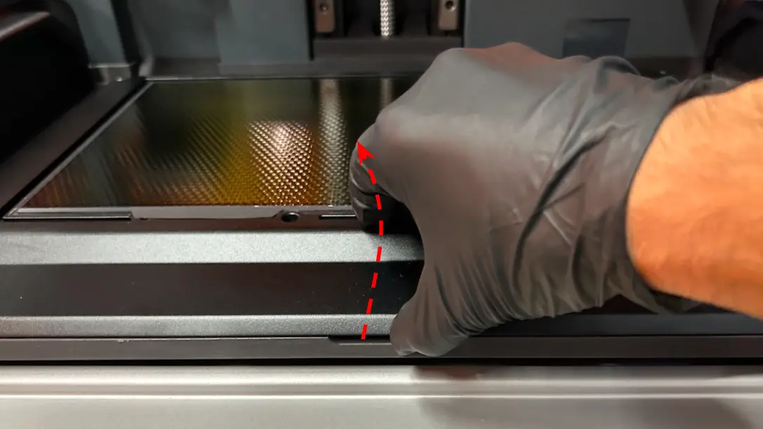

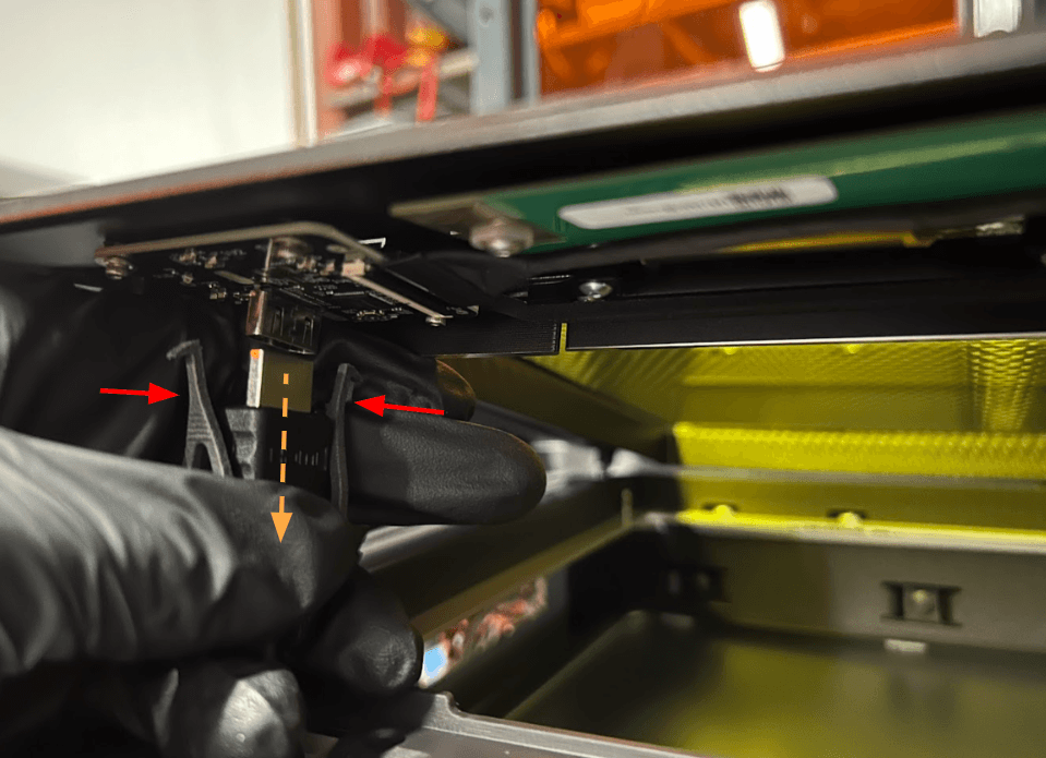

Carefully lift the LPU and tilt it so that the bottom faces you.
Unplug the HDMI cable.
Carefully lift the LPU and tilt it so that the bottom faces you. Locate the LPU’s HDMI cable. Squeeze the plastic retaining clip and unplug the HDMI cable from the LPU.

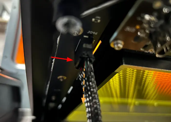

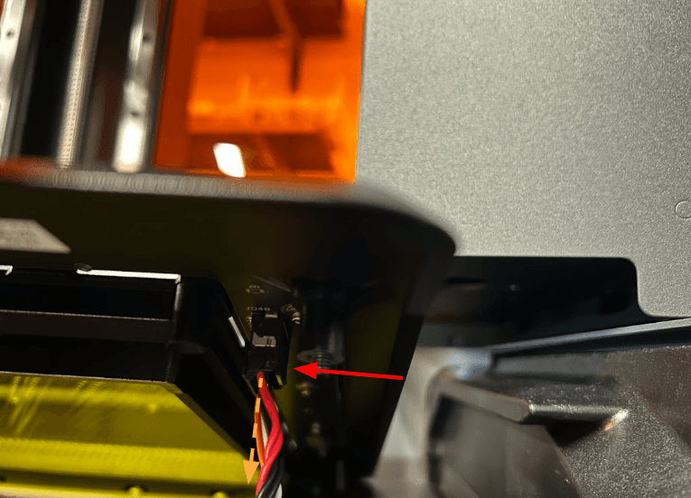

Step 3: Disconnect the tank heater cables
On both sides of the printer, the heater cables are oriented with the clip facing outwards. Release the tank heater cables by squeezing the tab on the connectors and pulling directly away from the LPU. Do not pull on the cable itself.
Disconnect the left tank heater cable.
Disconnect the right tank heater cable.

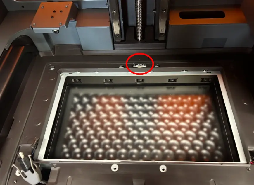

Removing the resin temperature sensor
Overview: After removing the LPU, remove the resin temperature sensor.

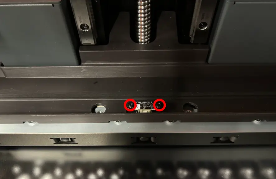

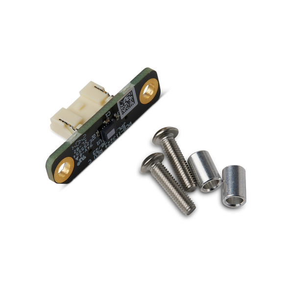

Step 1: Remove the mounting screws
The resin temperature sensor is mounted to the printer with two screws and two spacers. Use pliers or tweezers to hold the spacers while removing the screws. Use a 2 mm hex driver to remove the screws. Set the screws and spacers aside.
Note:
When removing the screws, hold the spacers so they don’t fall into the printer cavity. If a spacer or screw falls into the optical cavity, retrieve it with tweezers. If a spacer or screws falls into the hole under the resin temperature sensor, remove the right panel and use tweezers to remove the screw from the front cavity.

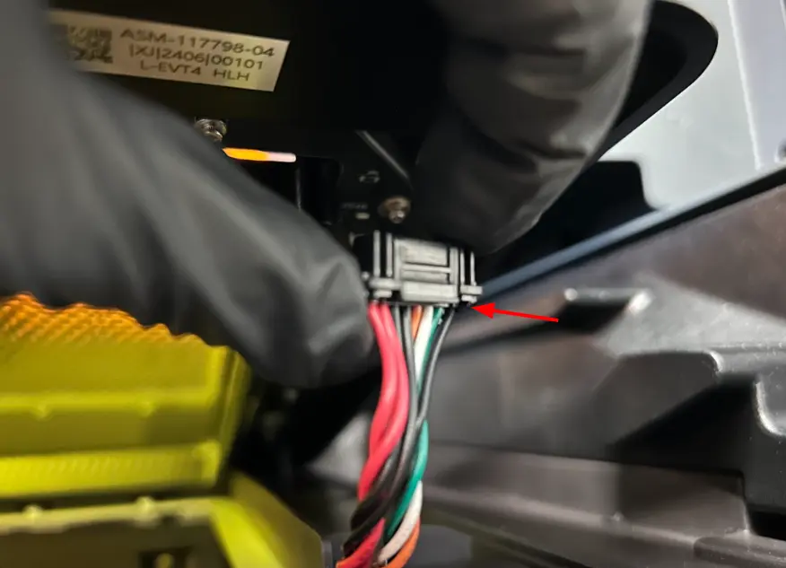

Step 2: Disconnect the cable
Release the resin temperature sensor cable by pressing the plastic tab on the connector. Unplug the cable from the resin temperature sensor. Do not pull on the wires.

Thread one mounting screw through each of the screw holes in the replacement resin temperature sensor. Slide a spacer onto each of the screws. Carefully lower the resin temperature sensor into place, lining up the mounting screws with the screw holes in the printer frame. Use a 2 mm hex driver to tighten the screws until snug.

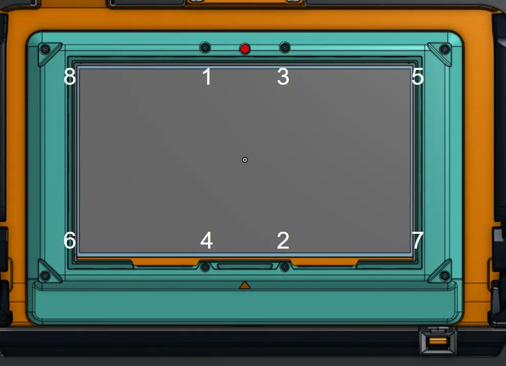

Step 5: Secure the LPU
Secure the LPU
Once all screws are loosely threaded, tighten the screws in a diagonal pattern as shown above. The screws should be secure but not overtightened. To avoid overtightening, grip the short end of the hex driver.
