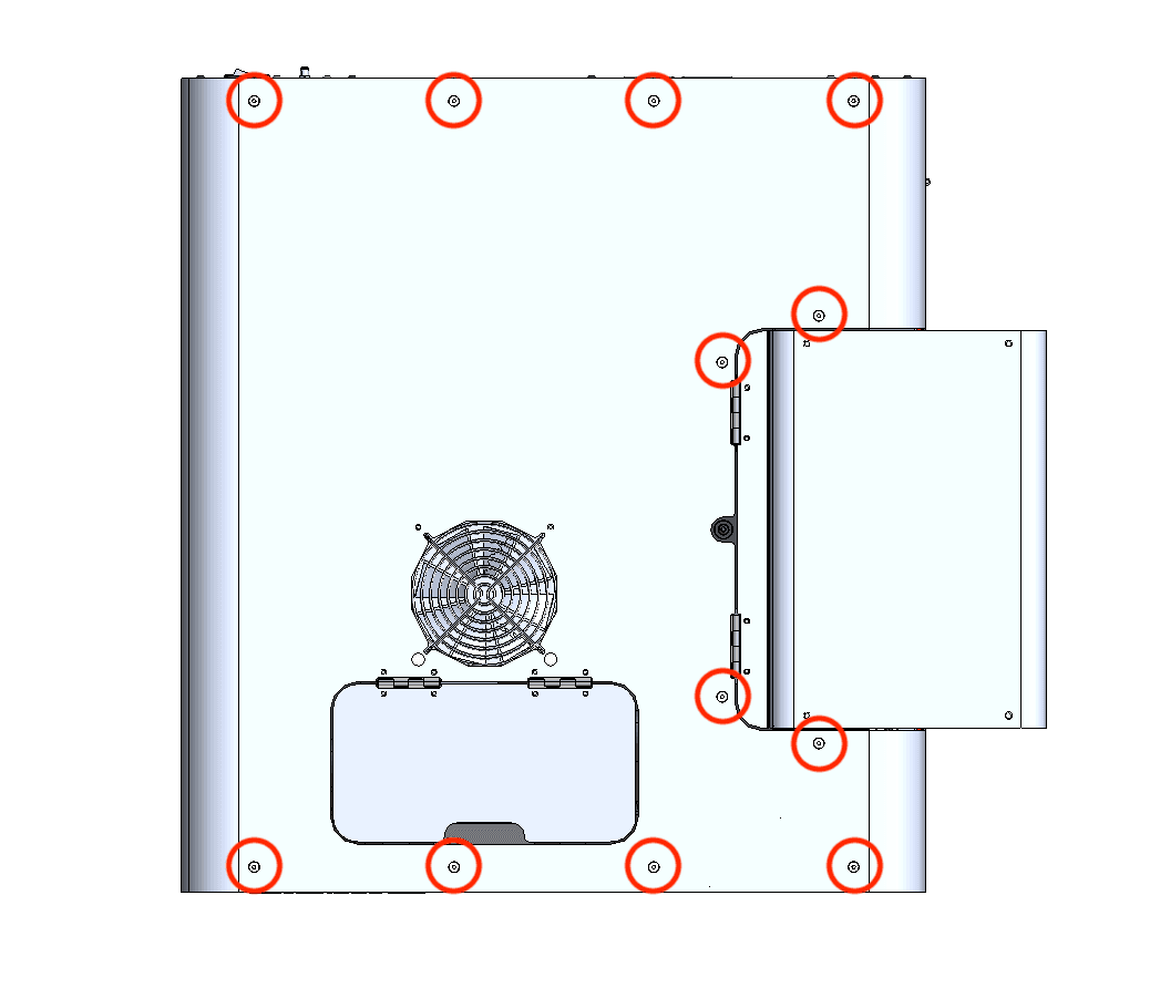

Step 1: Remove the top panel screws
Using a 2.5 mm hex driver, remove the 26 6 mm M4 countersunk screws securing the top panel to the printer:
Remove the top enclosure panel
  • Six 6 mm screws on the front end of the buffer-side
  • 12 6 mm screws on top of the printer
  • Eight 6 mm screws on the hopper-side
Set the screws aside.

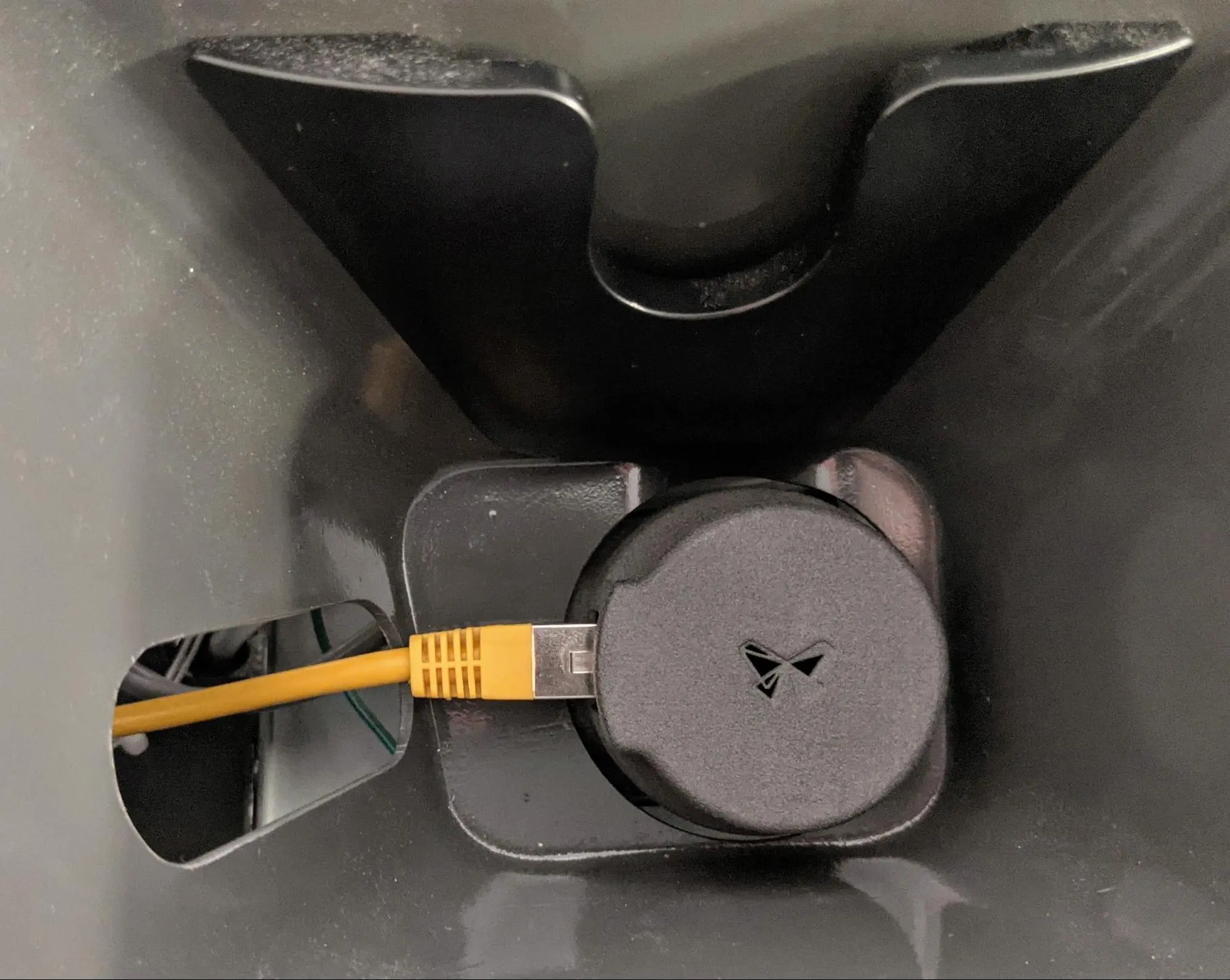

Step 1: Remove the IR sensor
Removing the IR sensor
Open the access door to the IR sensor panel, located on top of the printer next to the hopper. Lift the IR sensor and disconnect the cable from it. Set the IR sensor aside on a flat surface with the sensor window facing up. Feed the IR sensor’s cable down through the plastic shroud.

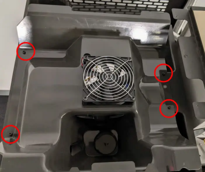

Step 2: Remove the upper cooling shroud screws
Using a 3 mm hex driver, loosen and remove the four 8 mm M4 socket head screws securing the upper cooling shroud to the printer. Do not yet separate the upper cooling shroud from the printer.

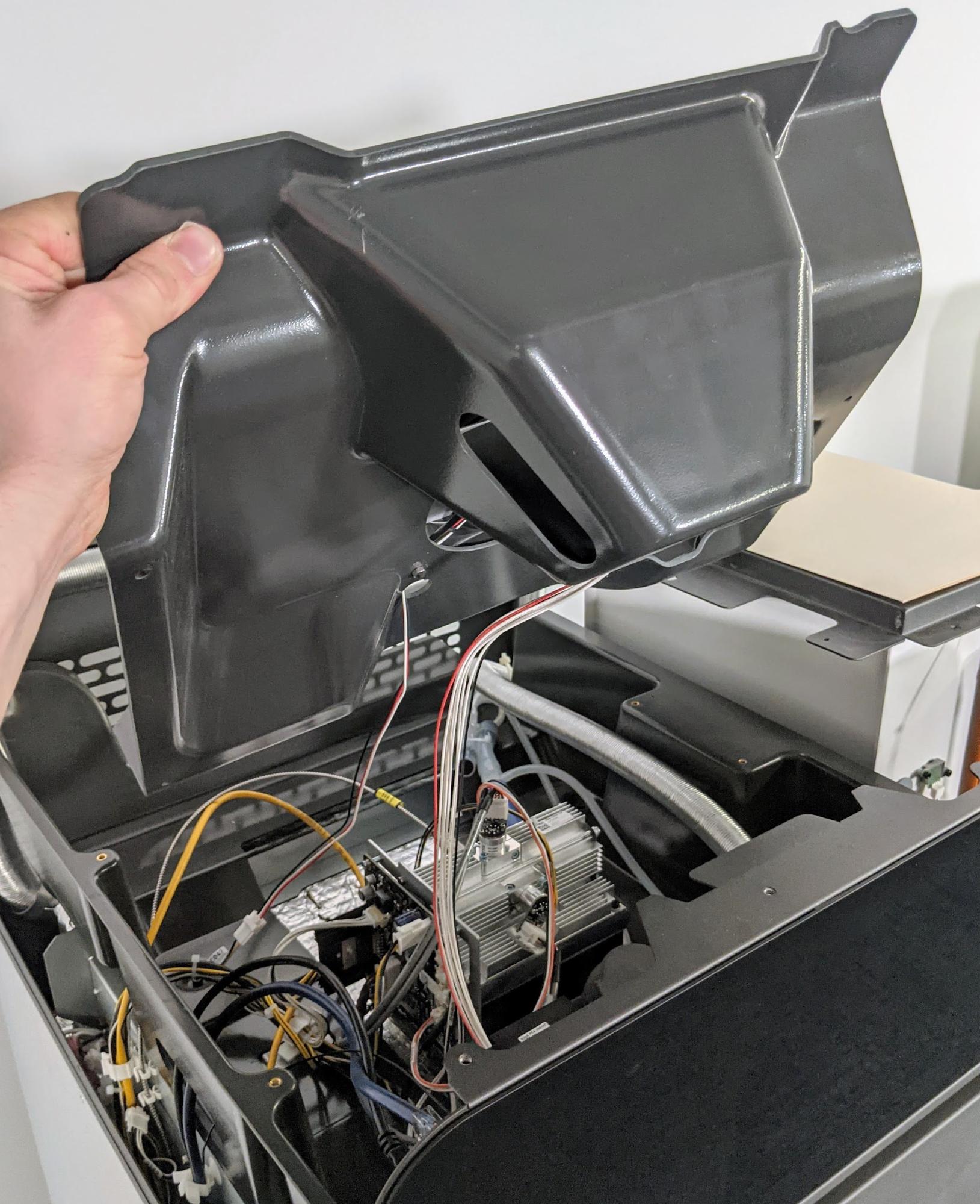

Step 3: Lift the upper cooling shroud
Gently lift up but do not separate the front edge of the plastic shroud from the top of the printer so that the cables attached to the shroud can be accessed.
Remove the top cooling shroud
Notice:
Take care when lifting the plastic shroud so as to not strain the cables attached to it.

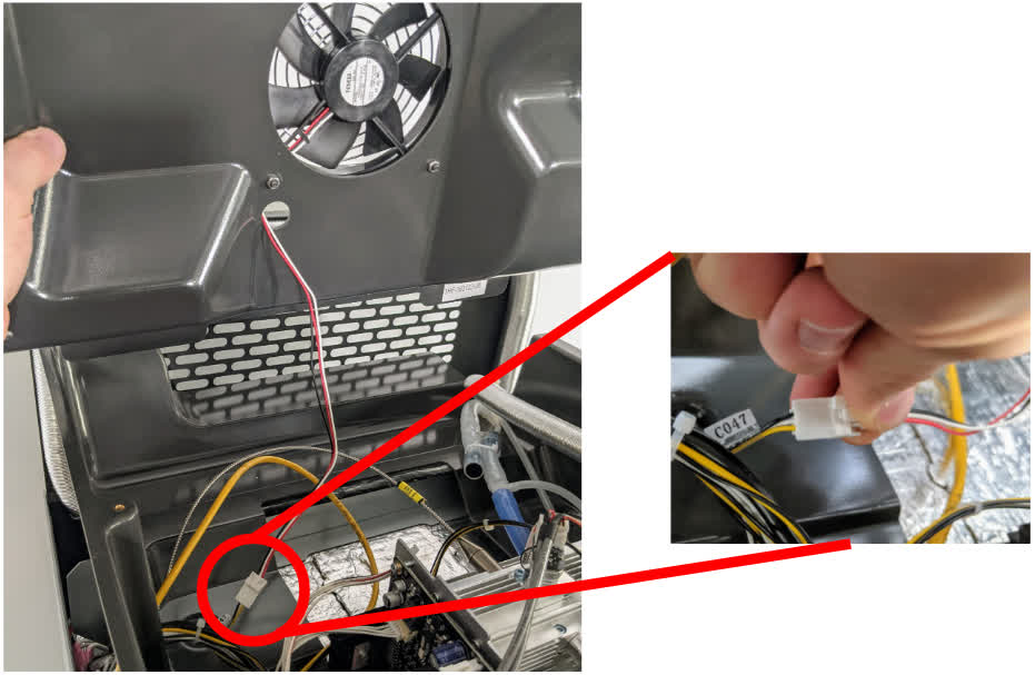

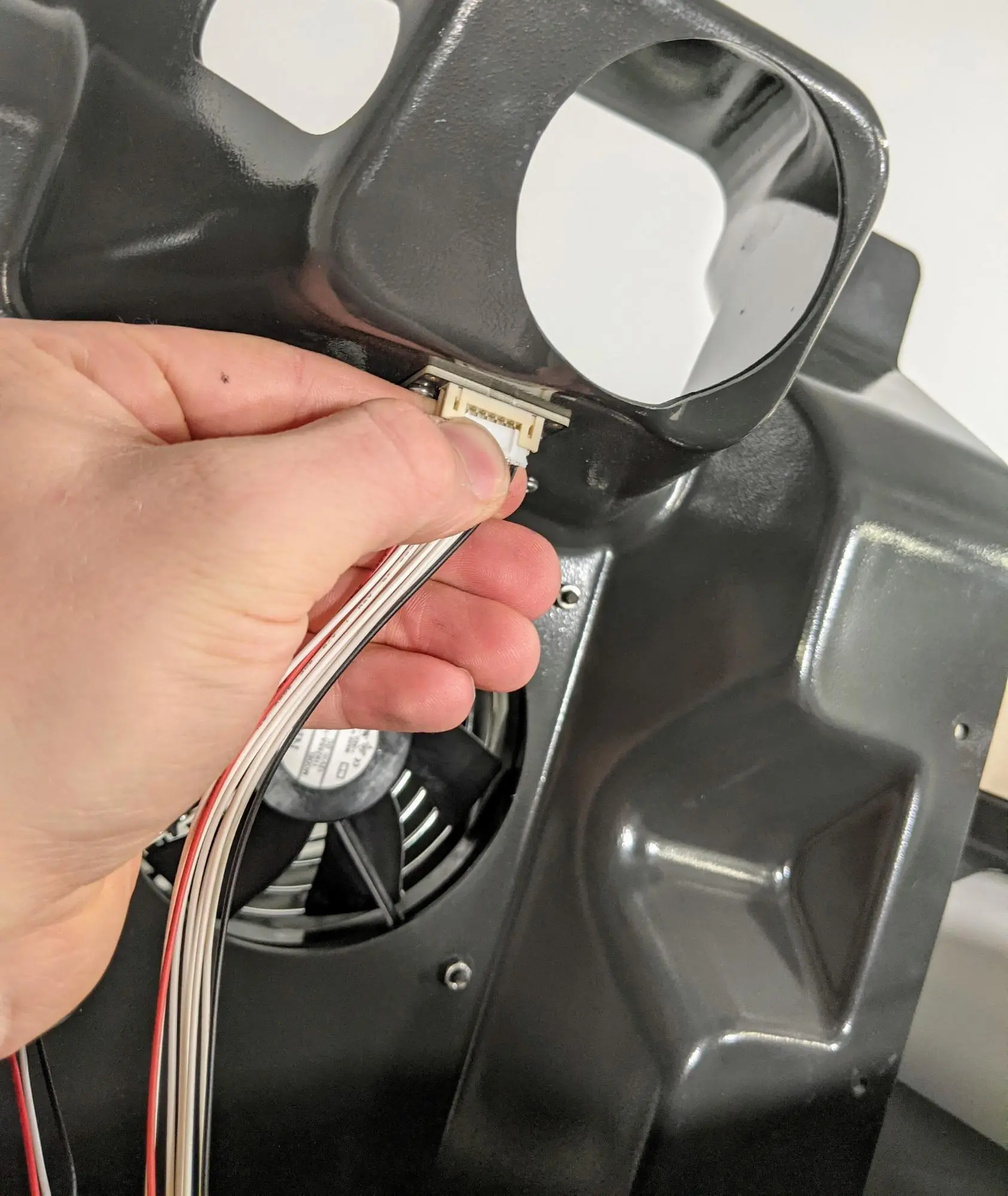

Step 4: Unplug the fan cable
Disconnect the fan cable from the connector labeled C047 by squeezing on the plastic latch. Do not pull on the individual wires; only pull on the plastic connector.
Tip:
It may be helpful to have one person hold the plastic shroud while another person unplugs the cables.

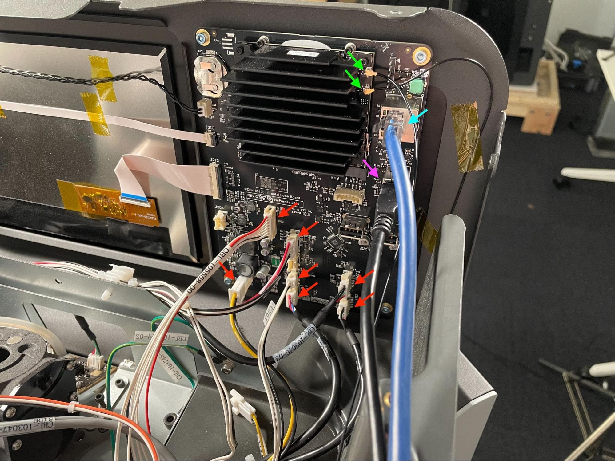

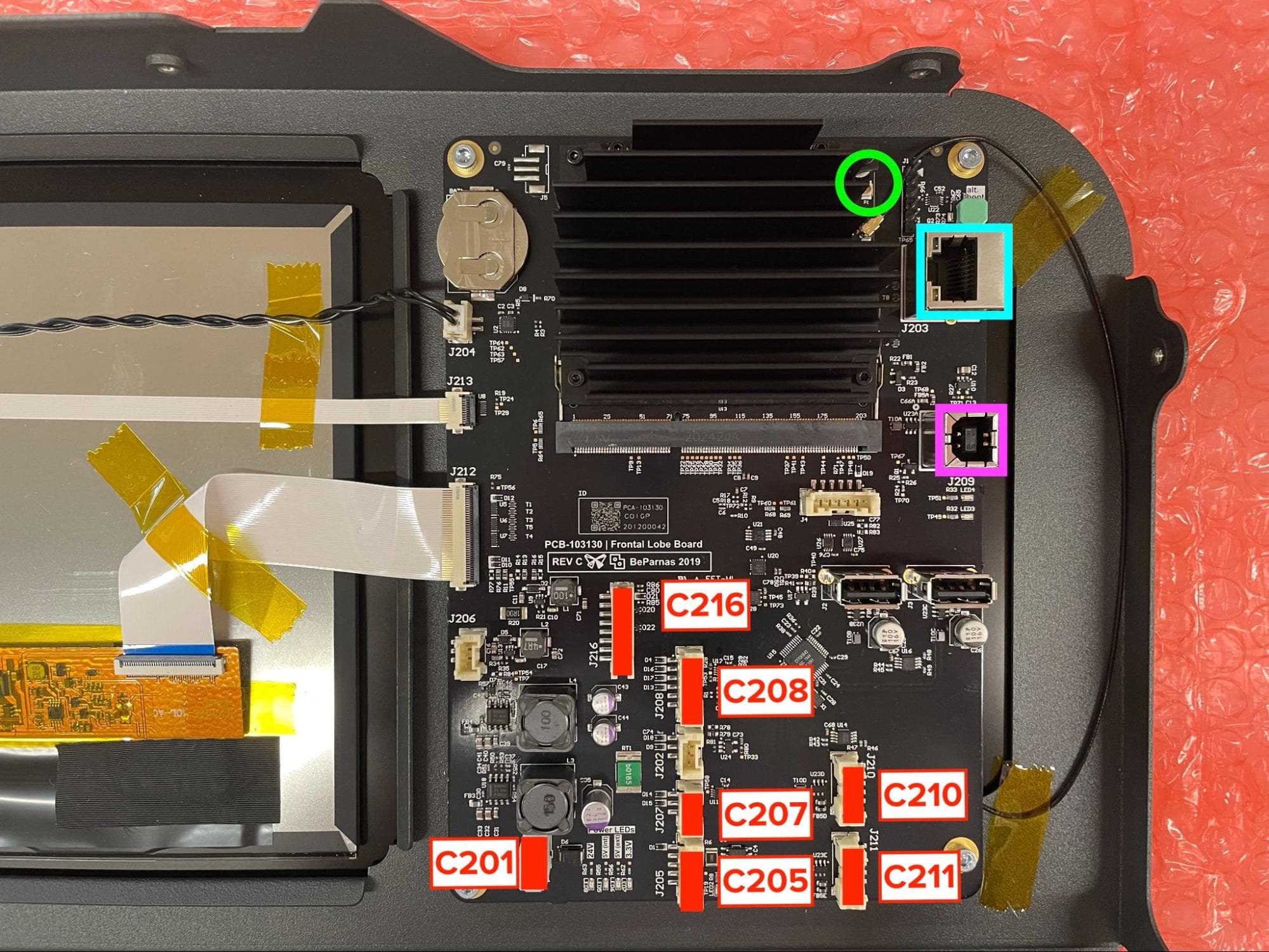

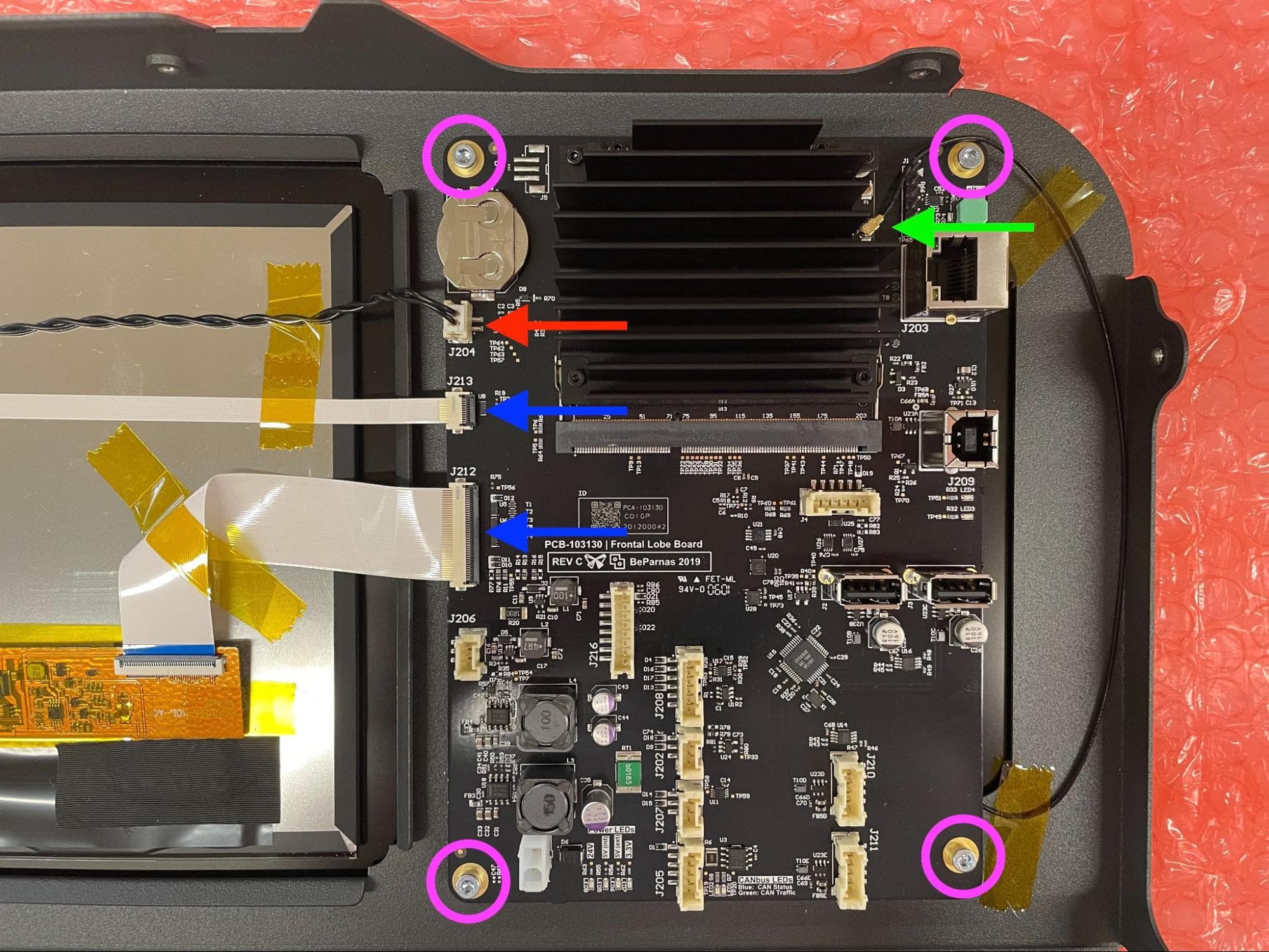

Locate the motherboard, also known as the frontal lobe board or FoLoBo, mounted behind the display assembly.
Step 2: Disconnect the cables from the motherboard
Begin disconnecting the USB, Ethernet, Wi-Fi, and JST connectors from the motherboard, as shown here. For cables that have a locking tab, make sure to disengage the locking tab first, then pull the connector away from the board via its plastic housing.
After disconnecting the RFID reader cable harness, set it aside. Leave all other cable harnesses inside the printer.

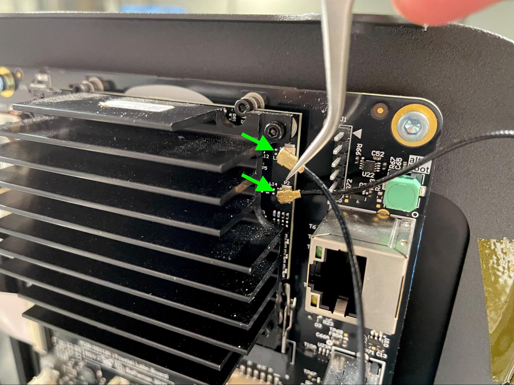

Use a pair of ESD-safe tweezers or a spudger to disconnect the Wi-Fi antenna cables. These connectors are extremely fragile and can easily bend or break if improperly handled. Older printers have two cables, while newer models have one.

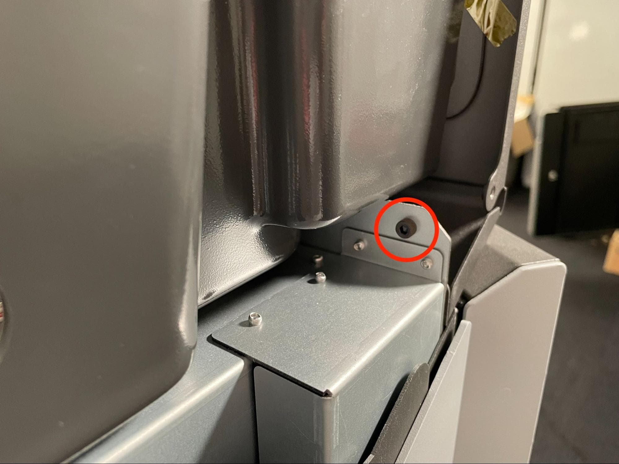

Step 4: Remove the display assembly mounting screws
Remove the original display assembly
Locate the display assembly mounting screws, positioned at the bottom corners of the display. Using a 3 mm hex driver, loosen and remove the two 6 mm M4 black socket head screws holding the display assembly to the top of the printer.
The entire display assembly will be free once these screws are removed. Hold the assembly with one hand when removing the second screw.

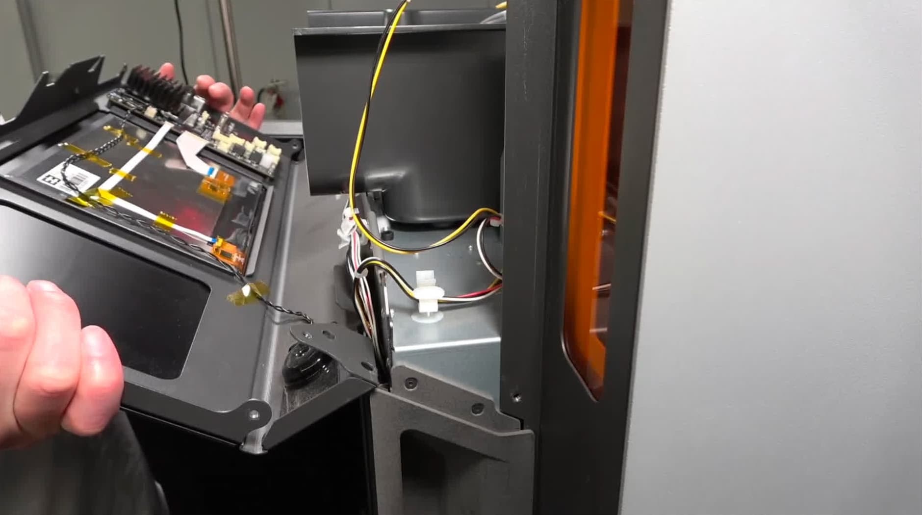

Step 5: Remove the display assembly
Carefully tip the display assembly forward and away from the printer. Make sure that you do not pinch or damage any of the wires around the display assembly, particularly the yellow, black, red and white cable harnesses just above the door handle.

Using a 2.5 mm hex driver, loosen and remove the four 8 mm M3 socket head screws securing the motherboard to the back of the display assembly. Set the screws aside. Carefully separate the motherboard from the display assembly and set it aside onto a flat, clean, anti-static surface.

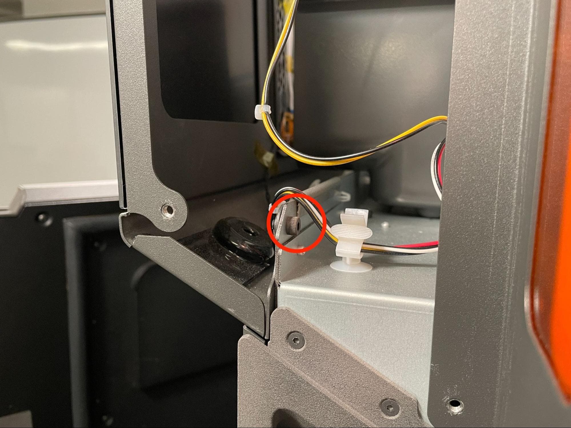

Step 5: Mount the display assembly
Pivot the display assembly back towards the top of the printer so the display’s flange tabs are flush with the corresponding flanges on the frame.
Thread one M4 socket head screw into both of the two screw holes in the bottom corners of the display assembly. Do not fully tighten.

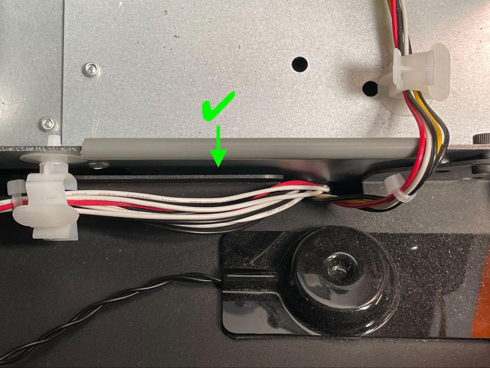

Step 6: Check the display assembly position
Install the new display assembly

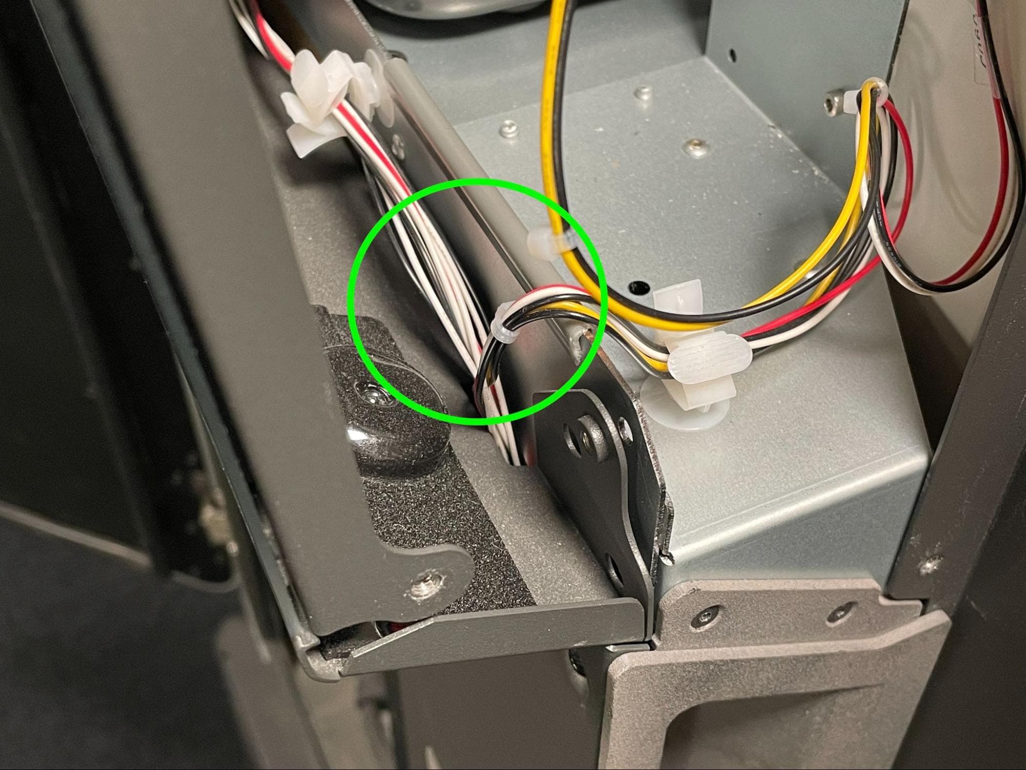

Check that none of the harnesses above the door handle are caught between the display assembly and printer’s frame.

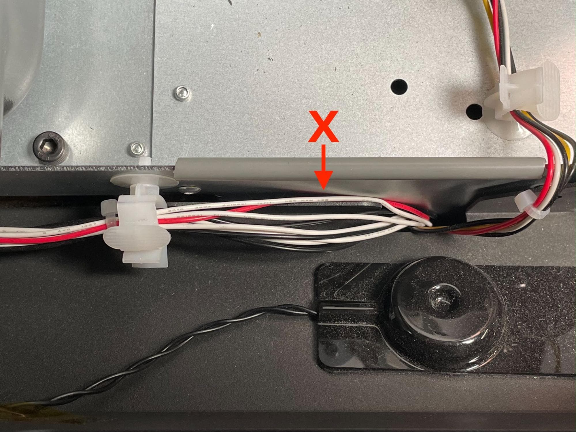

Step 3: Route the IR sensor cable
Position the top cooling shroud by holding it from the front edge so that the cables covered by the shroud can still be accessed. Feed the IR sensor’s Ethernet cable back through the cutout in the top shroud.

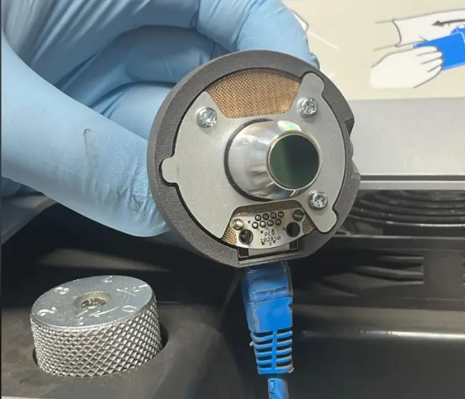

Step 5: Connect and mount the IR sensor
Inspect the IR sensor lens for debris and clean it if necessary. Attach the ethernet cable to the IR sensor, then place the sensor back into its mount.
