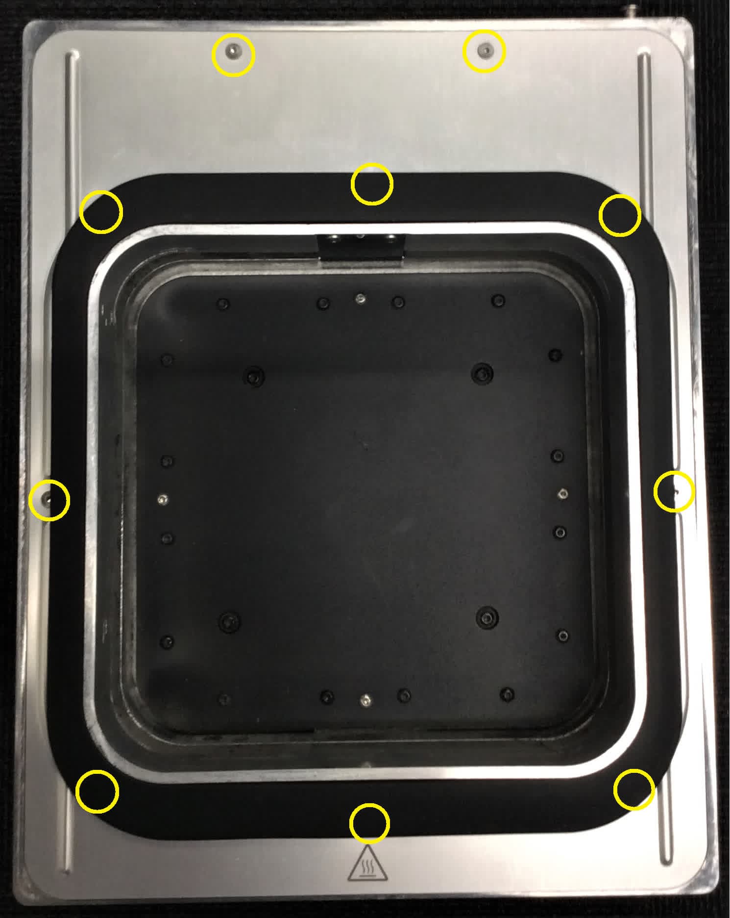

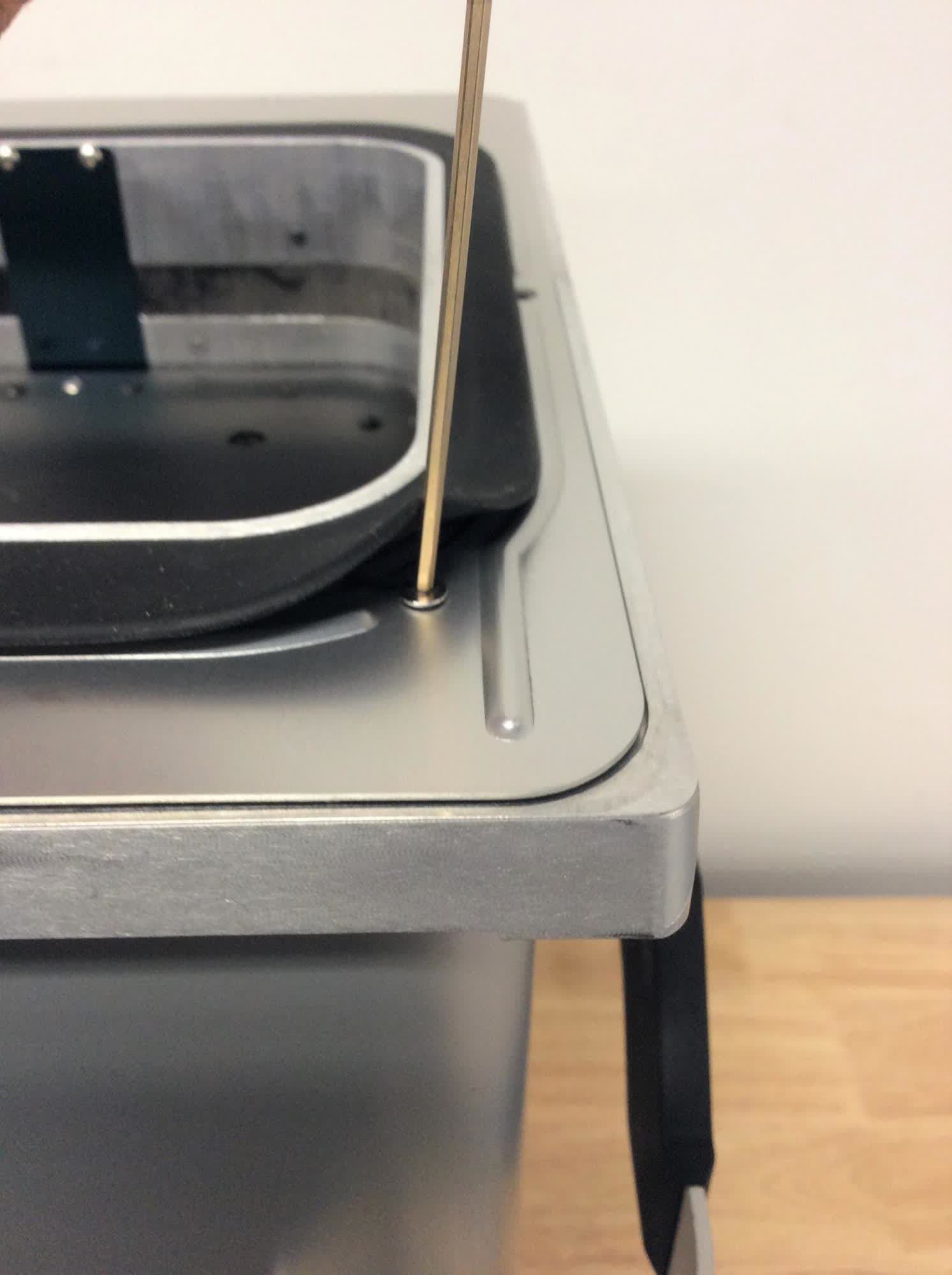

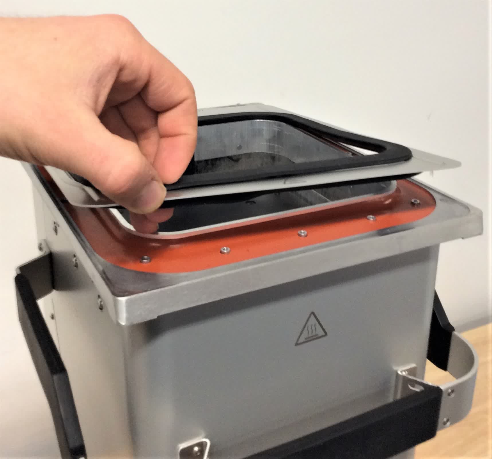

Using a 2 mm hex driver, loosen and remove the 10 M3 × 5 mm screws securing the build chamber’s top cover to the build chamber’s body. Set the screws aside.

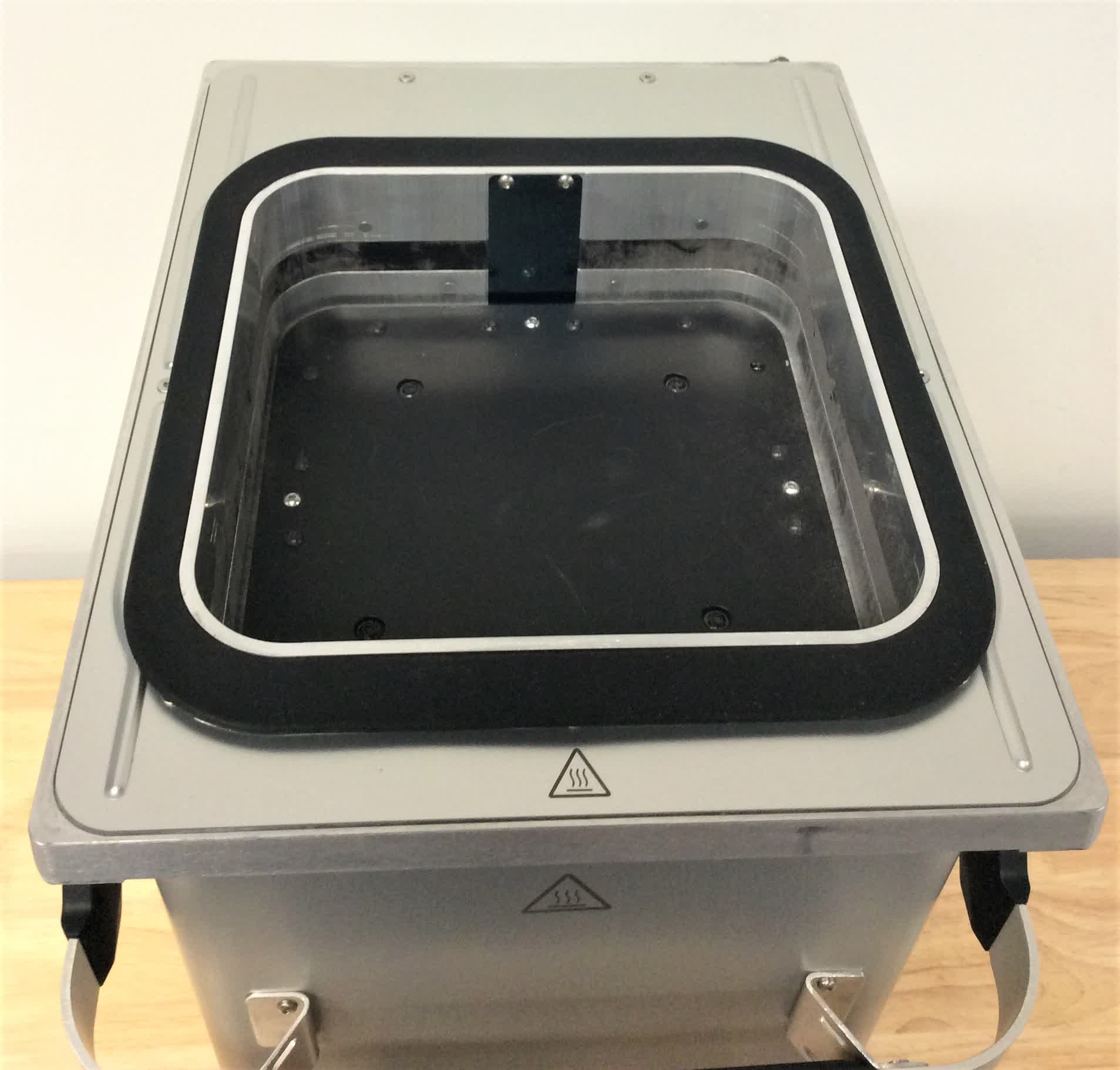

Remove the top cover and build chamber external frame gasket from the build chamber.

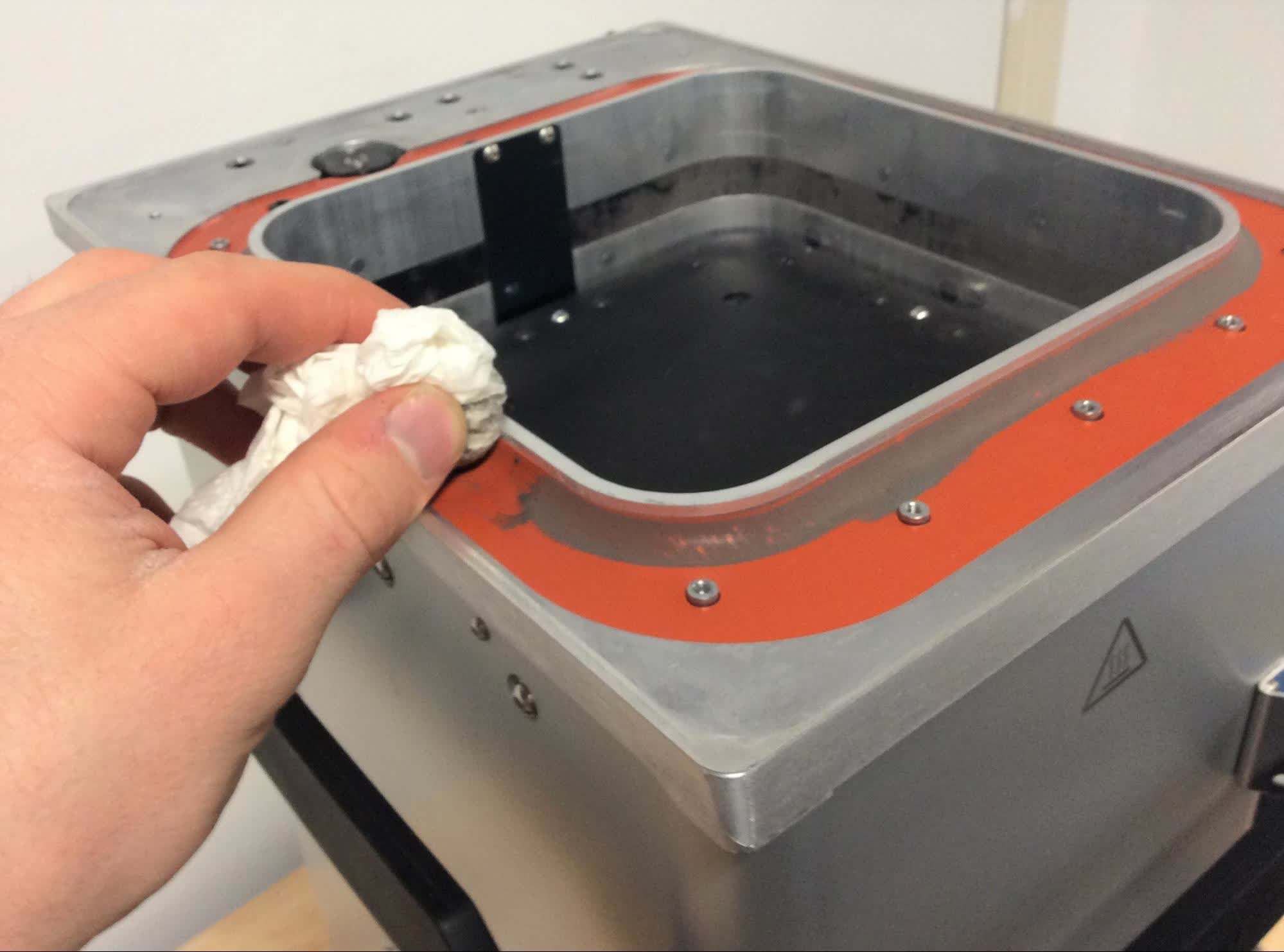

Use a clean paper towel to clean any powder off of the orange seal below the top cover.

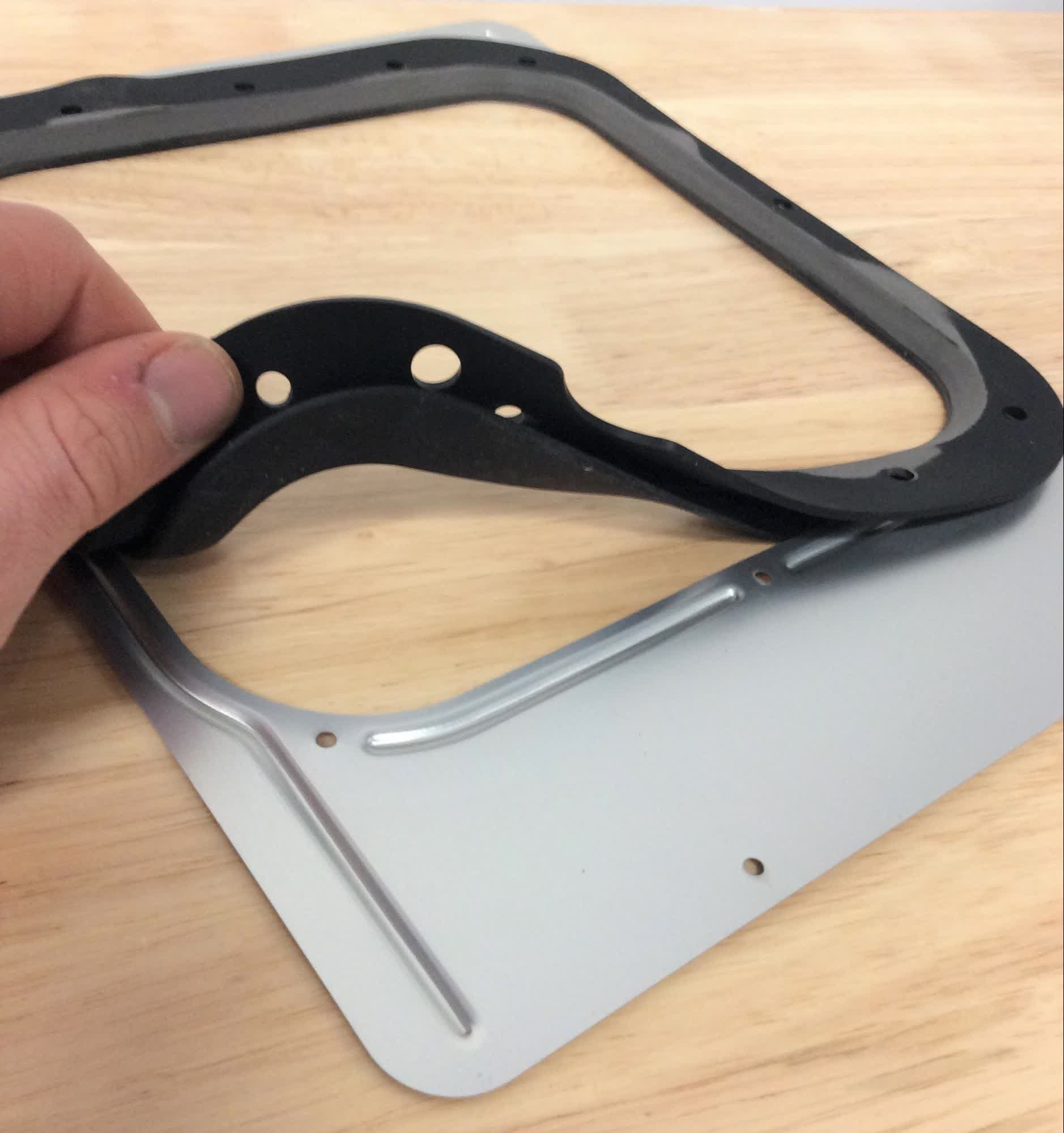

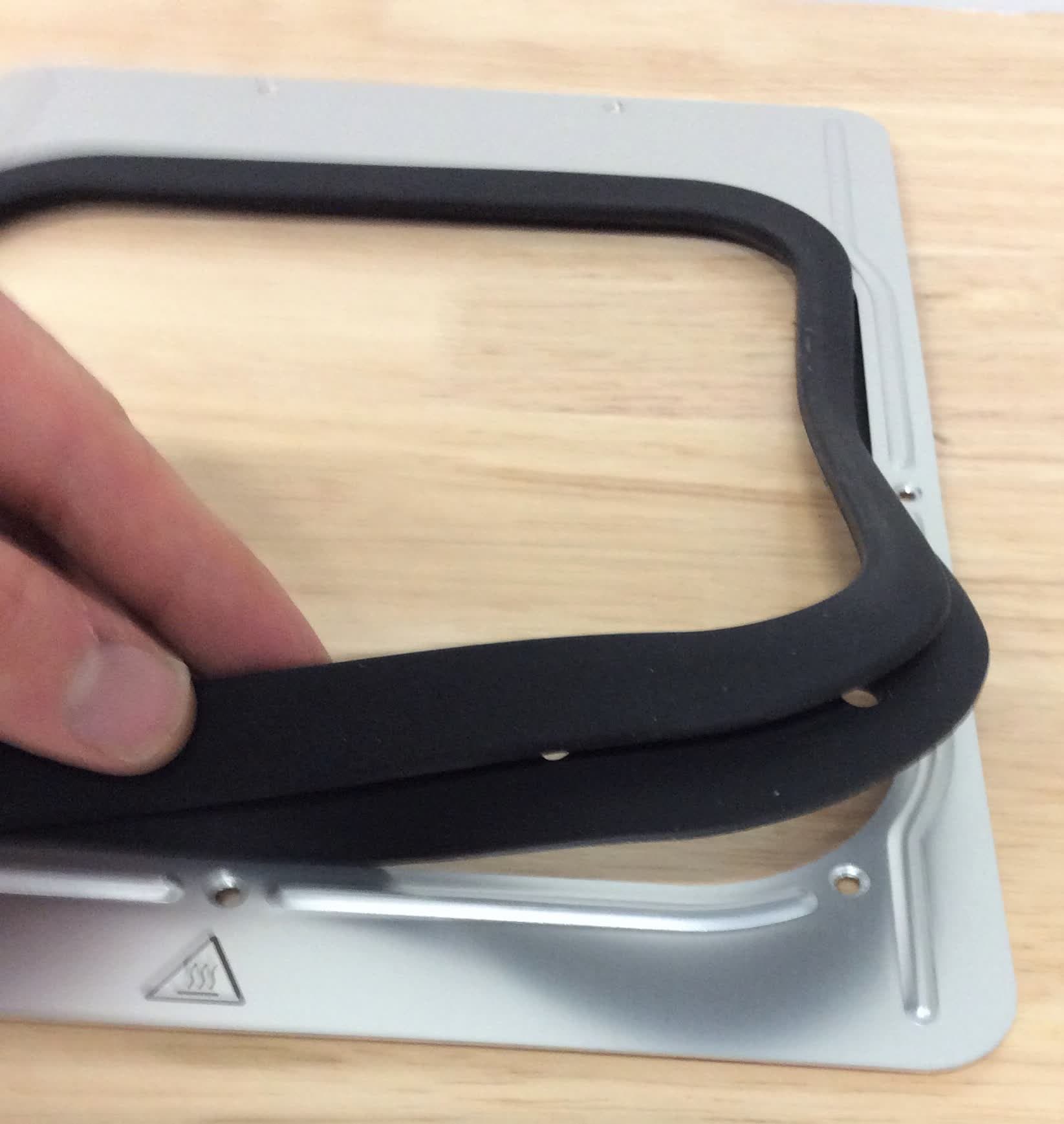

Place the top cover face-down. Peel the build chamber external frame away from the top cover.

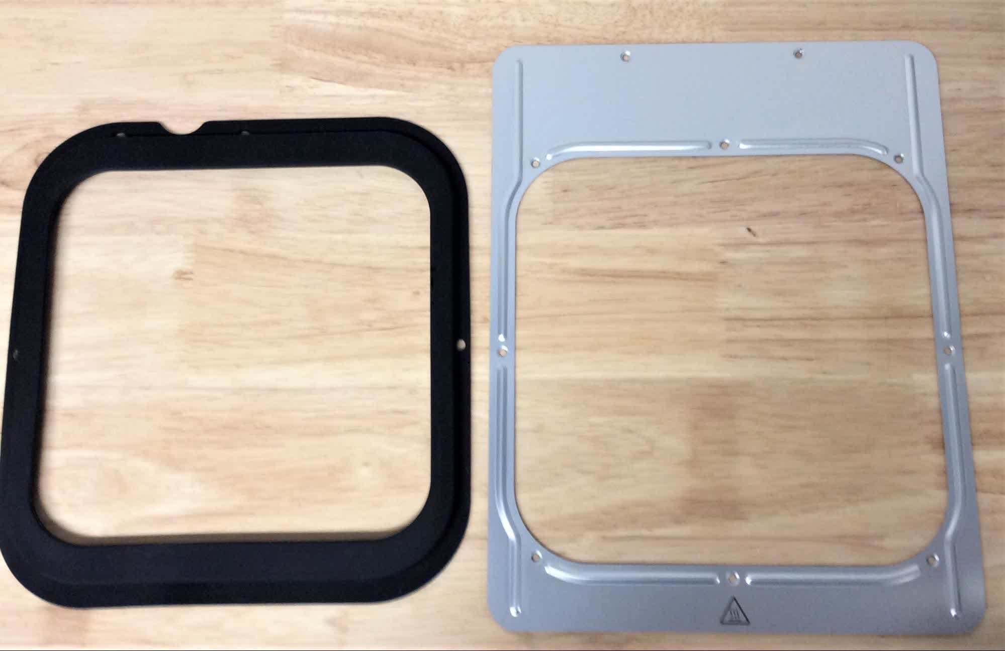

Step 1: Orient the top cover and external frame gasket
Place the top cover face-up, so that the hot surface hazard symbol is visible and facing you. The build chamber external frame gasket has two flanges that sandwich the inner lip of the top cover; position the gasket with the wider flange on the bottom. Orient the new build chamber external frame gasket with the notch facing the back of the top cover (i.e., away from the hot surface hazard symbol).
Tuck the wider flange of the build chamber external frame gasket under the inner lip of the top cover. Leave the narrower flange on top of the top cover such that the build chamber external frame gasket sandwiches the inner lip of the top cover. Turn the top cover over and check that the screw holes in the gasket are aligned with the screw holes in the top cover.
Position the top cover and build chamber external frame gasket on top of the build chamber. Ensure that the screw holes in the build chamber external frame gasket are aligned with the holes in the top cover and the standoffs on the top surface of the build chamber and that the gasket is not being pinched. Adjust the assembly as needed. Once all of the screw holes are properly aligned, thread one screw into each of the 10 screw holes. Tighten the screws with a 2 mm hex driver until finger tight.
