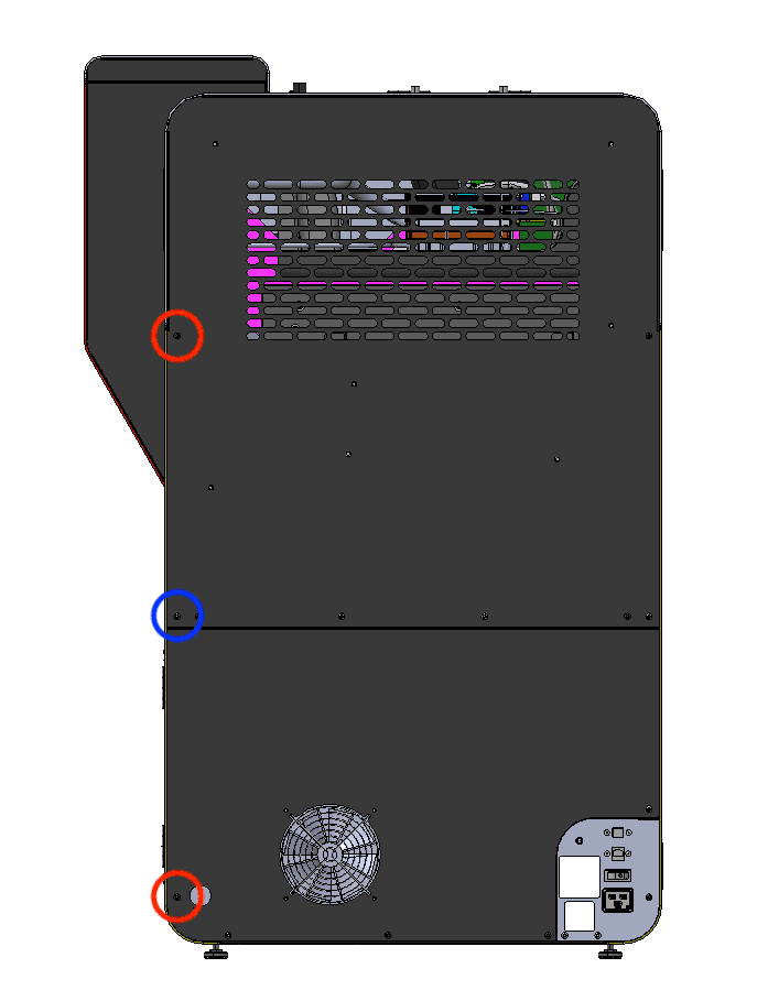

Using a 2.5 mm hex driver, loosen and remove the two black (circled in red) and one chrome (circled in blue) 8.0 mm M4 button head screws from the back-left of the printer. Take note of the locations of these screws, as the placement of the chrome screws is critical to the printer's electrical grounding. Set the screws aside.

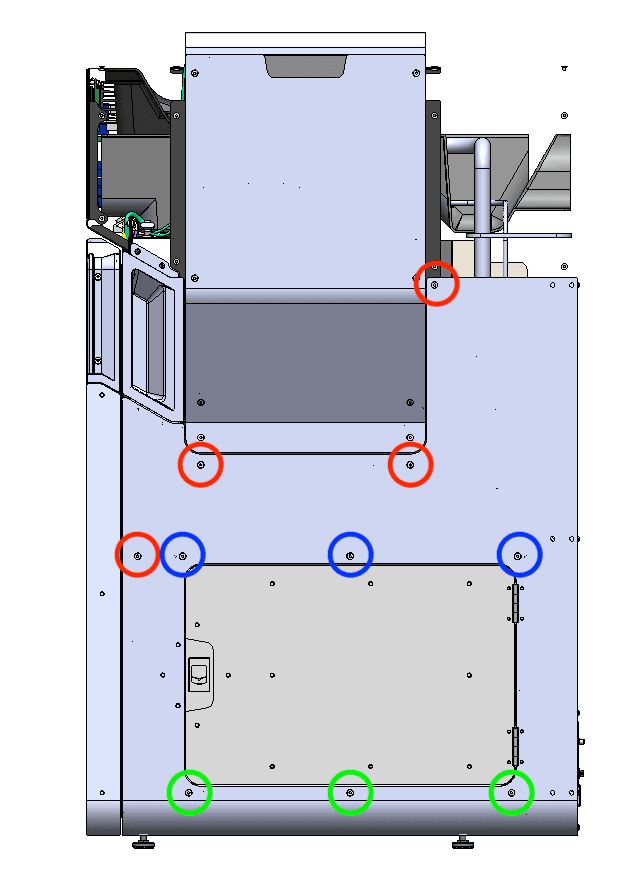

Move to the hopper side of the printer. Using a 2.5 mm hex driver, loosen and remove the 10 M4 countersunk screws holding the hopper-side panel to the printer. Remove the top-most 6.0 mm countersunk screws last to make removing the panel easier. Set the screws aside.
  • Three 16.0 mm screws, circled in green
  • Three 12.0 mm screws, circled in blue
  • Four 6.0 mm screws, circled in red

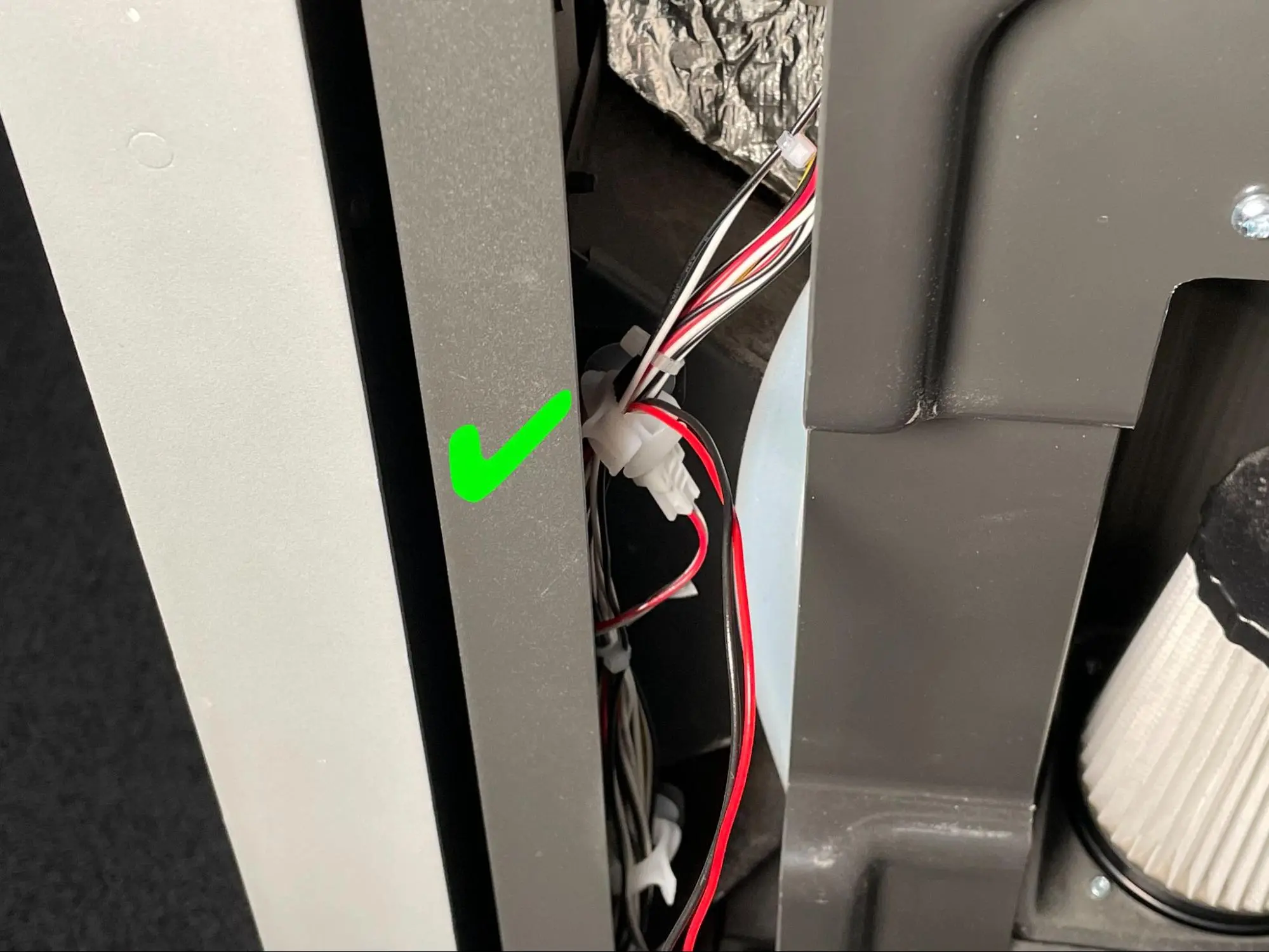

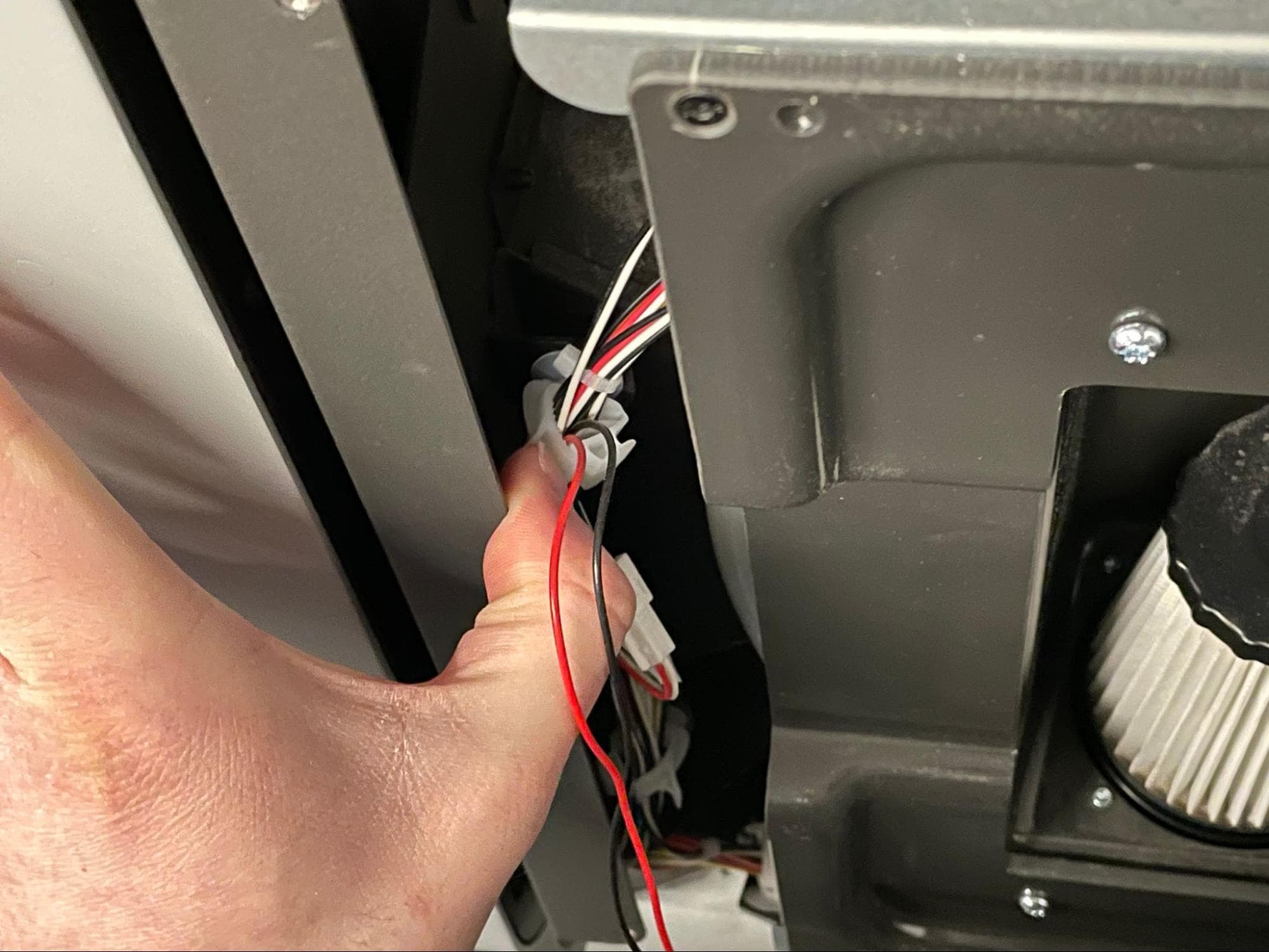

Locate the black and red cables leading to the interlock switch on the inner left-hand side of the panel. The cables are retained by a cable clamp. Unlock the cable clamp and disconnect the cable labeled C033.
Separate the hopper-side panel from the printer, taking care to ensure that none of the cables are caught or tangled. Set the panel down on a flat, clean surface.

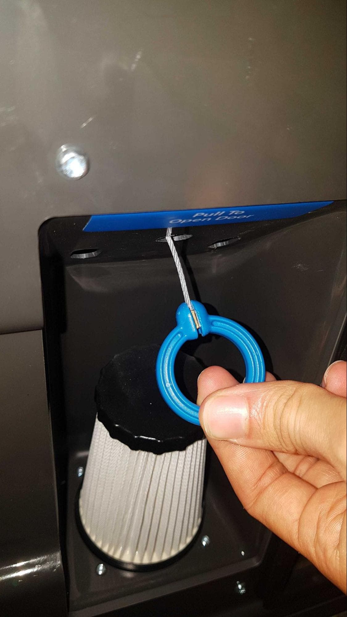

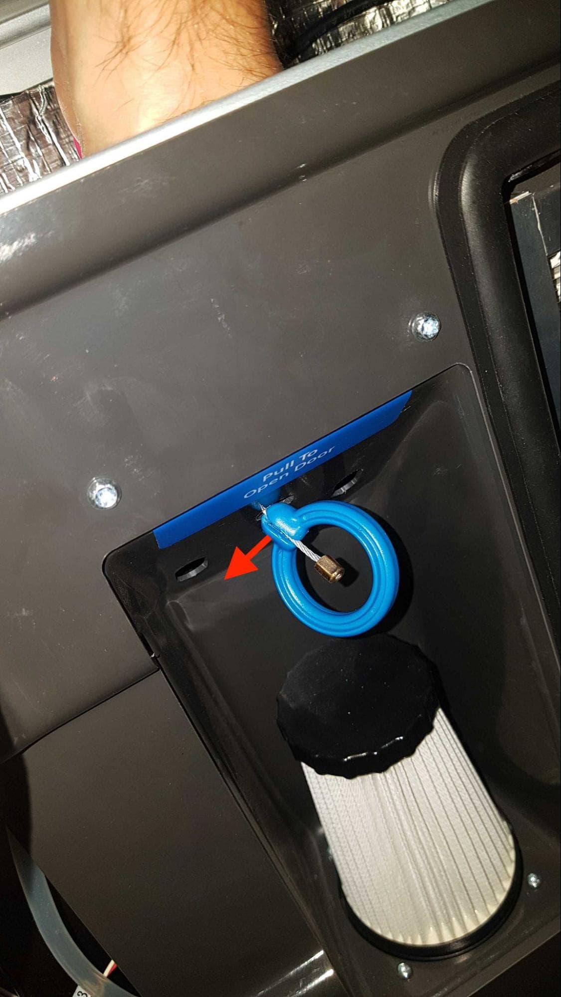

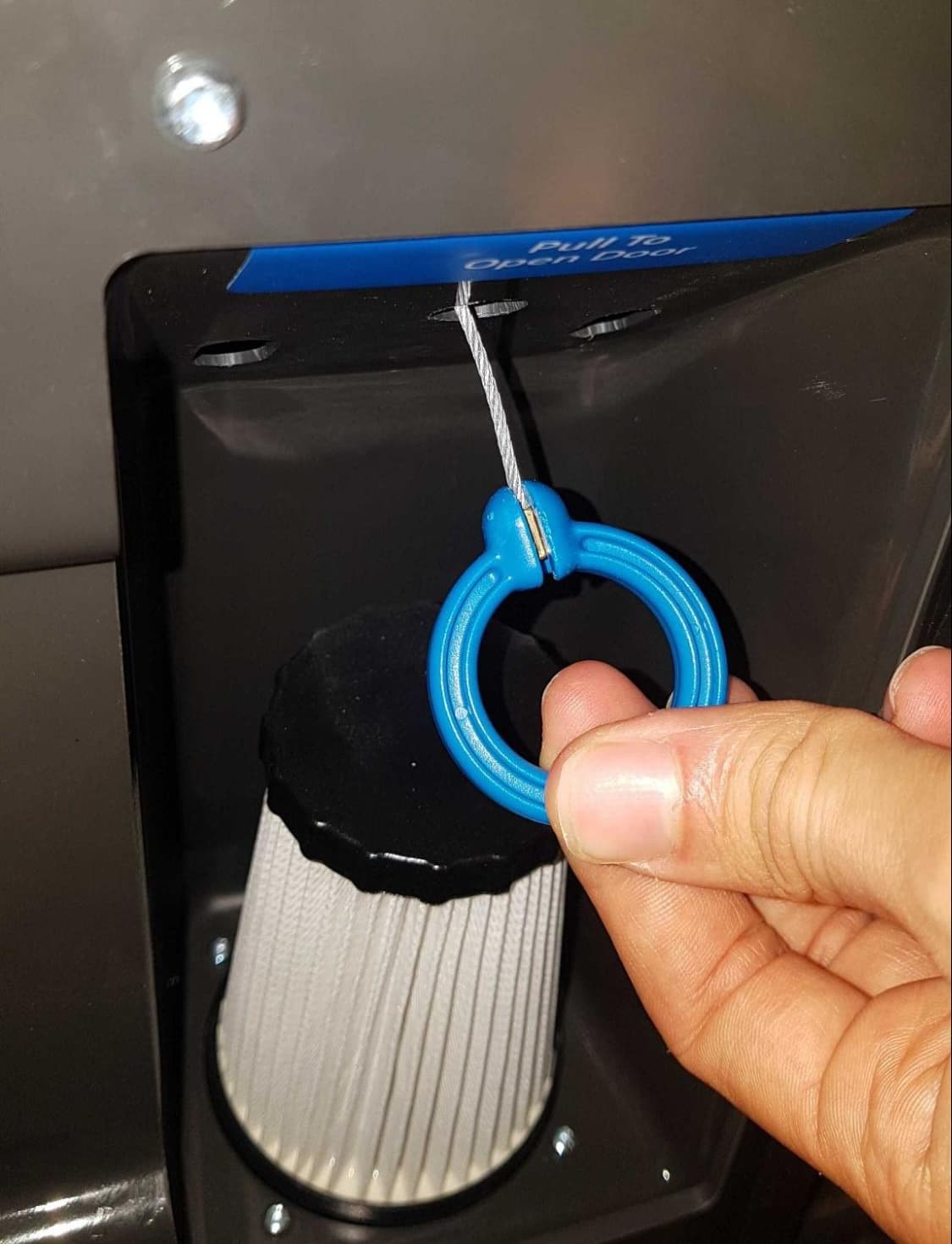

Step 5: Open the print enclosure door
Open the print enclosure door by pulling the manual release handle in the filter cabinet.
Step 6: Remove the manual release handle
Remove the build chamber socket & cable harness
Pull the cable through the manual release handle to expose the ferrule, then slide the cable out of the handle. Set the manual release handle aside.

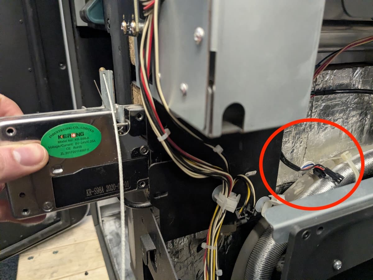

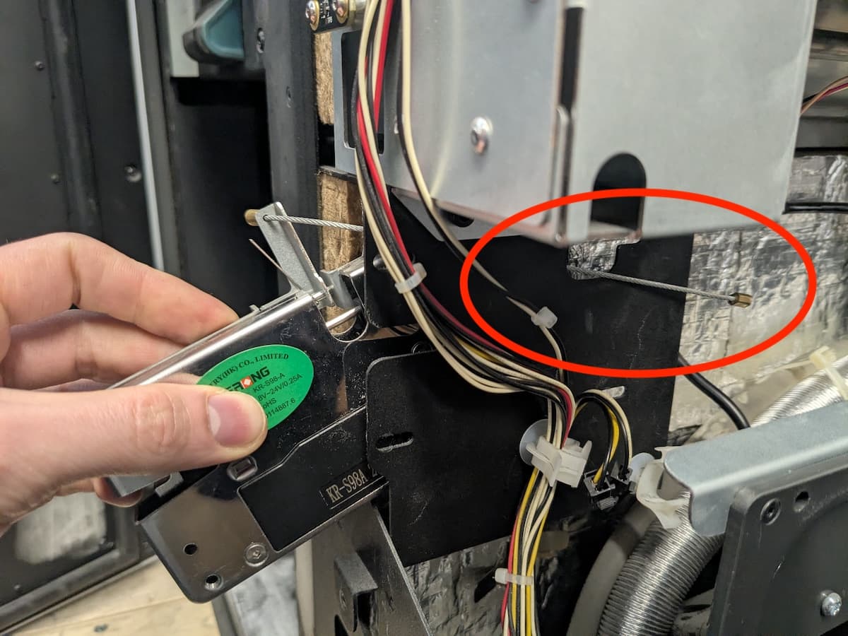

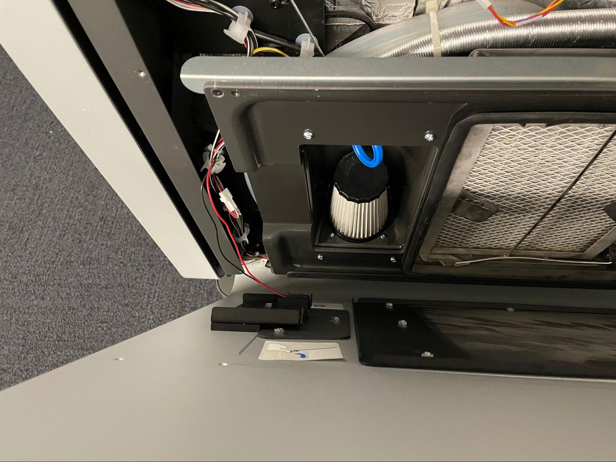

Step 1: Locate the door latch assembly
Locate the door latch assembly, positioned behind the filter cabinet.

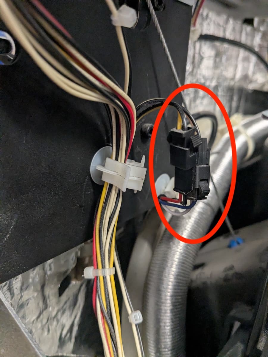

Step 2: Disconnect the door latch cable
The door latch cable terminates in two connectors, visible next to the latch assembly. For both, squeeze the locking tab, then separate the connectors. Do not pull on the wires themselves.
Door latch cables

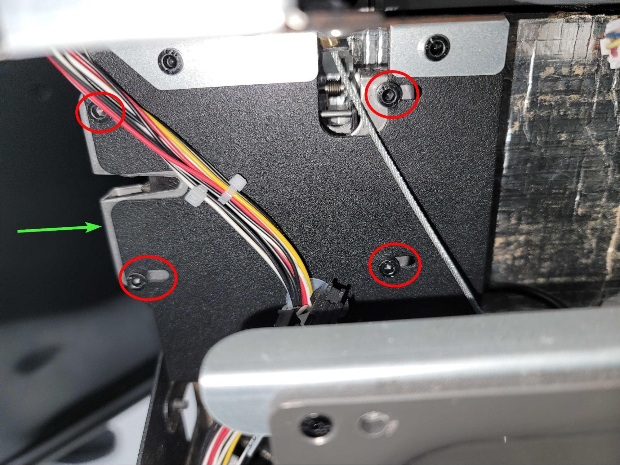

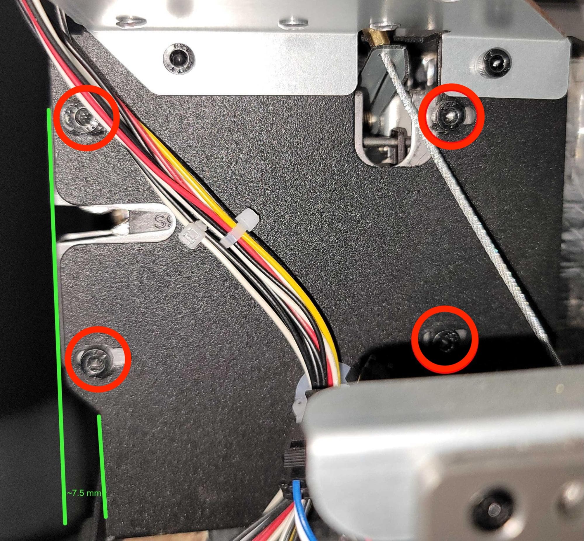

Step 3: Unscrew the door latch mounting screws
Using a 3 mm ball-end hex driver or key, loosen and remove the four 5 mm button head screws holding the door latch in place. Set the screws aside.

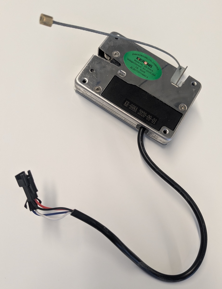

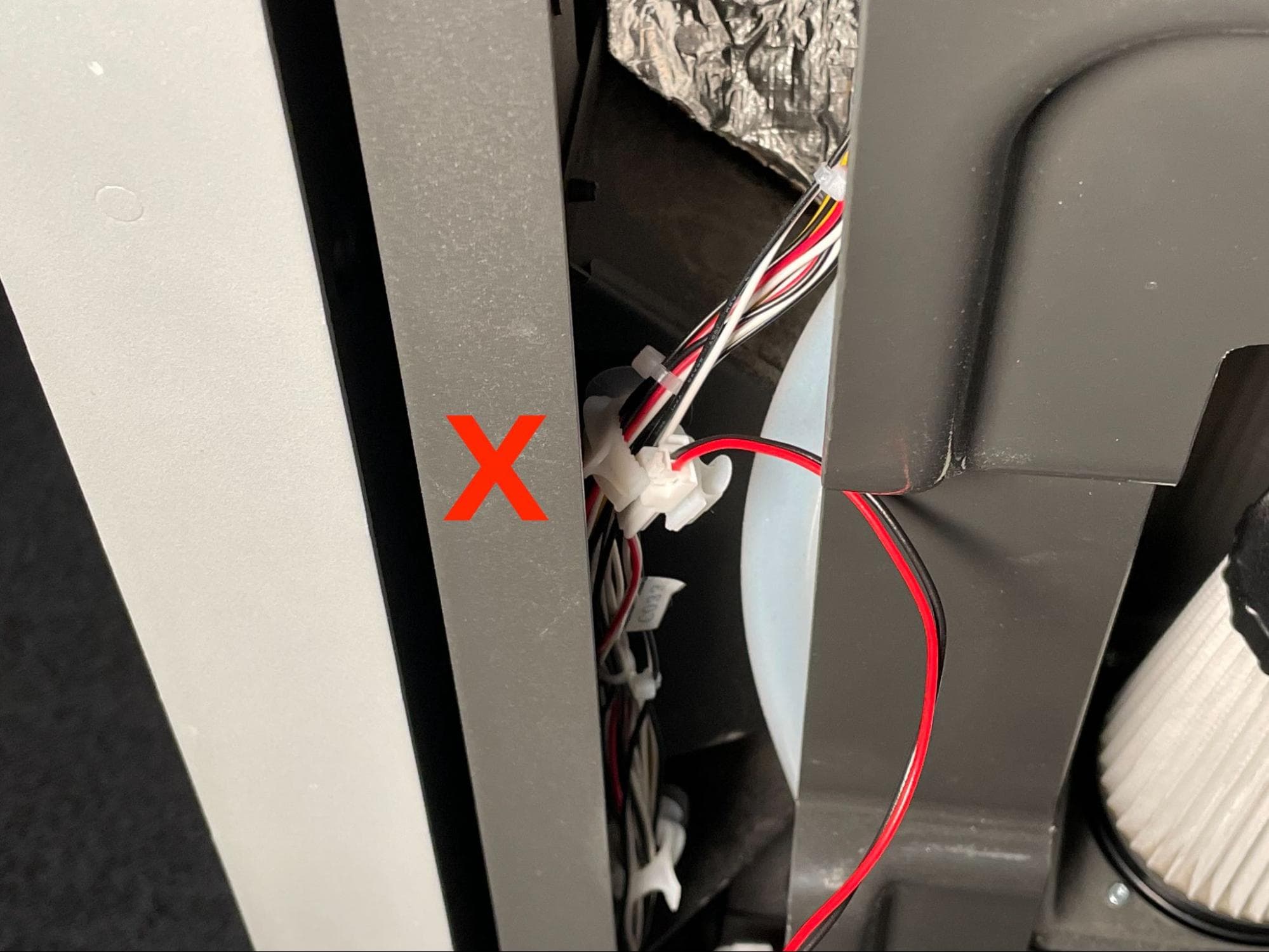

Step 4: Remove the door latch
Slide the latch assembly forward and remove it from the printer. Take care that the door latch cable and the manual release cable do not catch on any of the nearby printer components. Set the latch assembly aside for disposal with electronic waste.

Slide the new door latch assembly into place. Feed the black cable through to the back of the mounting plate. Feed the manual release cable through the slot at the top of the mounting plate.
Step 2: Align and secure the latch assembly
Align the front of the latch assembly with the front of the mounting plate. Thread one 5 mm M4 screw into each of the four screw holes in the latch. Using a 3 mm ball-end hex driver or key, tighten until snug.

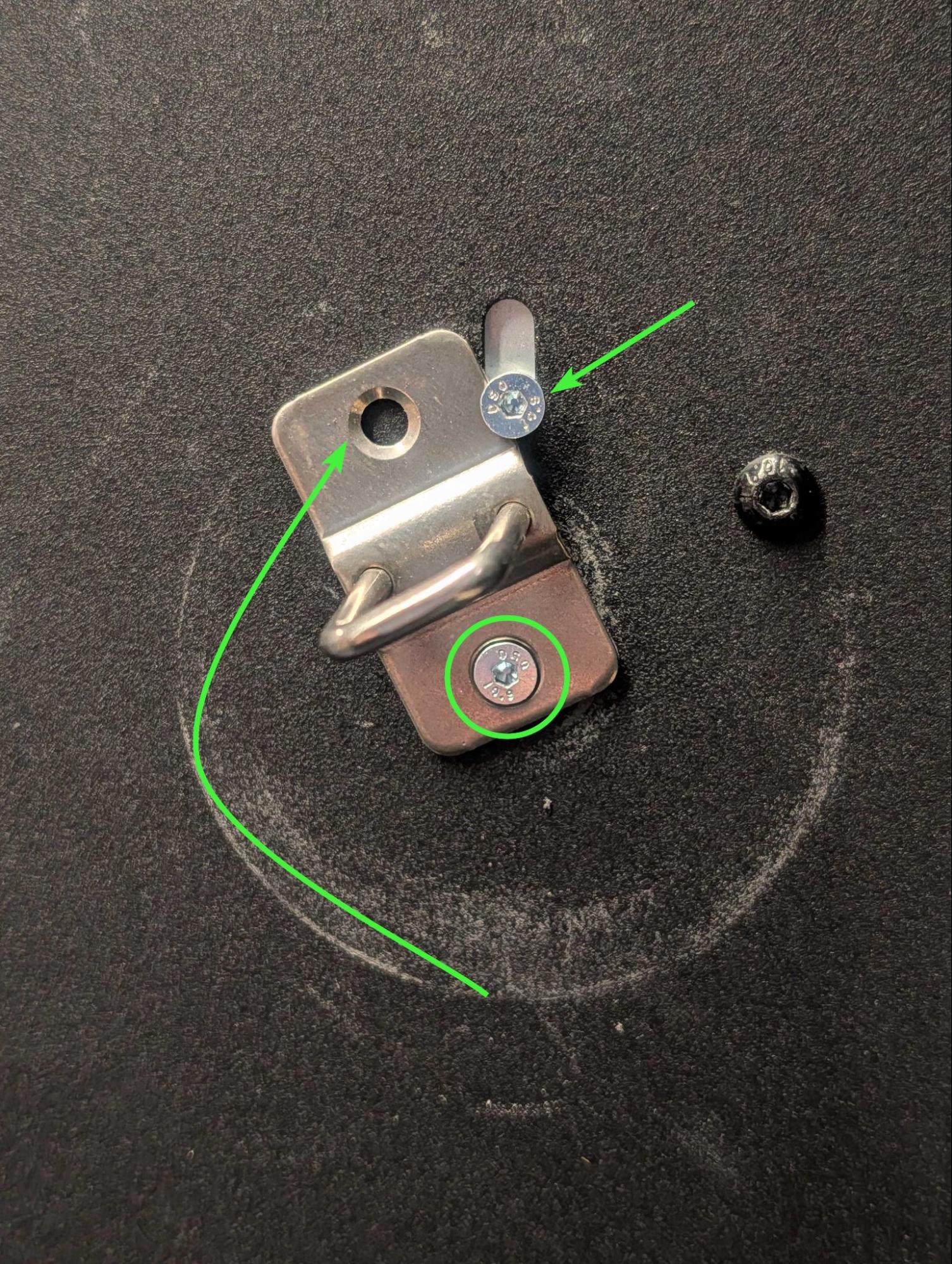

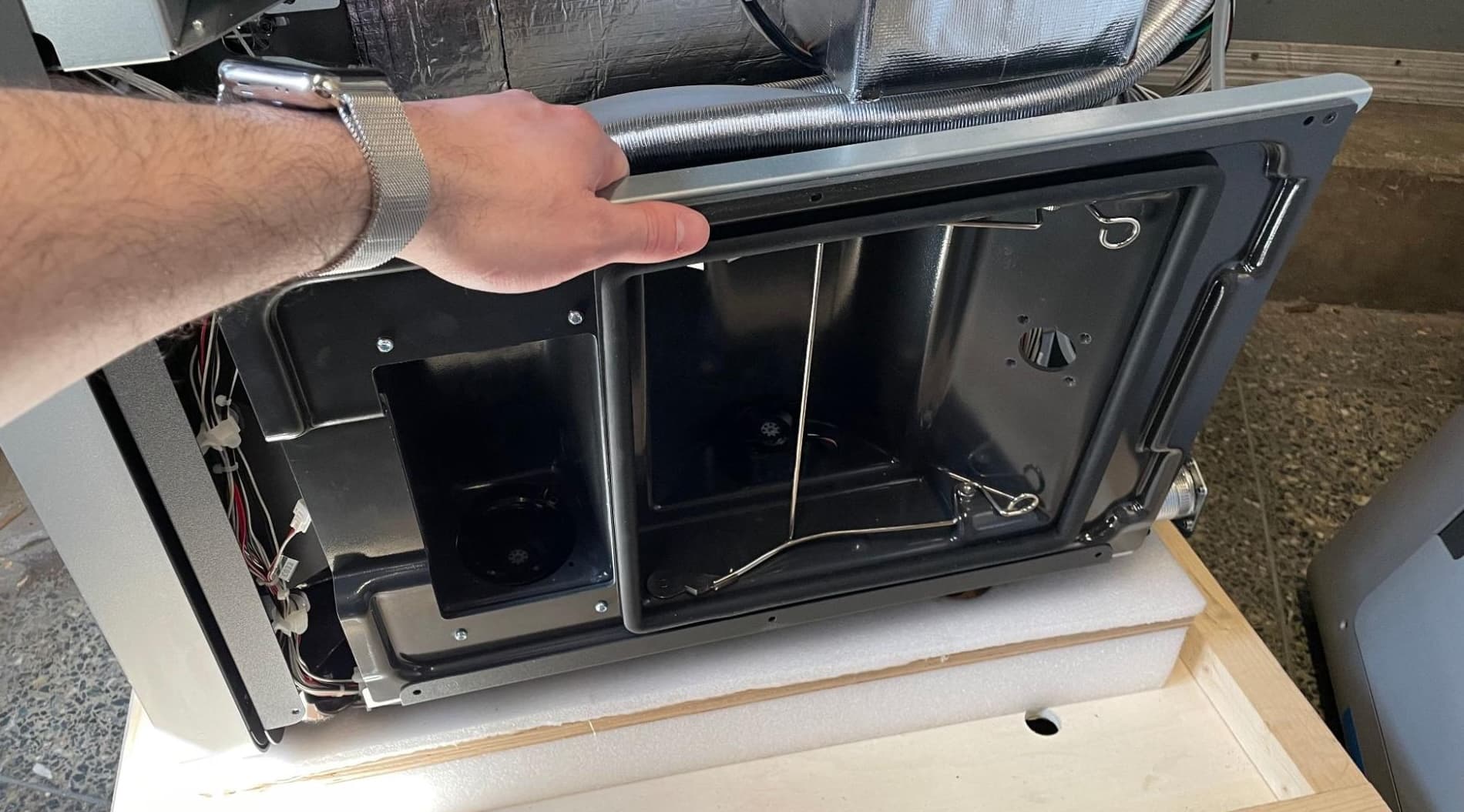

Replacing the latch striker
Overview: Replace the original latch striker. Start installing the new striker while removing the original one to avoid dropping the striker backplate into the door.
Step 1: Remove the lower latch striker mounting screw
If the print enclosure door is not currently open, pull on the latch's manual release cable to open it. Locate the latch striker on the inside face of the door.
Using a 2 mm hex driver, loosen and remove the lower 8 mm flat head screw securing the striker to the door. Do not remove the upper screw at this time. Removing both screws will cause the striker backplate to drop into the door.

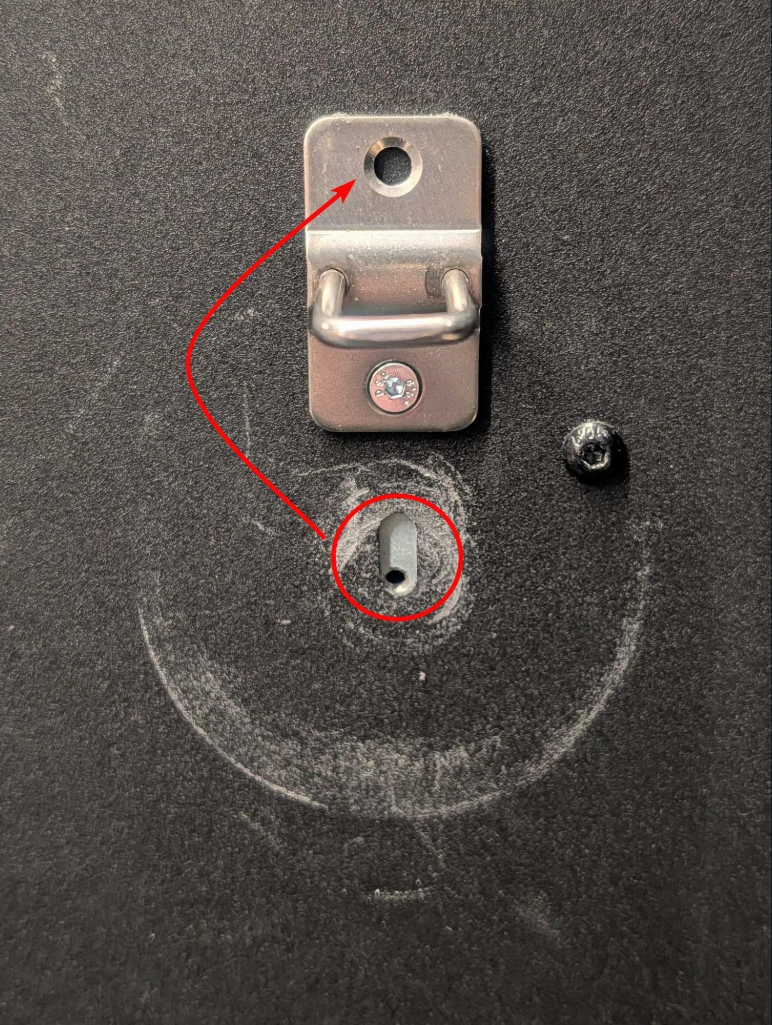

Step 2: Loosen the upper latch striker mounting screw
Using a 2 mm hex driver, loosen but do not remove the upper 8 mm flat head screw. Twist the striker plate upwards to expose the lower screw hole.
Replace the Latch Striker

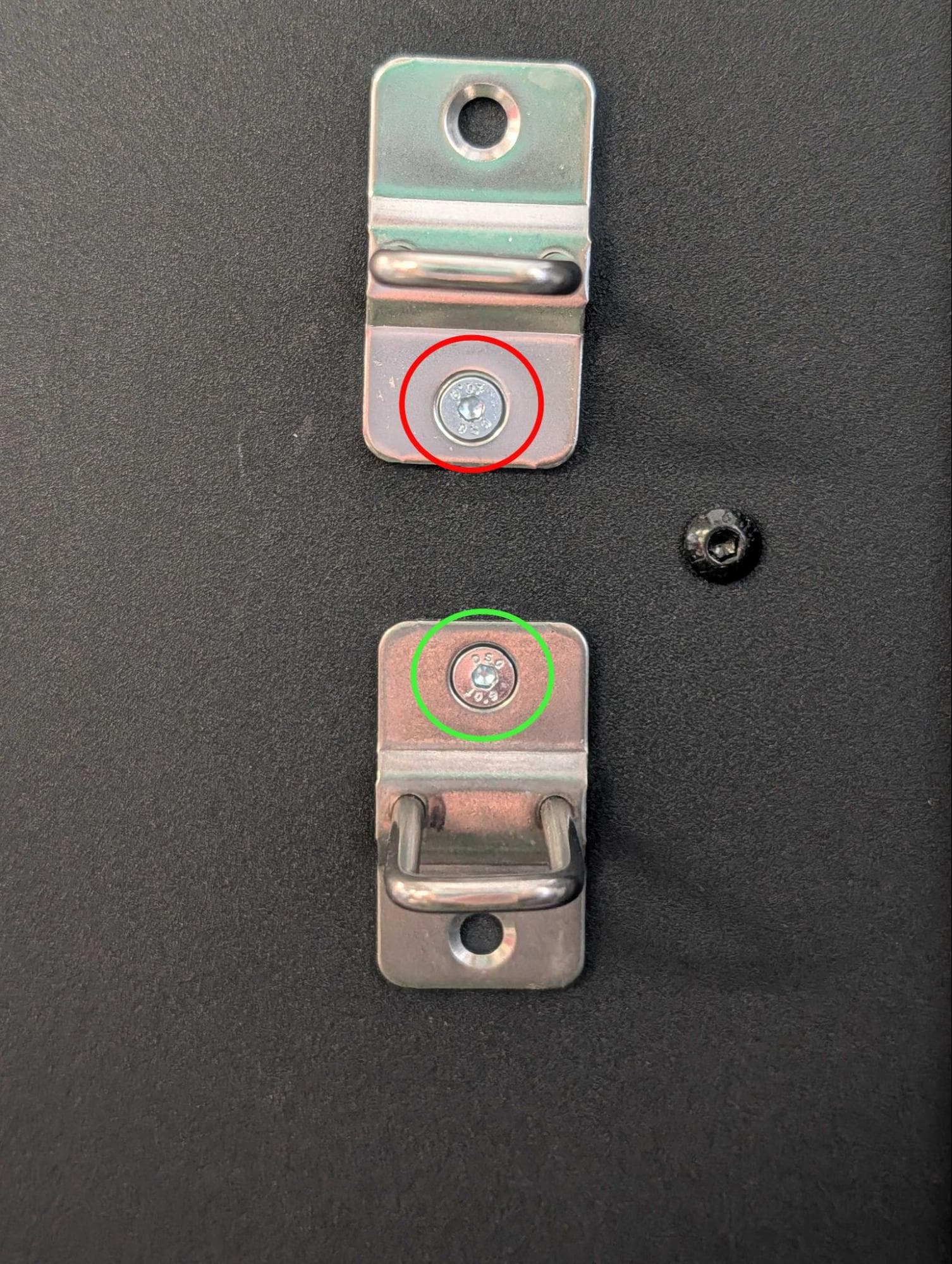

Step 3: Begin mounting the replacement latch striker
Align one of the screw holes in the new latch striker with the exposed screw hole in the door. Thread one 8 mm flat head screw into the screw hole.
Step 4: Remove the original latch striker
Using a 2 mm hex driver, remove the upper mounting screw from the original latch striker. Set the striker aside for disposal.
Step 5: Finish mounting the replacement latch striker
Twist the new striker upwards, aligning the open screw hole in the striker with the corresponding screw hole in the door. Thread the remaining 8 mm flat head screw into the screw hole.
Tip:
Insert the screw or an extra driver into the upper screw hole in the backplate to prevent it from spinning with the striker.
Step 6: Secure the replacement striker
Confirm the striker aligns with the latch, then tighten the screw with a 2 mm hex driver until snug.

Align the bottom of the hopper-side panel to the bottom of the printer and allow it to lean against you. Reconnect the interlock switch cable, labeled C033, to its receptacle. Route the cables into the cable clamp with the connector positioned below the clamp. If necessary, tuck the interlock cable slack into the side of the printer’s frame.

Thread one M4 countersunk screw into each of the 10 screw holes in the hopper-side panel. Using a 2.5 mm hex driver, tighten until snug. For greatest convenience and ease of installation, thread and tighten in the following order:
  1. Four 6.0 mm screws below the hopper, circled in red
  2. Three 16.0 mm screws below the filter door, circled in green
  3. Three 12.0 mm screws above the filter door, circled in blue

Thread the two black 8.0 mm M4 button head screws into the screw holes circled in red in the image here. Thread the chrome 8.0 mm M4 button head screw into the screw hole circle in blue here. Using a 2.5 mm hex driver, tighten until snug.
