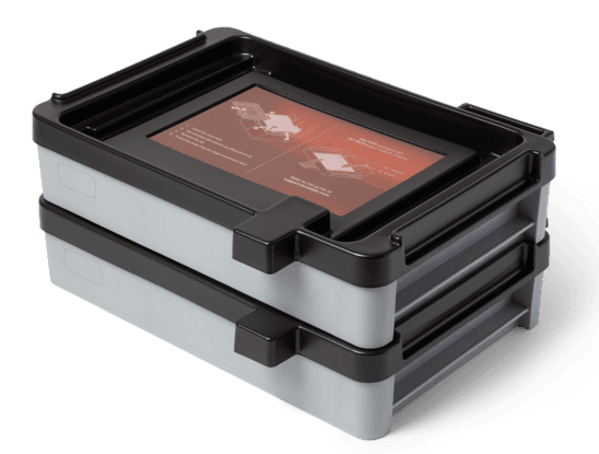

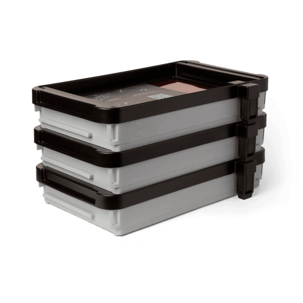

Whenever a resin tank is not installed in the printer, store it on a flat surface out of direct sunlight with the lid on. If the bottom of the resin tank has liquid resin on it, clean it before storing the tank. Stack multiple tanks for easy storage.
Tip:
Label the tank and tank case with the date of first use to track the type and age of the resin in each tank.
Two stacked Form 4 resin tanks
Three stacked Form 4L resin tanks
