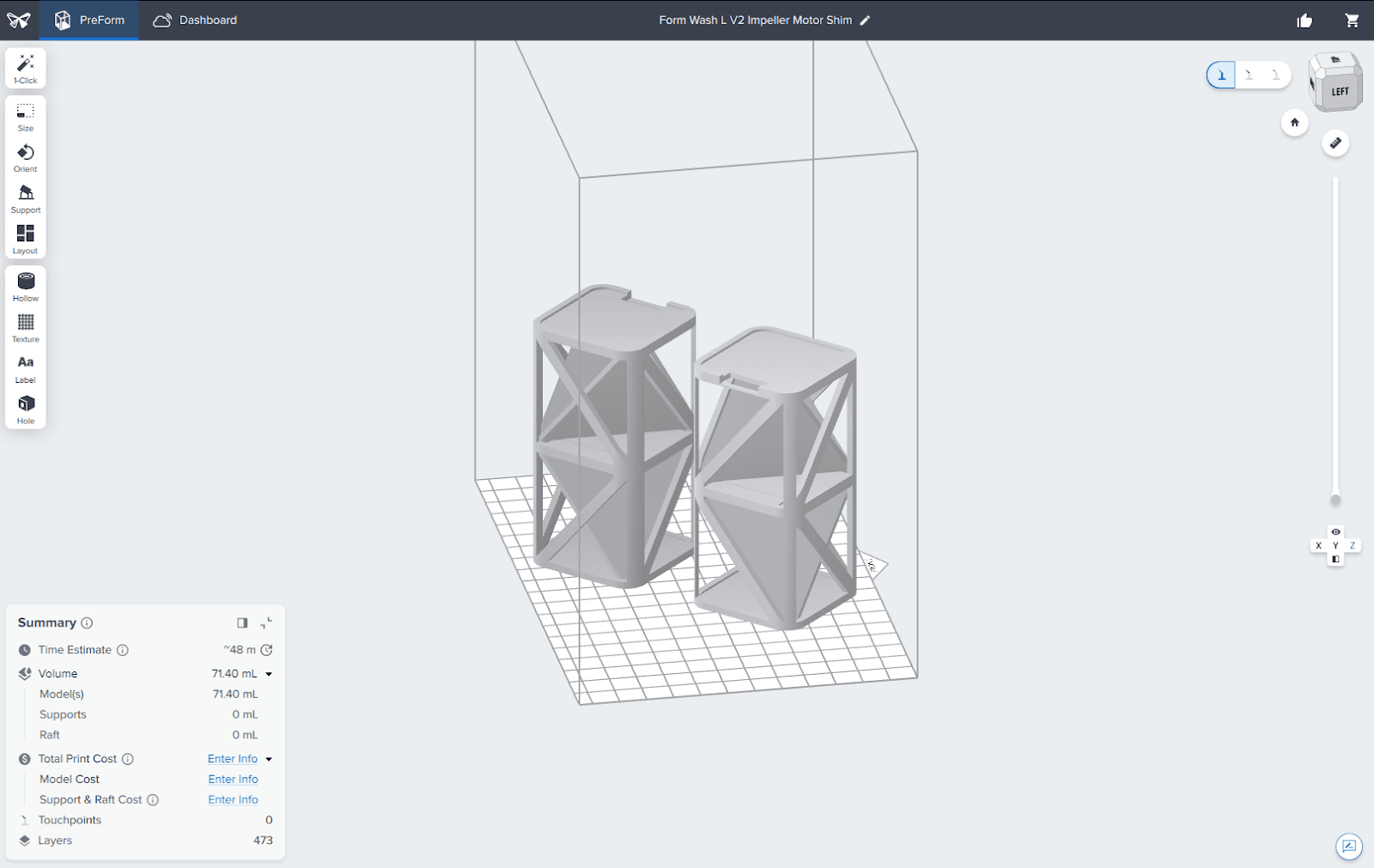

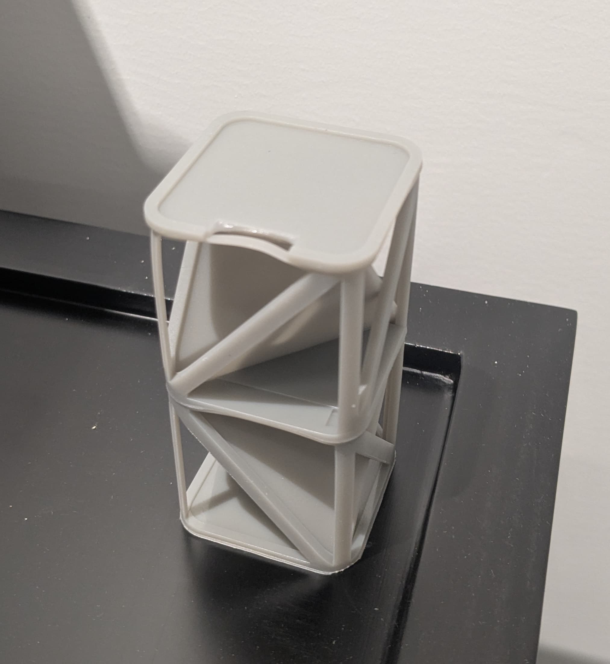

Step 1: Print the impeller motor shims
Print two impeller motor shims in any inflexible resin, such as Grey Resin, Tough 1500 Resin, or Rigid 10K Resin. Print directly on the build platform without supports. Do not use Elastic 50A Resin, Flexible 80A Resin, or another resin with similar material properties. Wash and post-cure the parts appropriately for the material you use.
Form Wash L V2 impeller motor shim models in PreForm

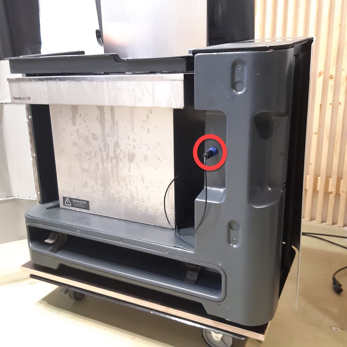

Step 2: Unplug the solvent monitor
Disconnect the solvent monitor from the front of the Form Wash L.

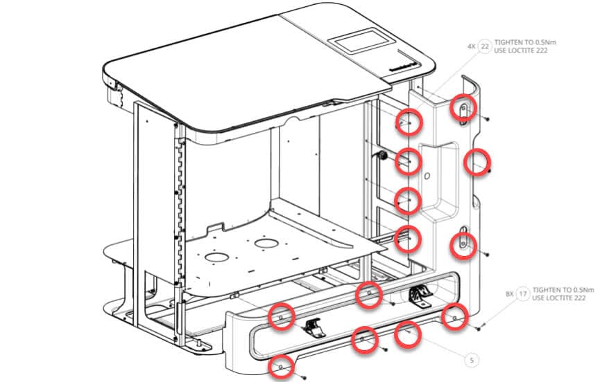

Step 3: Remove the lower front panel screws
Step 6: Remove the lower front panel
Use a 2.5 mm hex driver to unscrew the 12 screws shown above. Set the screws aside.

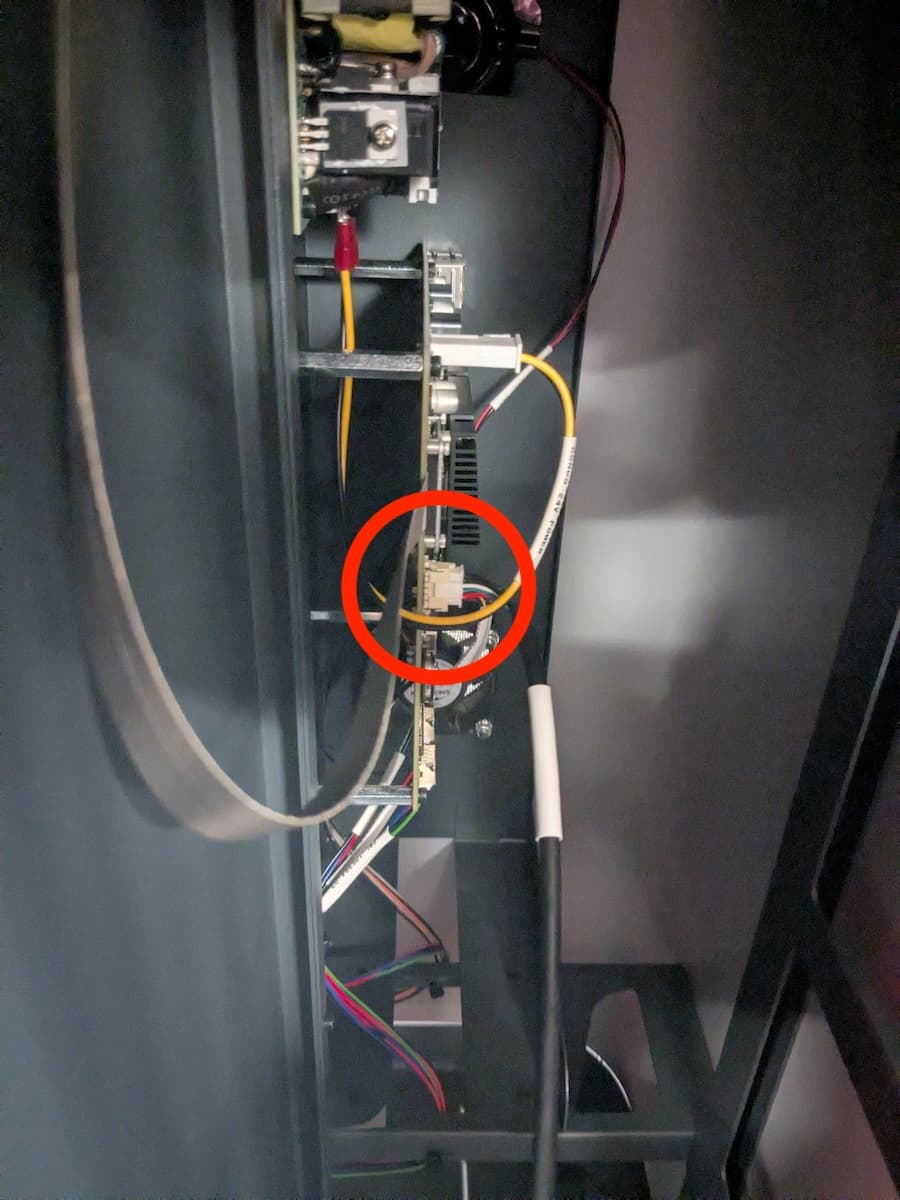

Pull the panel slightly towards yourself until you can see the solvent monitor cable behind the panel. Do not fully remove the panel, as it is still connected to the motherboard via this cable.
Step 4: Unplug the solvent monitor cable
Disconnecting the solvent monitor cable from the motherboard

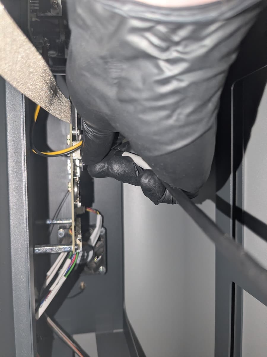

Follow the solvent monitor cable from the lower front panel into the Form Wash L and locate its connector on the front edge of the motherboard. Squeeze the locking tab on the connector and pull it away from the motherboard to disconnect the cable. Do not pull on the wires themselves.

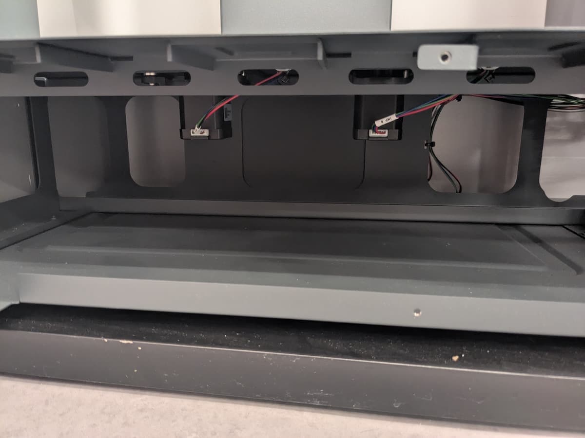

Step 1: Locate the motor assemblies
The Form Wash L has two impeller motor assemblies located underneath the base plate of the machine. Identify and locate the motors.

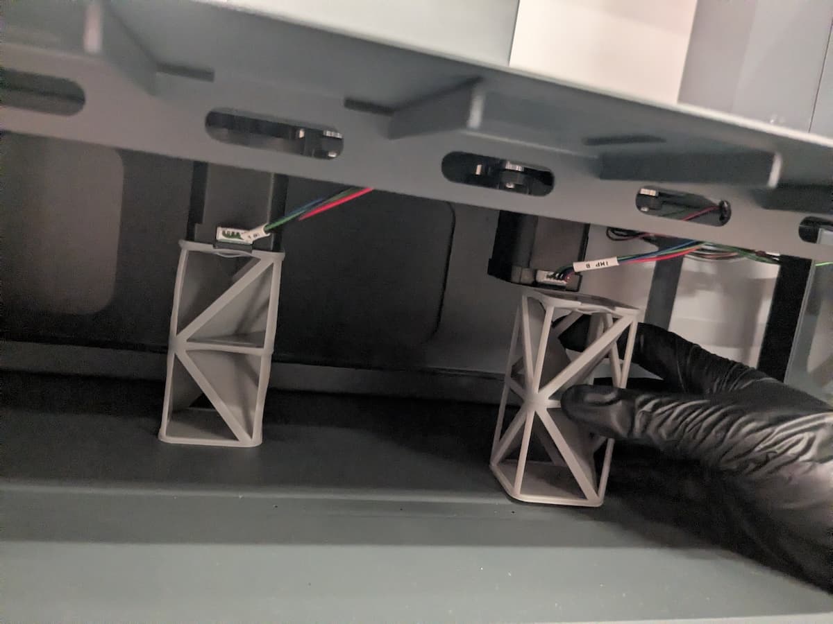

Step 2: Install the motor shims
Installing the Form Wash L V2 impeller motor shims
Orient the motor shims with the small slot at the top-front. The slot gives clearance for the motor cables. Slide the shims underneath the motors until they click into place, with the raised lip on the shim sitting around the edge of the motor.

Step 4: Reconnect the solvent monitor
Plug the solvent monitor cable from the wash bucket into the socket on the front panel.
