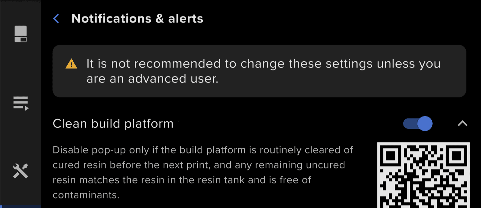

To control printer alerts on a Form Studio 1 printer:
  1. On the printer's touchscreen, tap Settings > Configuration > Notifications and alerts. The Notifications and alerts screen appears.
Controlling Form Studio 1 printer notifications
  1. Tap the toggle next to a notification name to enable or disable it. You can enable or disable the notifications listed in the table below. Tap the down arrow next to a notification name to learn more about it.
Notification Effect
Clean build platform When this notification is disabled, the printer does not ask you to confirm that the build platform is clean and secured when you insert it. You will still need to confirm that the build platform is clean, either on the printer status screen or in PreForm during the print job upload, to start a print.   Formlabs recommends disabling this notification only if you routinely clean and resecure the build platform without prompting between prints. Inserting a build platform with cured debris, a previous print, or liquid resin that does not match the resin in the tank may lead to print failures.
