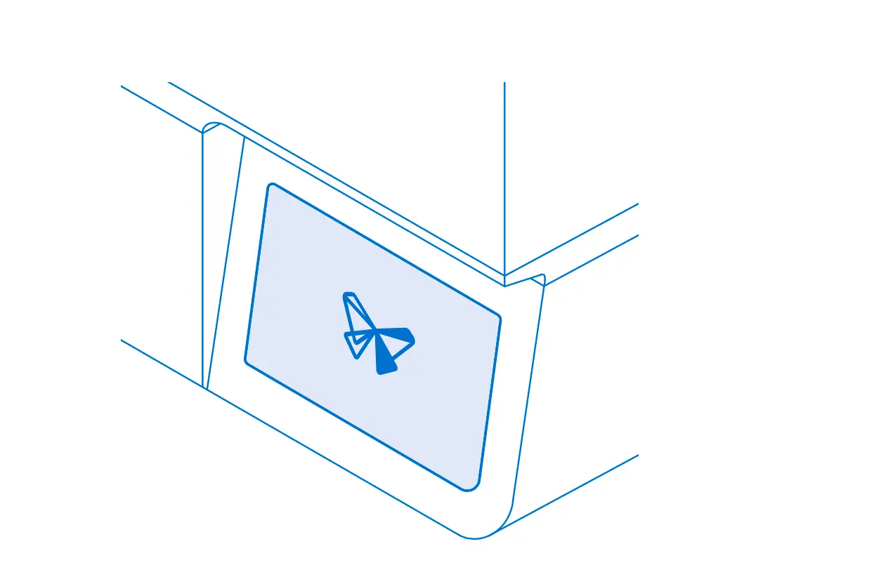

  1. Remove any protective film on the display and follow the prompts on the screen to complete the printer setup.
Onboarding screens on the Form Studio 1
Notice:
Do not cover the printer with any packaging or any other covers or sleeves during printing. Insulating the printer during printing can damage the machine.
Proceed to follow the onboarding guide on the printer’s touchscreen. Once you’re done, connect to your printer if you have not already done so.
