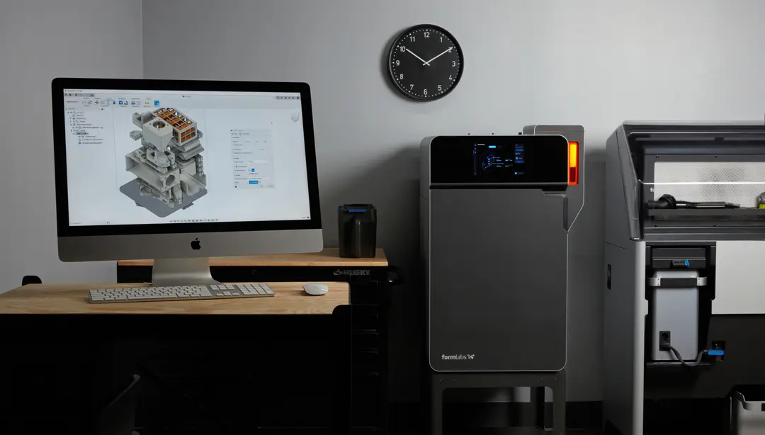

The Fuse 1 is now the best selling selective laser sintering (SLS) solution on the market, but it was a long road to mass production. Creating the Fuse Sift, the post-processing and powder recycling machine that streamlines the SLS workflow, was a new challenge for the Formlabs engineering team, and it required unique approaches and solutions to succeed.
One particular challenge arose when designing parts for the powder containment system on the final stage prototypes of the Fuse Sift. The powder containment subsystems needed to dissipate the static electricity generated by fast moving powder particles, but couldn’t be prohibitively expensive or slow to make.
Learn how the development team was able to quickly and inexpensively prototype Fuse Sift parts using an ESD-safe resin, allowing the team to ship prototype units to beta testers.
Developing a Complete SLS Workflow
In 2019 Formlabs had a powerful SLS printer prototype, but without a high quality post-processing system to go with it, the printer wasn’t truly an industrial solution. Most SLS customers print end-use parts in professional and manufacturing environments, so containing the small powder particles is of utmost importance in maintaining a safe and clean workspace.
To address this concern, the Fuse 1 team started working on the Fuse Sift, a powder reclamation and recycling station that processed parts out of the Fuse 1 printer. The goal of the Fuse Sift was to create an end-to-end solution and streamline the workflow for SLS printing. In 2019 both the Fuse 1 and Fuse Sift prototypes were almost ready for external beta testing, but powder control on the Fuse Sift prototype wasn’t ready for launch.
