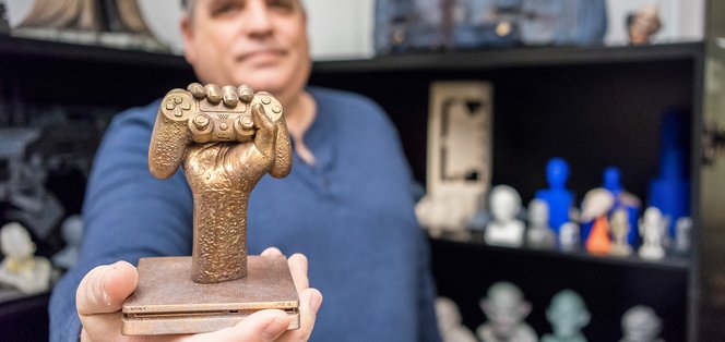

Prototyping in-house with SLA desktop 3D printing can also be extremely cost-efficient. Barth was able to design a trophy for an employee awards ceremony for a fraction of the price and time of outsourcing–even using the same printer.
A 3D printed prototype alongside painted, final version of an internal Sony trophy: A hand holding a Playstation controller.
For an internal awards event, Barth created a half-scale hand gripping a PlayStation controller. After prototyping, the final design was sent out for molding, and the castings were painted.
