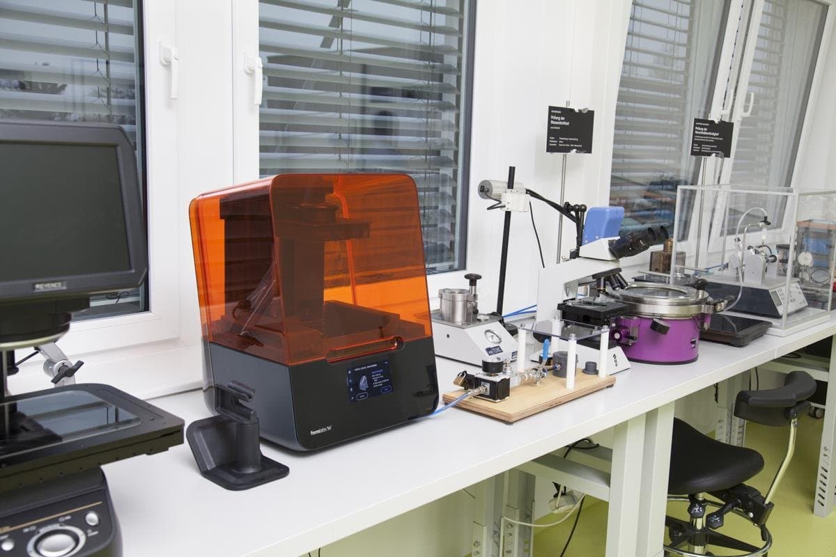

Sinn Spezialuhren, a manufacturer of feature-rich, mechanical watches, had originally purchased a Form 3 stereolithography (SLA) 3D printer for prototyping. You can read more about how their product development team used 3D printing to create high-precision prototypes for watches in our story here.
However, the company’s development team quickly realized that they can leverage 3D printing for producing manufacturing tools, such as mounts, fixtures, and testing equipment.

The Form 3 in the Sinn Spezialuhren laboratory.
Now the Form 3 is increasingly being used in equipment manufacturing. The only costs incurred are the material costs and the time required for post-processing. Parts can be printed overnight and if the printed parts or designs do not meet the requirements, any adjustments can be made quickly.

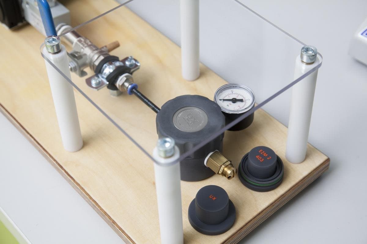

The UX diving watch, one of the models in the Sinn’s watch range, is filled with crystal-clear oil. This liquid changes its volume when the temperature changes, so the watch has a membrane base that extends when heated or retracts into the case when the temperature cools down. This membrane base provided the biggest wow factor for Mr. Hunder and his team during the development of a testing system.
Membrane bottom testing system for the UX watch model with a 3D printed bracket.

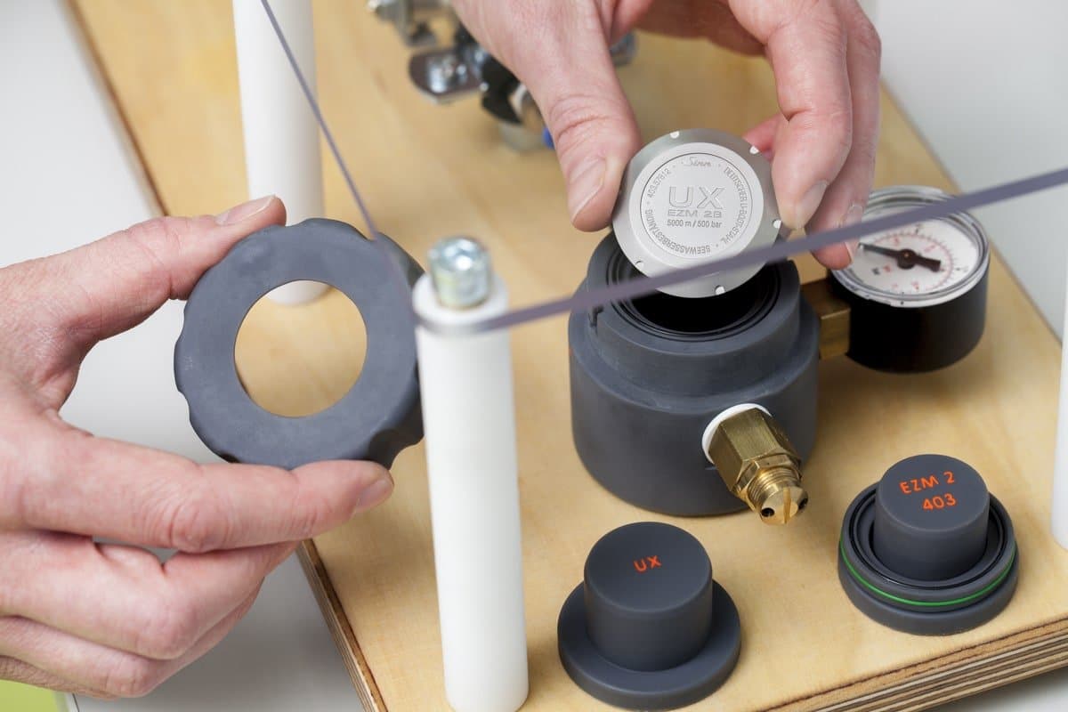

The aim of the testing system is to check the swing of the membrane base, whether it extends straight or slightly angled, which can then be aligned accordingly. Previously, a complete watch had to be built and heated for this purpose. This was a very time-consuming process, as all the components were contaminated with liquid and subsequently had to be cleaned again.
To make this laborious work easier, a test system was developed that uses air pressure to simulate the behavior of the liquid.
Watch the video: The 3D printed membrane base testing system in action.
Tough 2000 Resin was used to print the pressure pot with different insert rings into which different cases fit, as well as the locking, which closes with a bayonet mount. This bayonet mount presented the greatest challenge because it is very difficult to manufacture in conventional production. Additionally, supports for an acrylic glass cover were made from Rigid 4000 Resin.
The 3D printed testing bench was originally only intended to test the general feasibility of the test rig and the use of the bayonet mount. In the end, it worked so well that conventional production was no longer necessary. The 3D printed testing bench has also been inspected and approved by the German Technical Inspection Association (TÜV).
