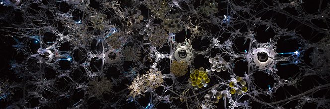

Tell us more about your Sentient Veil installation. What role did SLA 3D printing play in that process?
Sentient Veil is embedded with many small actuators, rippling light, and a set of distributed speakers that have been custom built in order to have tiny little sample base responses that are amplified by the resonance of the cases.
Beesley describes the Sentient Veil experience as one akin to a pebble in a pond: “When you come up your gestures are tracked and you might make a small gesture in some place that will bloom out in a ripple of light that will pass through the entire environment, accompanied by whispers and murmurs.” Play the video to see and hear Sentient Veil. Video: PBAI
3D printing was used for direct manufacturing of the extended back-pressure speaker horns. That particular form involves quite precise tuning of the proportion of the sound chamber in order to maintain its pressure and to move a column of air that can take relatively modest sound source through resonance, make the most of lower registers, and make a very high fidelity representation of a sound signal.
Design drawings of Philip Beesley’s custom speakers, prototyped and produced using SLA 3D printing for his Sentient Veil installation at the Isabella Stewart Gardner Museum in Boston.
The speakers in Sentient Veil required very precise air flow. Beesley employed SLA 3D printing to quickly and affordably prototype and manufacture the custom speakers. Photo: PBAI
We were able to focus on freeform modeling of that air chamber with much fewer limitations than if we worked with casting, milling, compositing or thermoforming–the tools we'd normally use for this kind of chamber, and other relatively short runs of highly-customized pieces.
Moving into larger production that would become a moldmaking system which would then be very happily integrated with traditional craft. Rather than printing positives we would print negatives, and then we would detail those with the traditional craft of screws and vents and would use them for casting.
A photo of Philip Beesley’s custom speakers in his Sentient Veil installation at the Isabella Stewart Gardner Museum in Boston.
The final speakers in Sentient Veil were printed in Clear Resin on the Form 2 SLA 3D printer.
