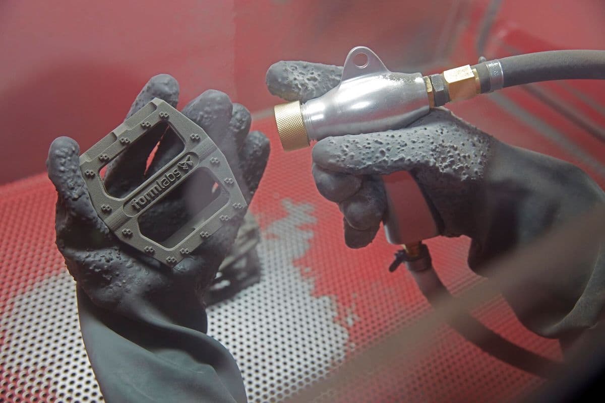

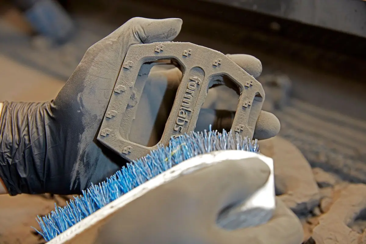

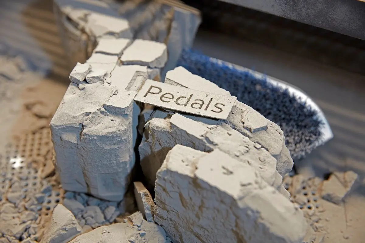

Fuse 1 generation printers surround each printed part with Surface Armor, a semi-sintered shell. This alleviates potential thermal inconsistencies which may adversely affect a part’s accuracy. Surface Armor improves surface finish and is discarded during post-processing.
Stronger Surface Armor is required for parts printed with Nylon 12 GF compared to Nylon 12 or Nylon 11. While the workflow for all three materials is similar, you will need to use a media blaster to effectively remove all surface armor from Nylon 12 GF parts.
To post-process parts printed with Nylon 12 GF:
Note:
Use extra care to avoid damage to small, delicate features during post-processing. Use multiple passes to ensure that you remove all Surface Armor from holes and small enclosed areas in your parts.

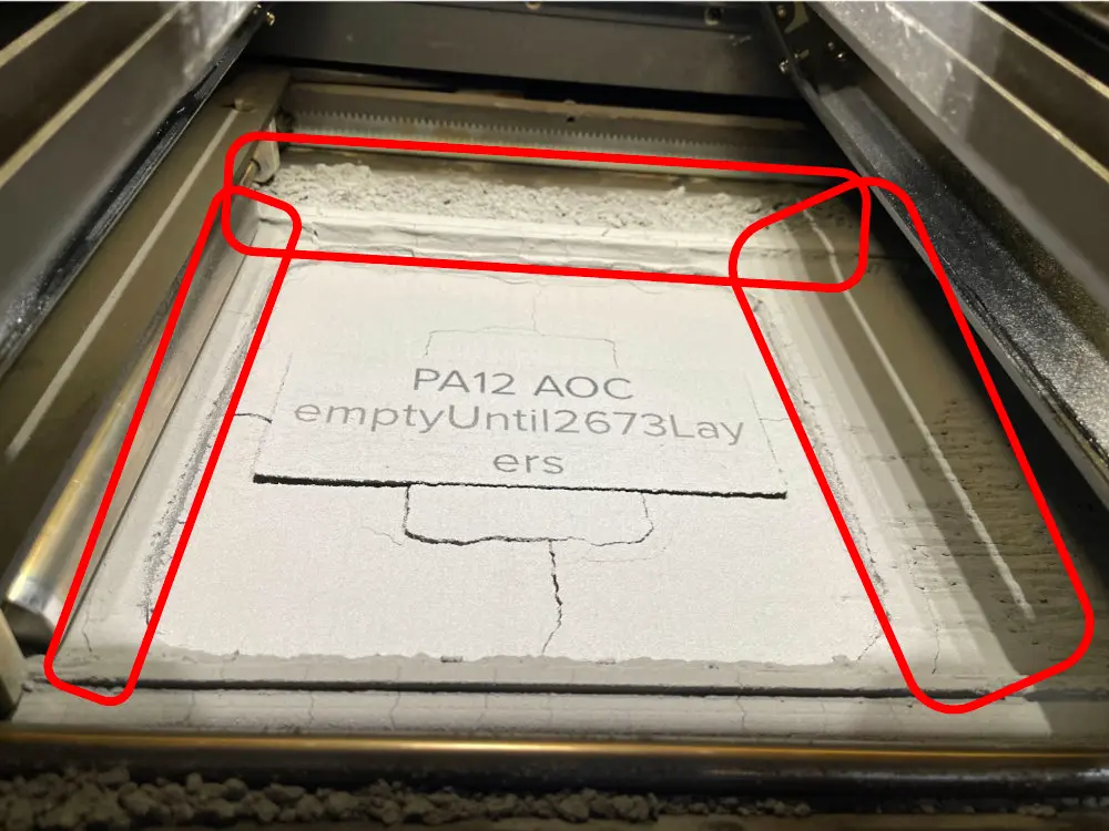

Cleaning the top of the print enclosure

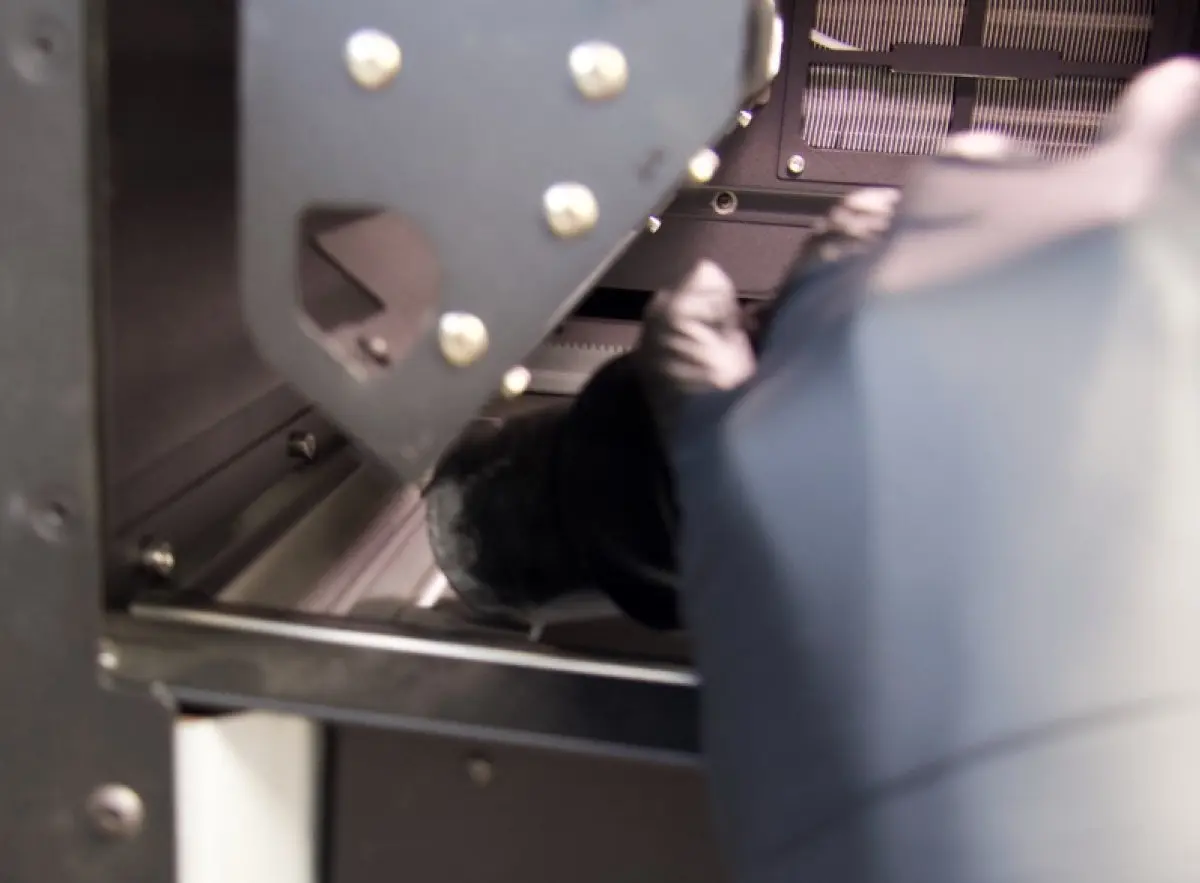

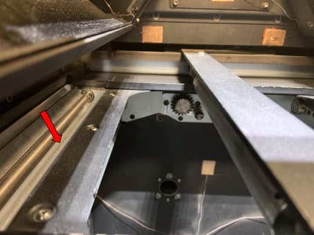

Powder can accumulate at the top of the print enclosure, particularly on the runways, the areas between the powder troughs and the top of the build chamber. This excess powder may fuse and be dragged into the build chamber during subsequent prints. Vacuum this area thoroughly to help prevent print failures.

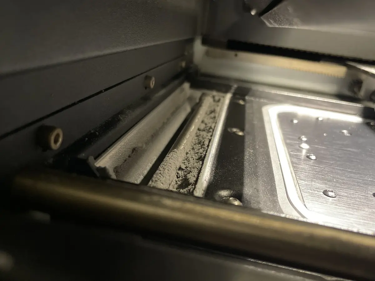

Vacuuming the troughs

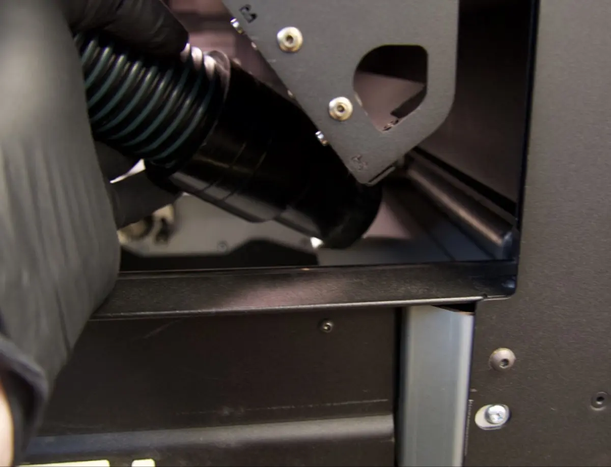

Between prints, clean both troughs and the area around the recoater’s path using a compliant vacuum with static dissipative components. Use the vacuum, fitted with a small brush attachment or the flexible hose attachment, to clean all powder out of the troughs. If needed, use compressed air or a gas duster to remove powder from hard-to-reach areas. Check in particular for powder buildup along the inner walls and corners of the troughs.

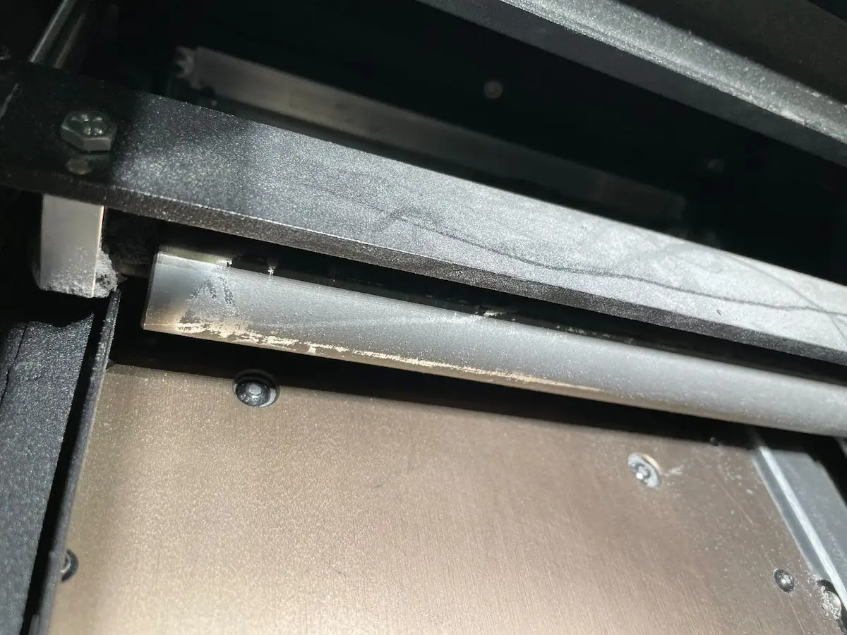

Cleaning the recoater
Move and inspect the recoater. If it appears coated with semi-sintered powder, clean the recoater before running another print.
To clean the recoater:
