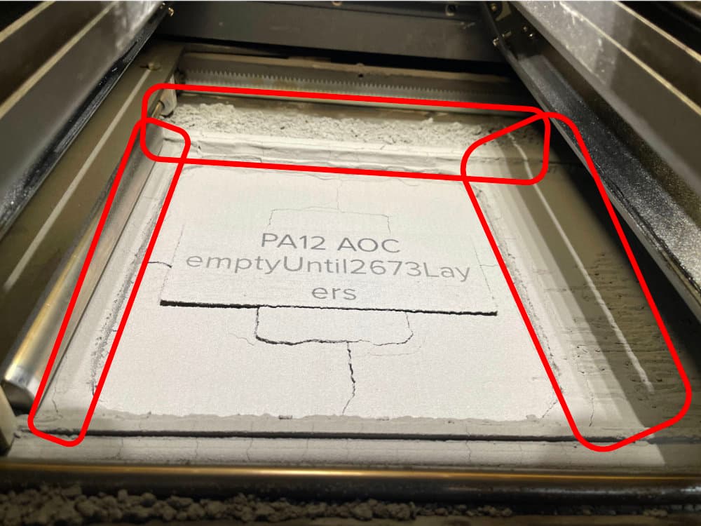

Cleaning the top of the print enclosure
Powder can accumulate at the top of the print enclosure, particularly on the runways, the areas between the powder troughs and the top of the build chamber. This excess powder may fuse and be dragged into the build chamber during subsequent prints. Vacuum this area thoroughly to help prevent print failures.

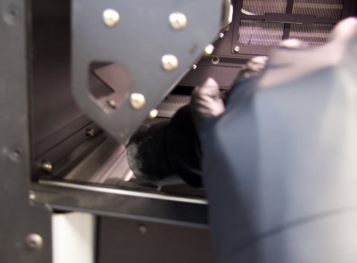

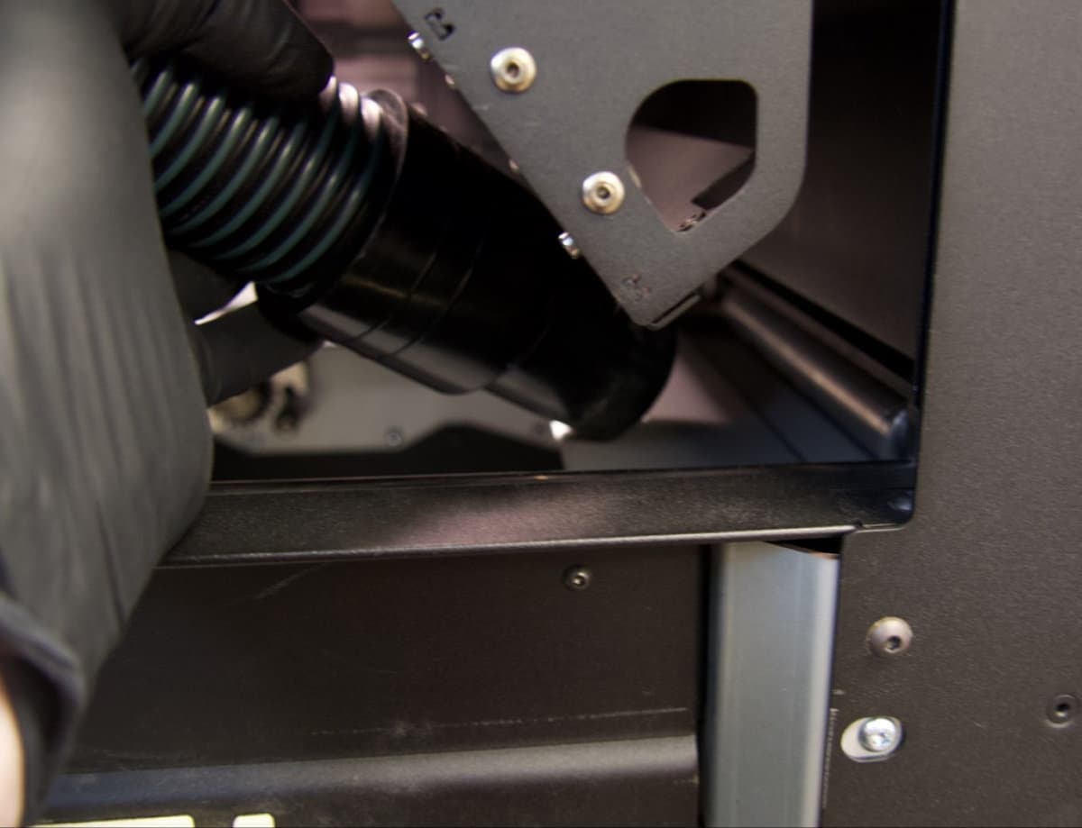

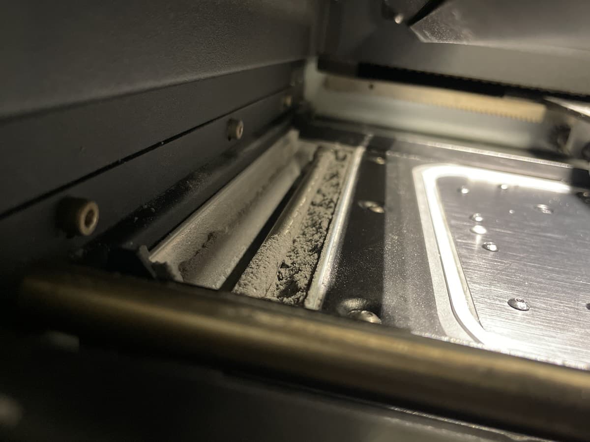

Between prints, clean both troughs and the area around the recoater’s path using a compliant vacuum with static dissipative components. Use the vacuum, fitted with a small brush attachment or the flexible hose attachment, to clean all powder out of the troughs. If needed, use compressed air or a gas duster to remove powder from hard-to-reach areas. Check in particular for powder buildup along the inner walls and corners of the troughs.
TPU 90A Powder buildup in a Fuse 1+ 30W printer trough

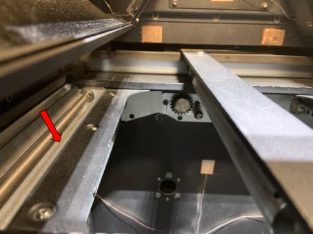

  1. Tap the CW, CCW, and Home arrows under the Flipper (Left) and Flipper (Right) headers to rotate the left and right flippers clockwise, counterclockwise, or back to their home positions. Repeatedly move the flippers and vacuum the powder troughs until they are clean. In particular, ensure that the inner edge of both powder troughs as well as any adjacent components are free of powder.

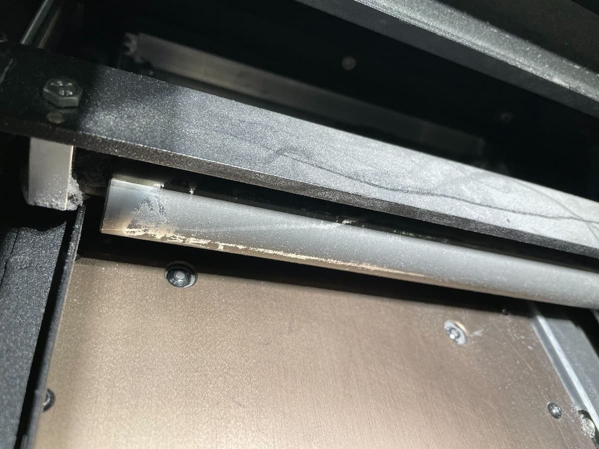

Move and inspect the recoater. If it appears coated with semi-sintered powder, clean the recoater before running another print.
To clean the recoater:
  1. On the touchscreen, tap the wrench icon. The Maintenance screen appears.
  2. Tap Motor Moves. The Motor Moves screen appears.
  3. Tap the < (Left) or > (Right) button under Recoater until you can view the recoater assembly.
  4. If the recoater is covered with semi-sintered powder, clean it with a PEC*PAD or other lint-free microfiber cloth wetted with ethanol.
TPU 90A Powder buildup on the recoater
