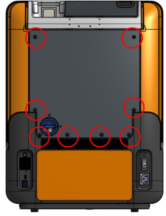

  1. Use a 2.5 mm hex driver to remove the eight screws securing the back panel to the printer. Set the screws aside.

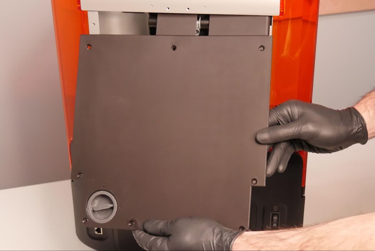

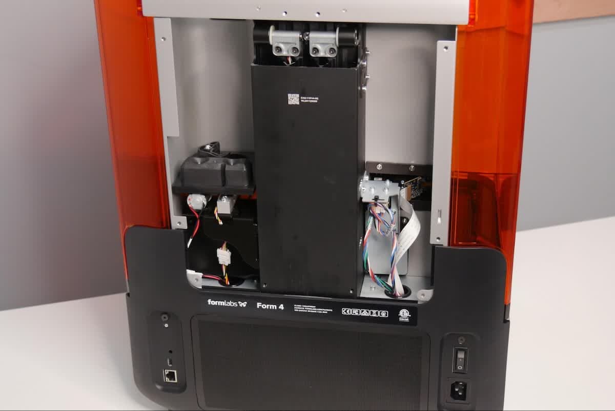

  2. Remove the back panel by sliding it down and away from the back of the printer. Set the back panel aside.

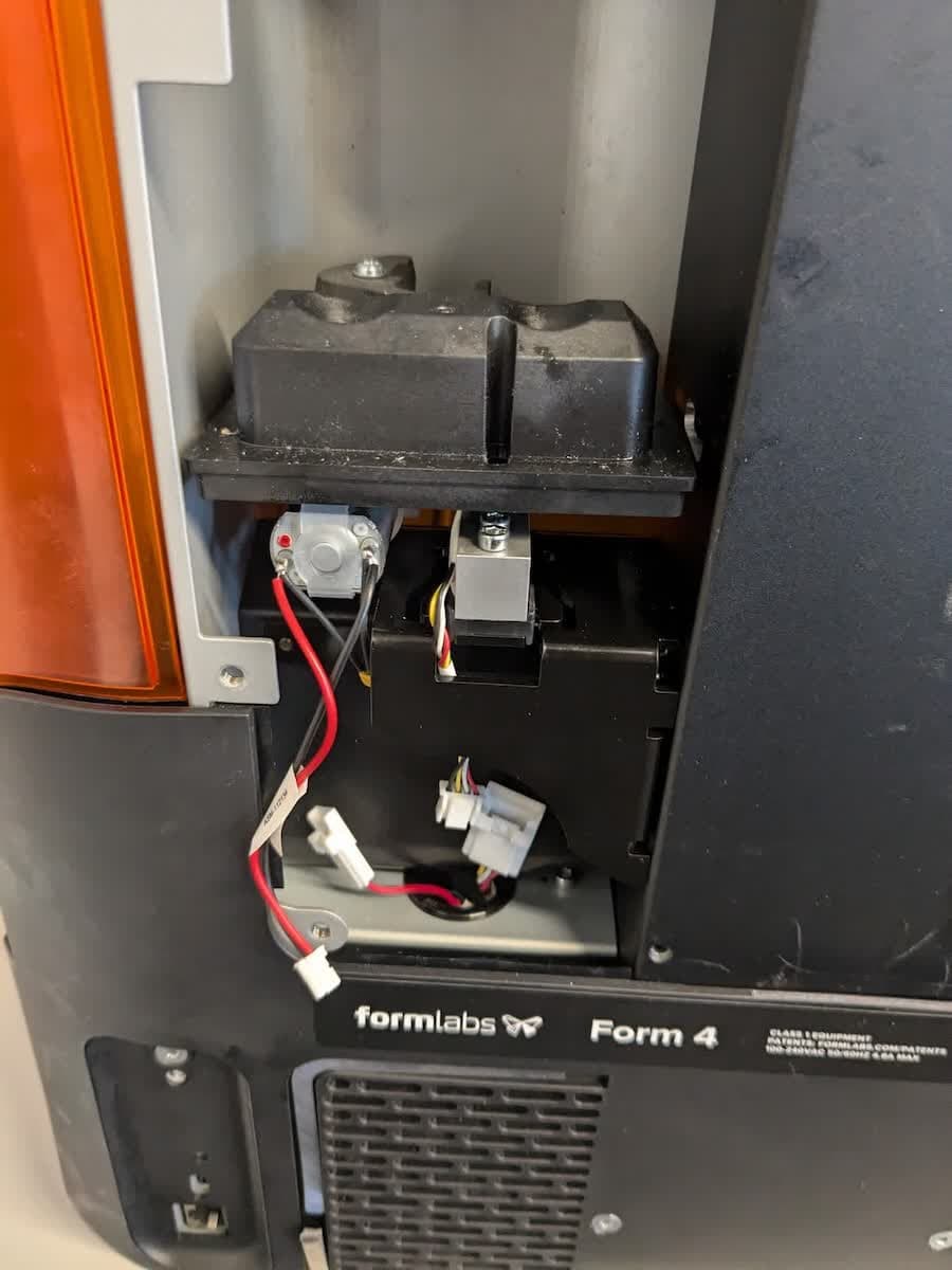

  1. Dampen cleaning swabs with isopropyl alcohol (IPA) and use them to thoroughly clean the cartridge floor.
  2. Move the dispense arm by hand, checking that it pivots smoothly and returns to its starting position without sticking.
  3. Allow any remaining IPA to fully evaporate.
