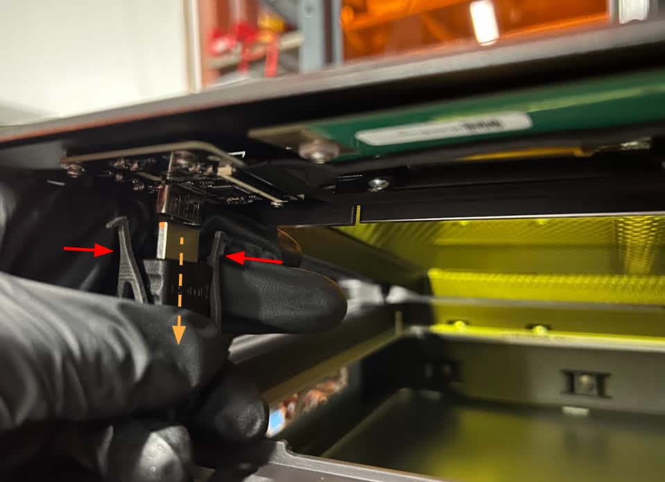

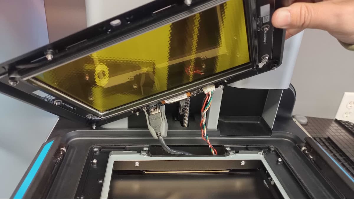

  1. Check if the HDMI clip is broken. Follow the instructions for replacing your printer’s LPU to access the clip and reassemble the printer. If the port on the LPU itself is damaged, the LPU will need to be replaced. Replacement Form 4 and Form 4L generation LPUs are available for purchase on the Formlabs Store.
HDMI clip on a Form 4 generation printer
HDMI clip on a Form 4L generation printer

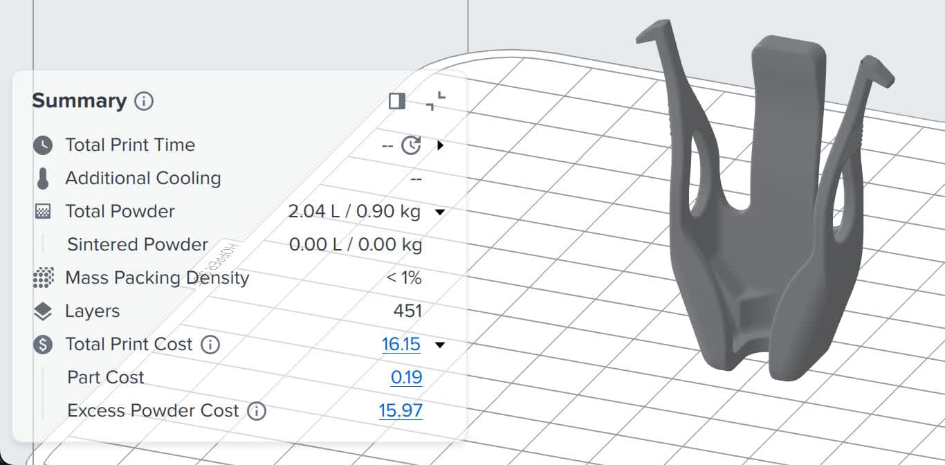

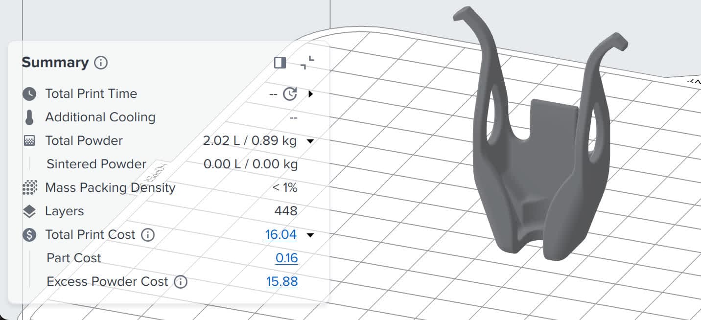

  1. Print a replacement HDMI clip. Use another printer if one is available or, if needed, temporarily secure the HDMI connector to the LPU. Formlabs designed this part to be printed on a Formlabs SLS printer with Nylon 12 Powder, but other materials, including most resins, should work as well.
HDMI clip on a Form 4 generation printer in PreForm
HDMI clip on a Form 4L generation printer in PreForm
