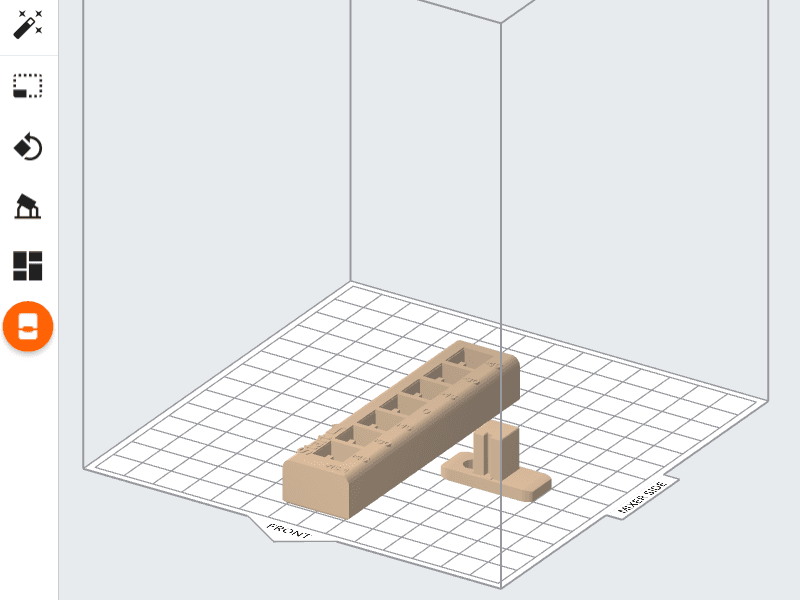

  1. Open the recently downloaded file in PreForm. The model opens as an uneditable FORM file in the selected resin.
    Note:
    The supplied test file opens as a FORM file that should not be modified, including actions such as moving, rescaling, reorienting, or adding supports.
    1. Click the orange Print button to send the job.
    2. Select the printer you wish to print the Fit Tuning Test.
    3. Start the print job on your printer.
    The test file opens the Fit Tuning Test as two separate parts within PreForm

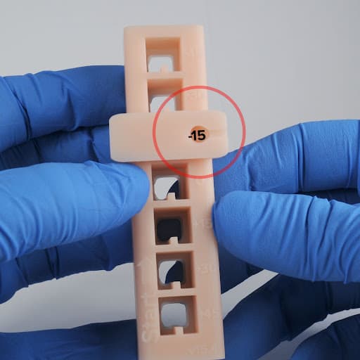

    The Fit Tuning Test is an object that is 3D printed by a user to tune the fitment of models. The test print consists of two printed parts, the “block” and the “peg.”
    Depending on the printer, the test can result in a value of +45, +30, +15, 0, -15, -30, or -45. The starting position is the loosest fitment, +45, and becomes tighter as you move up the block.

    Testing begins by following the path identified on the block as the Start position. Insert the peg into the slot labeled as +45.
    Attempt to remove the peg from the block. If the fitment is loose and the peg can be easily removed, insert the peg into the next slot.

    To check proper fitment:
    1. Hold the peg from the short sides that extend beyond the block to gain leverage.
    2. Twist and rotate the peg into its inserted position within the slot.
    3. A proper fitment does not wiggle or move. Remove the peg and advance to the next slot position if you feel any movement.

    Step 4: Review the results
    Once the peg is inserted into a slot position that meets fitment criteria, check the number displayed in the peg’s viewing hole. This number is the printer's Fit Tuning value for the given material and layer thickness.
    Enter this value using the printer touchscreen.
    The viewing hole for a perfect fit with the test print is highlighted.
