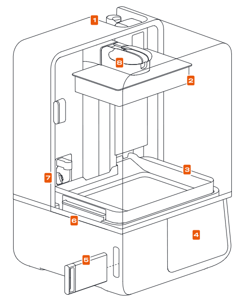

Printer components
Form Studio 1 components
Required for printing
  1. Resin cartridge
  2. Build platform
  3. Resin tank
Printer components
  1. Printer touchscreen
  2. Tool caddy
  3. Tank latches
  4. Camera
  5. Build platform latch

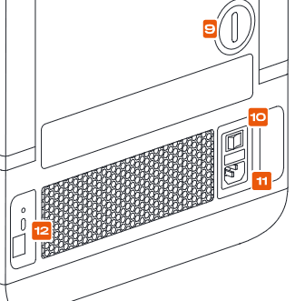

Form Studio 1 components - rear
Rear ports
  1. Optional exhaust port
  2. Power switch
  3. Power port
  4. USB and Ethernet ports

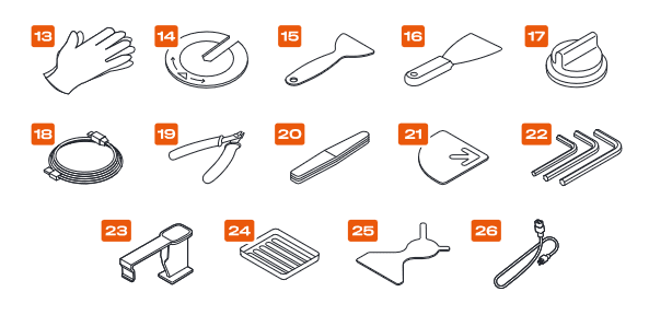

Form Studio 1 accessories
Included accessories
  1. Non-reactive nitrile gloves
  2. Leveling disc
  3. Mixer/plastic tank scraper
  4. Metal scraper
  5. Camera lens cap
  6. USB cable
  7. Flush cutters
  8. Sanding sticks
  9. Parallelism shims
  10. Hex keys
  11. Cleaning sheet removal tool
  12. Drip tray
  13. LevelSense calibration tool
  14. Power cable

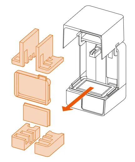

  8. Open the printer cover.
  9. Remove the resin tank, build platform, and the internal foam.
  10. Remove the protector from the Light Processing Unit.
Unboxing the Form Studio 1
Note:
The original packaging is designed to be kept and reused for transporting or shipping the machine for service. Save the complete packaging including any inserts for your convenience.

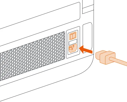

Connect the power cable to the printer and a power outlet and turn on using the rear power switch.
Connecting the Form Studio 1 to power
Note:
If the printer does not initialize and display the onboarding prompts, ensure that the cover is closed.
