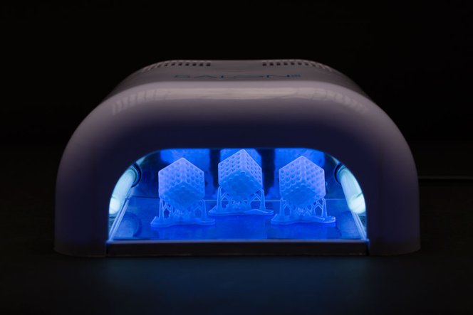

Size and complexity of parts: For small prints, a low-cost UV nail salon can be an effective post-curing tool. For larger, more complex parts, be sure to consider units that provide even exposure (through well-balanced light placement, a rotating turntable, etc.) to ensure uniform curing.

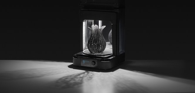

Need for speed: Heat speeds up and optimizes the post-curing process. If efficiency is essential, consider a unit that uses both light and heat.
Post-Curing Designed for the Form 2
Our goal in developing a post-curing solution for our users was to simplify and optimize post-curing for Formlabs materials.
We’ve run extensive tests to determine the most effective technology, developed unique settings that work best for each resin, and designed an intuitive, automated process for hassle-free post-curing.
The result is Form Cure, a reliable, professional post-curing solution engineered to help our users get the most out of their Form 2.
