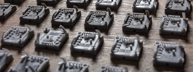

We needed something a bit more complex. Enter the “Formtest.”
The Theory Behind The Formtest
The Formtest is a model that can be used to evaluate the performance and reliability of a 3D printer. The part’s features help us assign quantitative scores related to printer performance.

At Formlabs HQ, the Formtest is probably the most frequently printed part, other than the Rook (which you can request as a free sample).
Any time we make changes or introduce new software, process, material, or resin, we use the Formtest to evaluate the most important performance aspects. Even if the change or new development passes validation testing on the first attempt, the team still prints between 16 and 32 Formtests to make sure that all is well across several printers and that print success is repeatable.
We don’t stop at the Formtest when performing our validation testing, but it’s always included no matter what. Because this standardized test part has data ranging back as far as the first printer we released, the Form 1, we can make scientifically-backed, data-driven decisions.

After several attempts at theorycrafting the perfect test part and multiple rounds of practical iteration, the Formtest v1 emerged as a good compromise between intended goals, degree of difficulty, and practical considerations like print time and resin usage. After all, reliability testing means having to print multiple hundreds of this particular part.
The Formtest v1 contains features for all four categories mentioned before as well as a fifth “functional” category to relate the results to real world applications:
