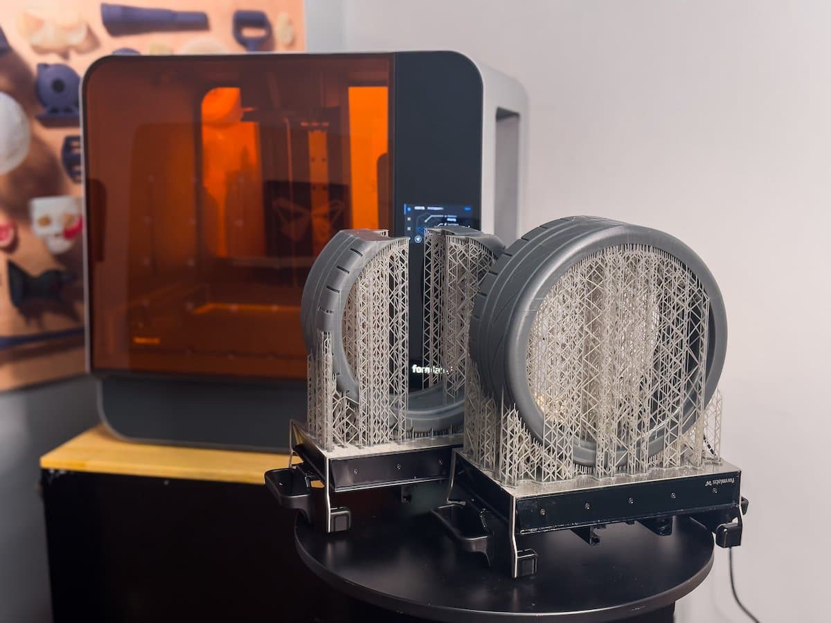

Extended SLA Build Volume for Larger Parts
form 3L and two large SLA 3D printed parts
PreForm 3.34.0 enables taller Z-axis heights for both Form 3/B/+ prints and Form 3/B/L prints.
For Formlabs SLA customers, build volume has previously been restricted to ensure that every part could be easily removed from the printer without any chance of the part hitting the resin tank or clipping the edge of the printer. Though this restriction helps limit potential damage to parts, many customers have requested a way to override these protections and create larger parts that take advantage of as much of the build volume as possible.
With these new settings, you can now print up to 4% taller parts on the Form 3/B/+. The available height is now 193 mm compared to the earlier 185 mm. On Form 3L/BL, you can now print up to 7% taller parts. The available height is now 320 mm compared to 300 mm previously.
Previous Maximum Build HeightNew Maximum Build HeightPercent Increase
Form 3/B/+185 mm193 mm 4%
Form 3L/3BL300 mm320 mm7%
It’s important to exercise extra caution while removing tall prints from the printer. Make sure the print does not make contact with the wall of the tank; you may need to remove the tank and print simultaneously for a smooth extraction.
