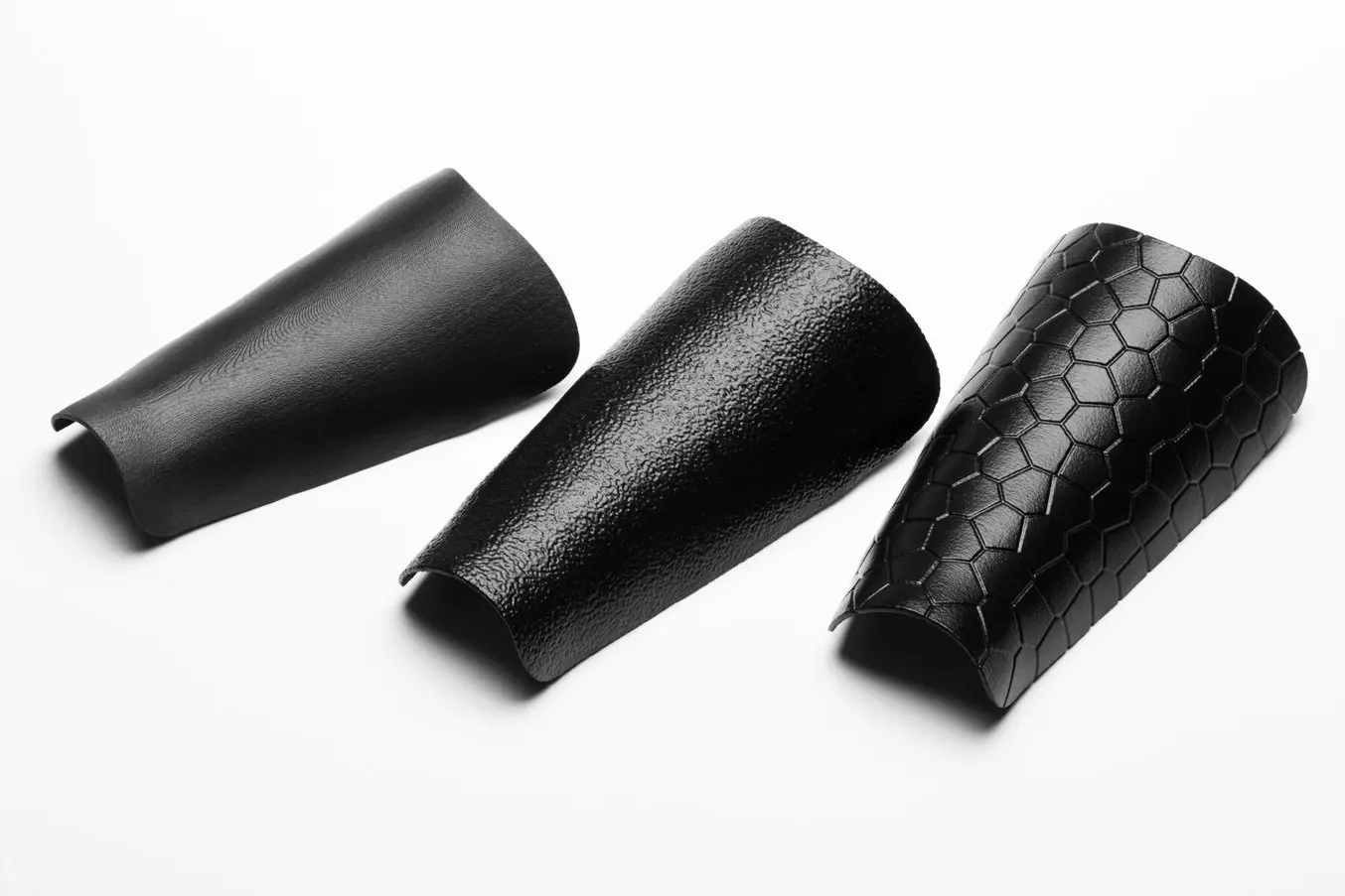

vapor smoothed shinguards

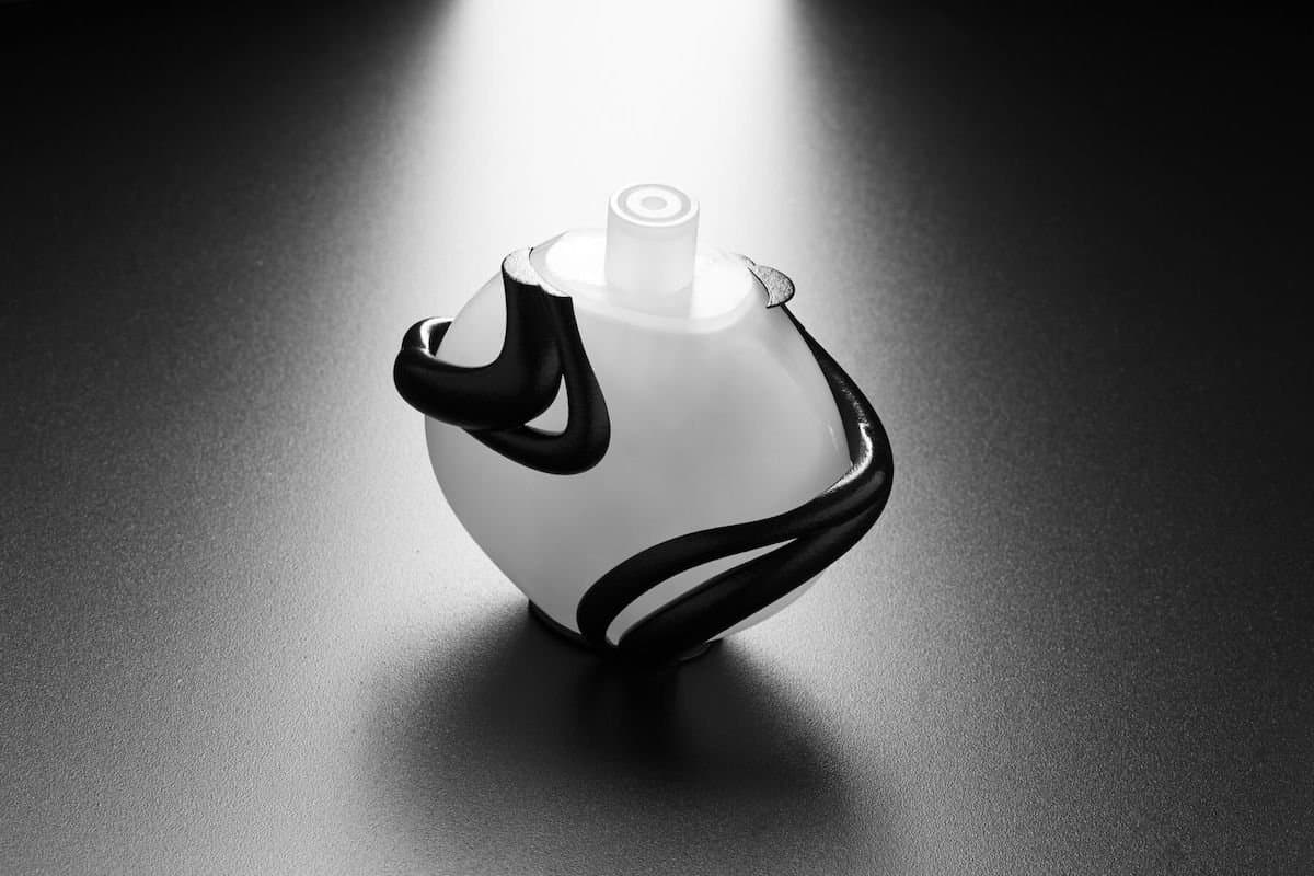

Custom perfume bottle packaging including a black wrapping feature that was printed on the Fuse Series SLS 3D printer in Nylon 11 Powder and then vapor smoothed.
Vapor smoothing is an ideal way to improve the surface quality and aesthetics of consumer goods, like this customized perfume bottle.

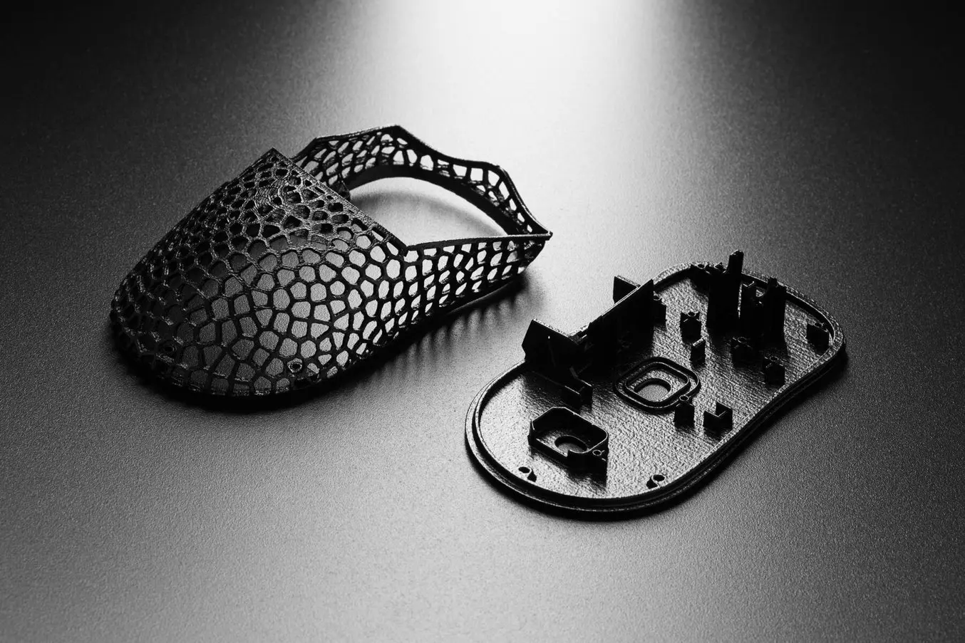

vapor smoothed SLS 3D printed computer mouse
Vapor smoothing is appropriate for parts with thin walls because it has almost no impact on structural integrity.

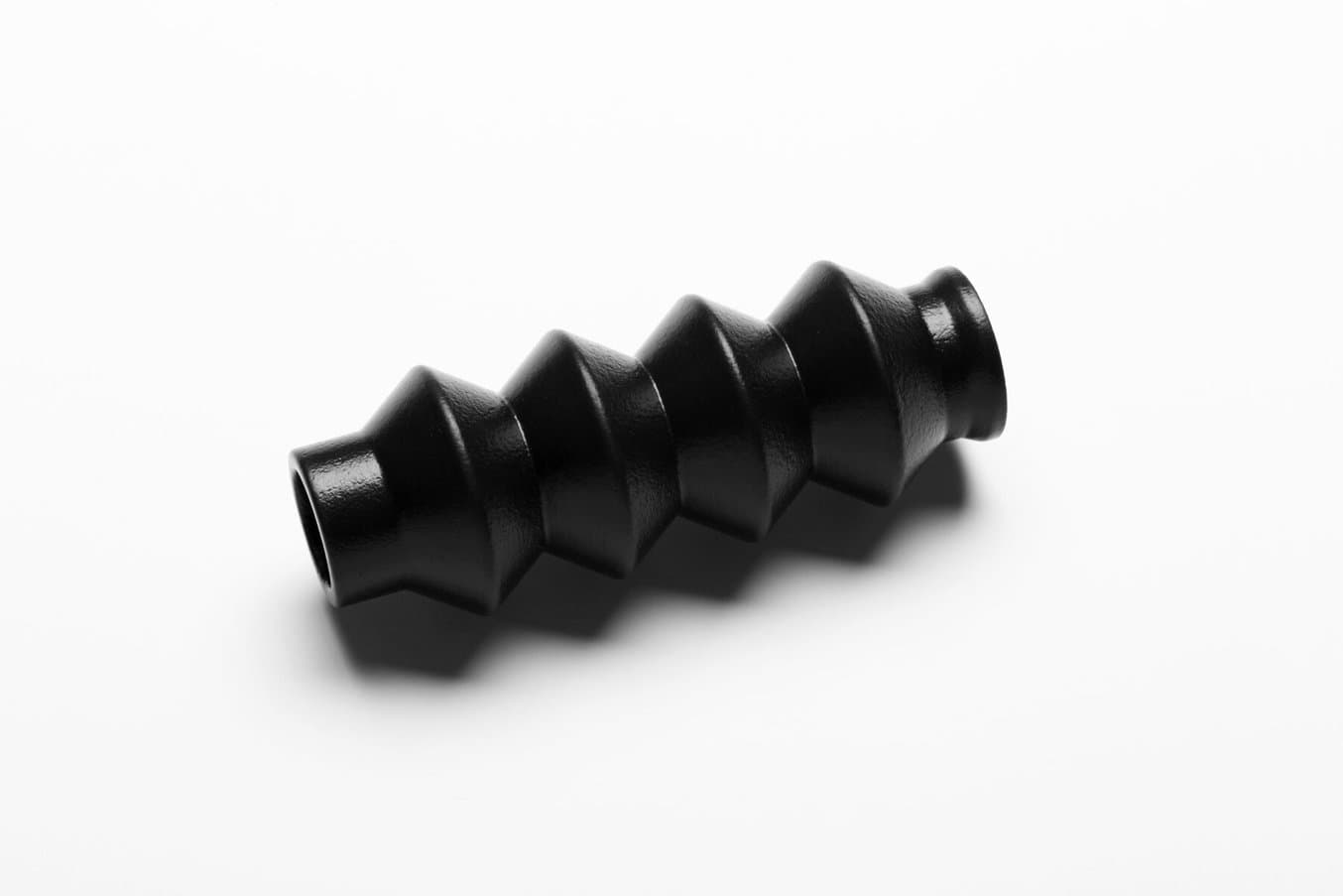

vapor smoothed
Vapor smoothing can benefit automotive components like this flexible SLS 3D printed boot.

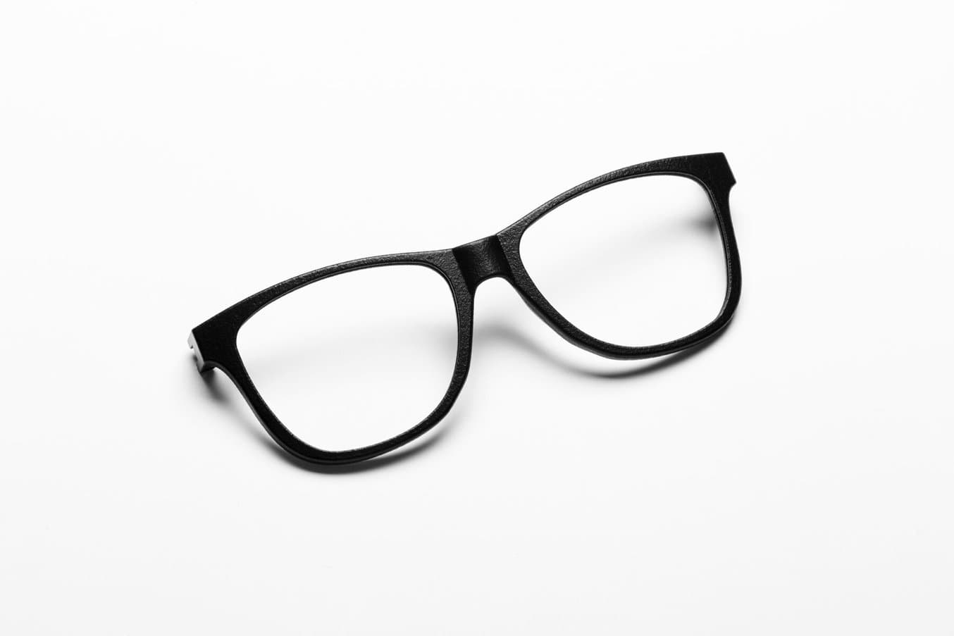

vapor smoothed eyewear frames
Eyewear frames can be more comfortable for the wearer when vapor smoothed.

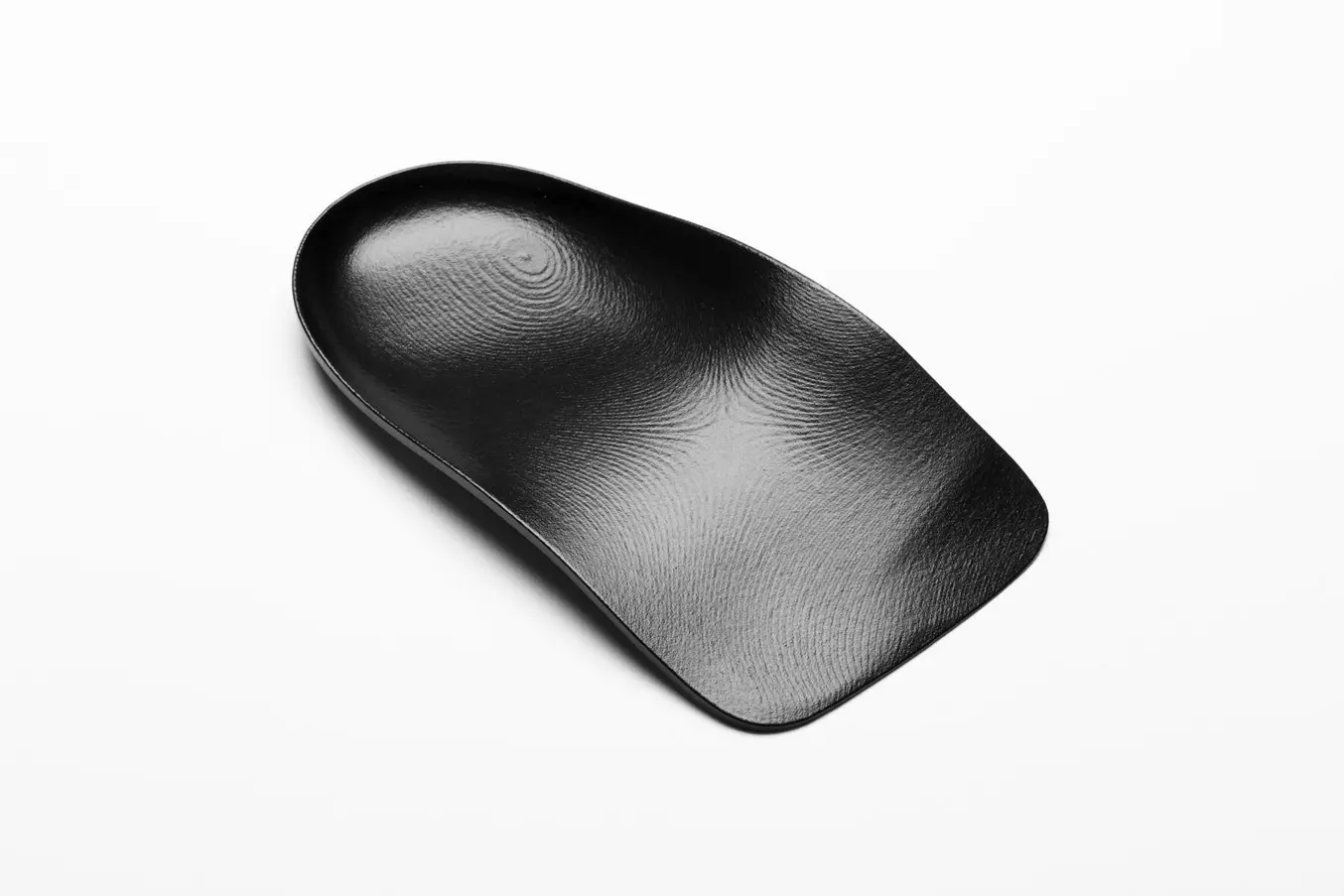

vapor smoothed orthotic insole
SLS 3D printed orthotic insoles can be vapor smoothed for added comfort and aesthetic benefits.
