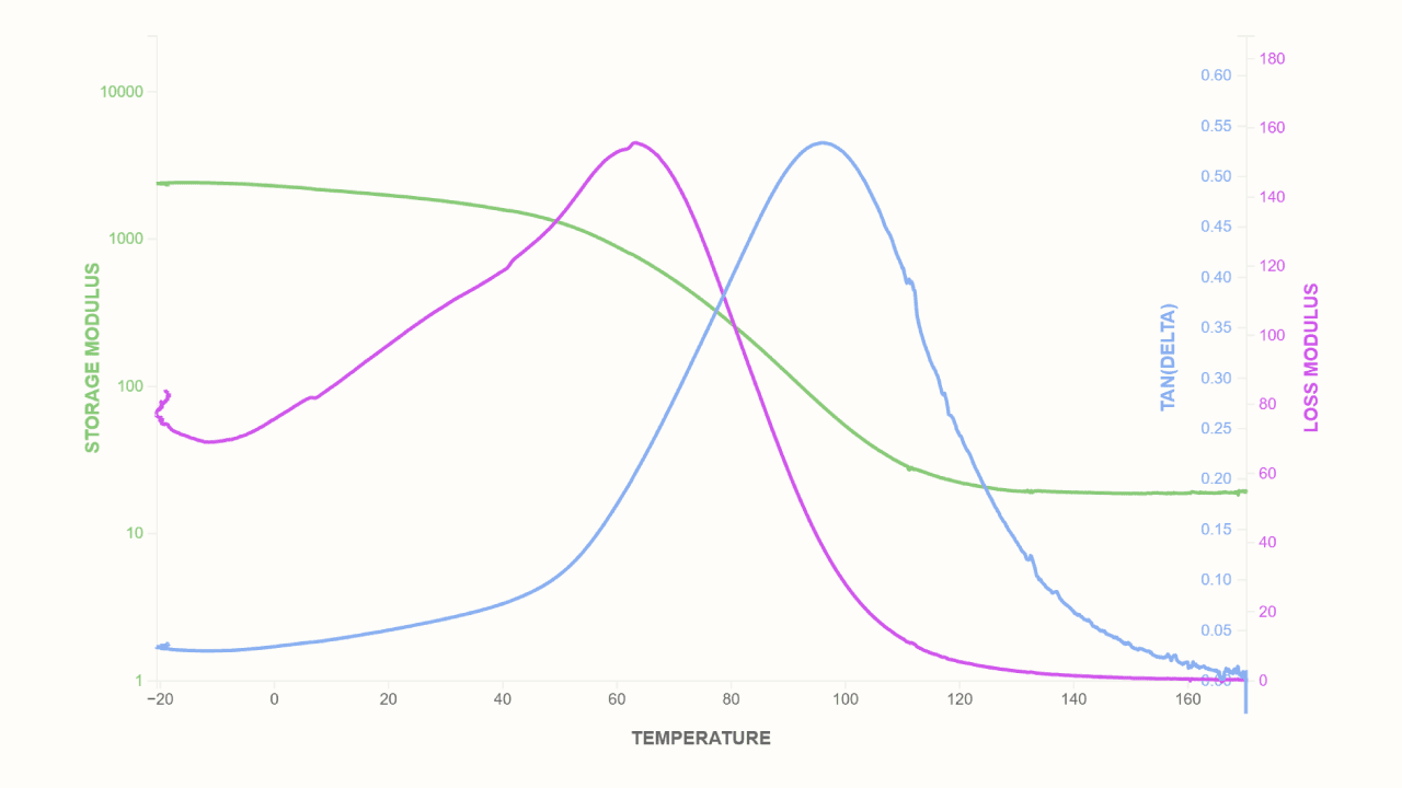

Dynamic Mechanical Analysis (DMA)
DMA was performed using a TA Q800 with dual cantilever clamps from -20°C to 170°C using a heating rate of 3°C/min. Samples were prepared following the Default post-processing workflow. The resulting curve characterizes the material’s viscoelastic response over the temperature range and indentifies the glass transition (Tg).

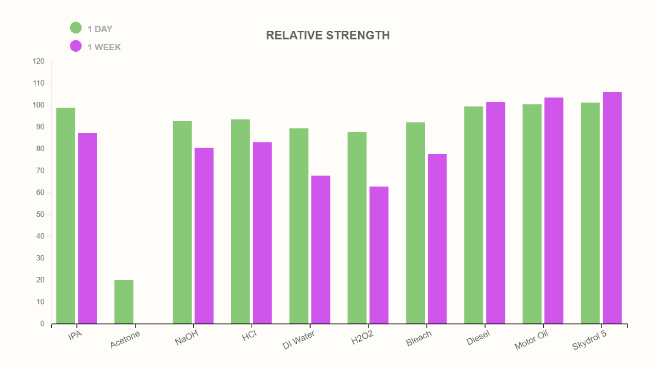

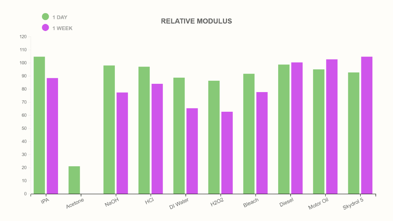

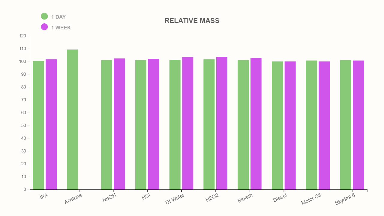

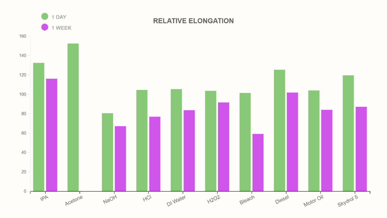

Chemical Compatibility ASTM D543
Chemical resistance was evaluated according to ASTM D543. Samples were prepared following the Default post-processing workflow then fully immersed in test chemicals for durations of 1 day and 1 week. Following exposure, samples were manually wiped off and conditioned at 23°C and 50% RH for 24 hours. Mechanical testing was conducted per ASTM D638 (Type IV). Results are reported as the percentage change from non-exposed control samples. 4

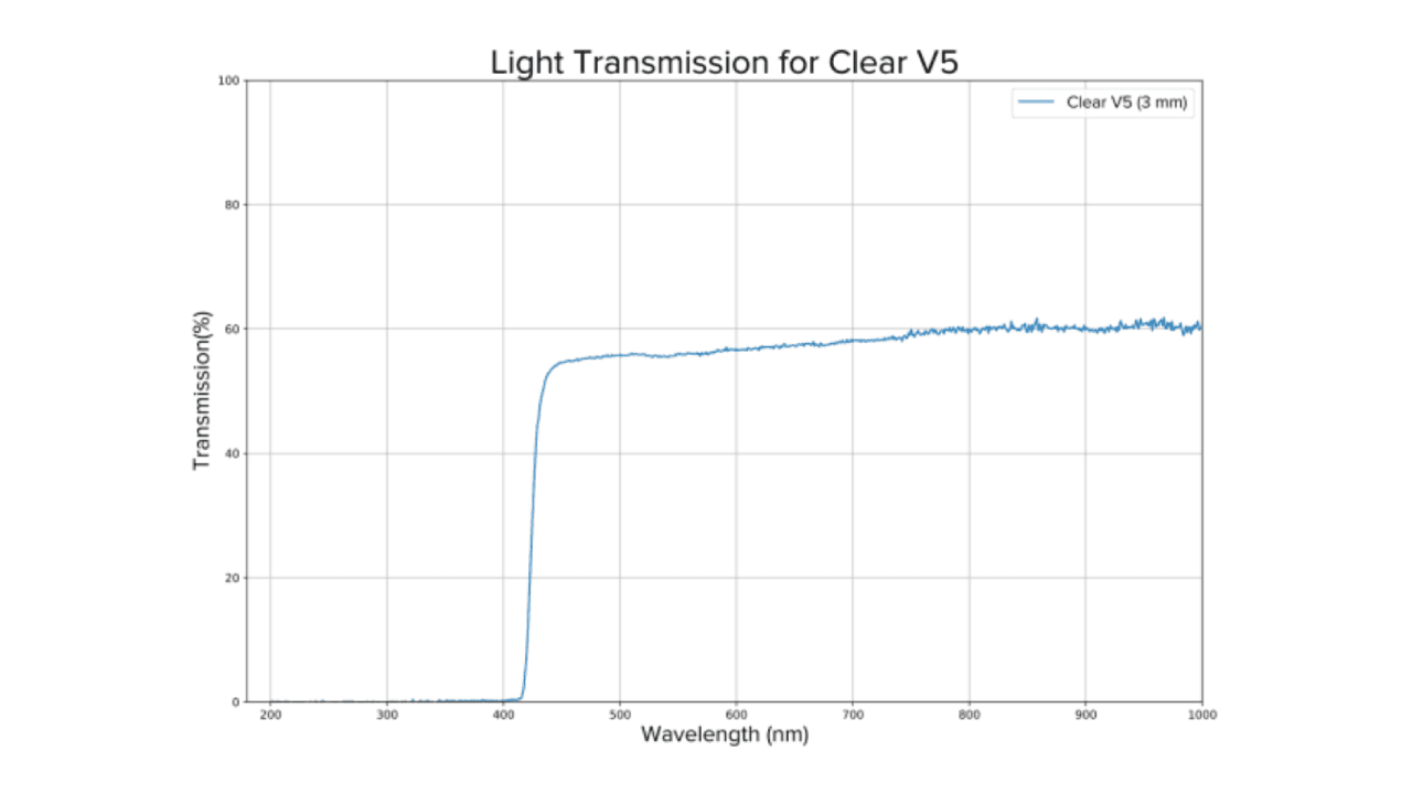

Light Transmission Curve
Transmission spectra were recorded from 200 nm to 1000 nm using a Varian Cary 50 Spectrophotometer. The 3 mm sample was prepared following the Default post-processing workflow.
