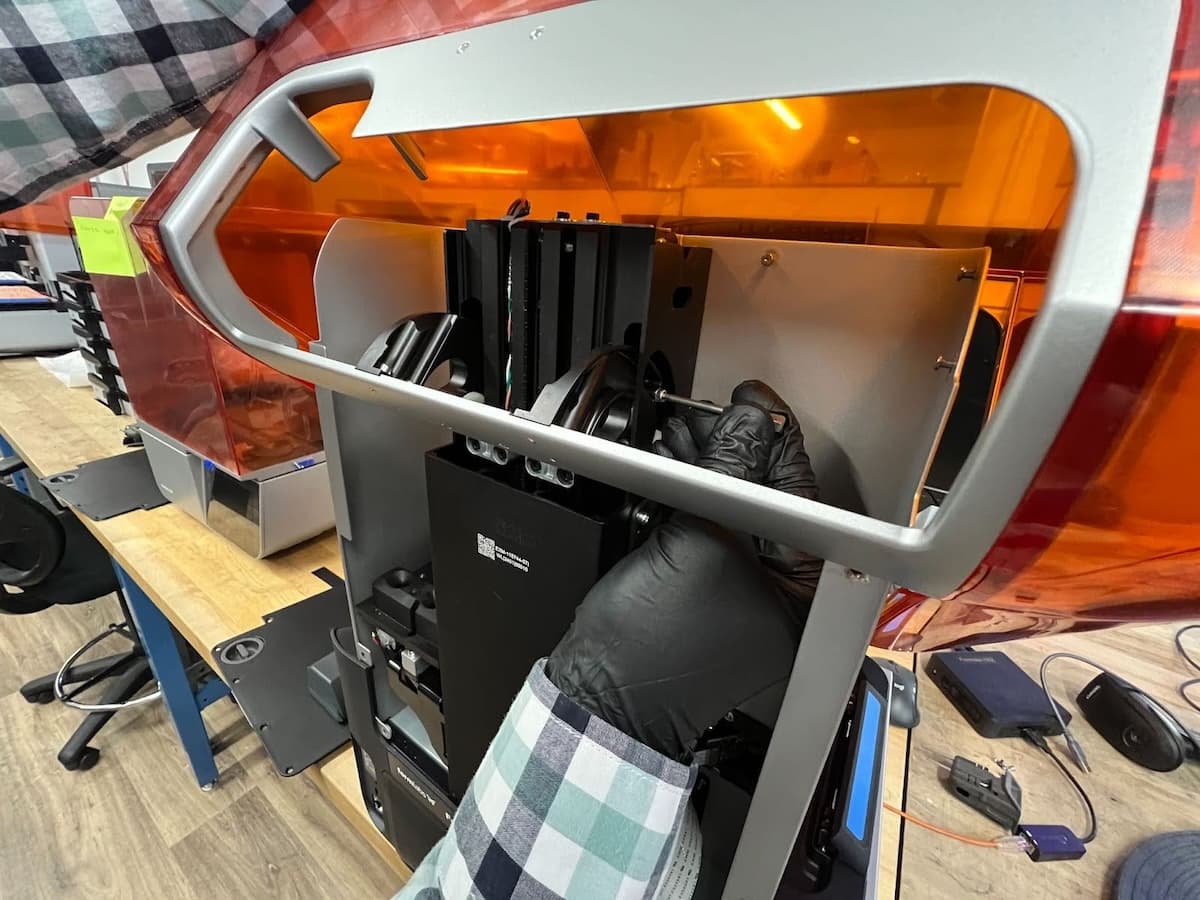

- Follow the instructions in the repair guide Replacing the Form 4 cover hinges to remove the back panel and access the hinges.

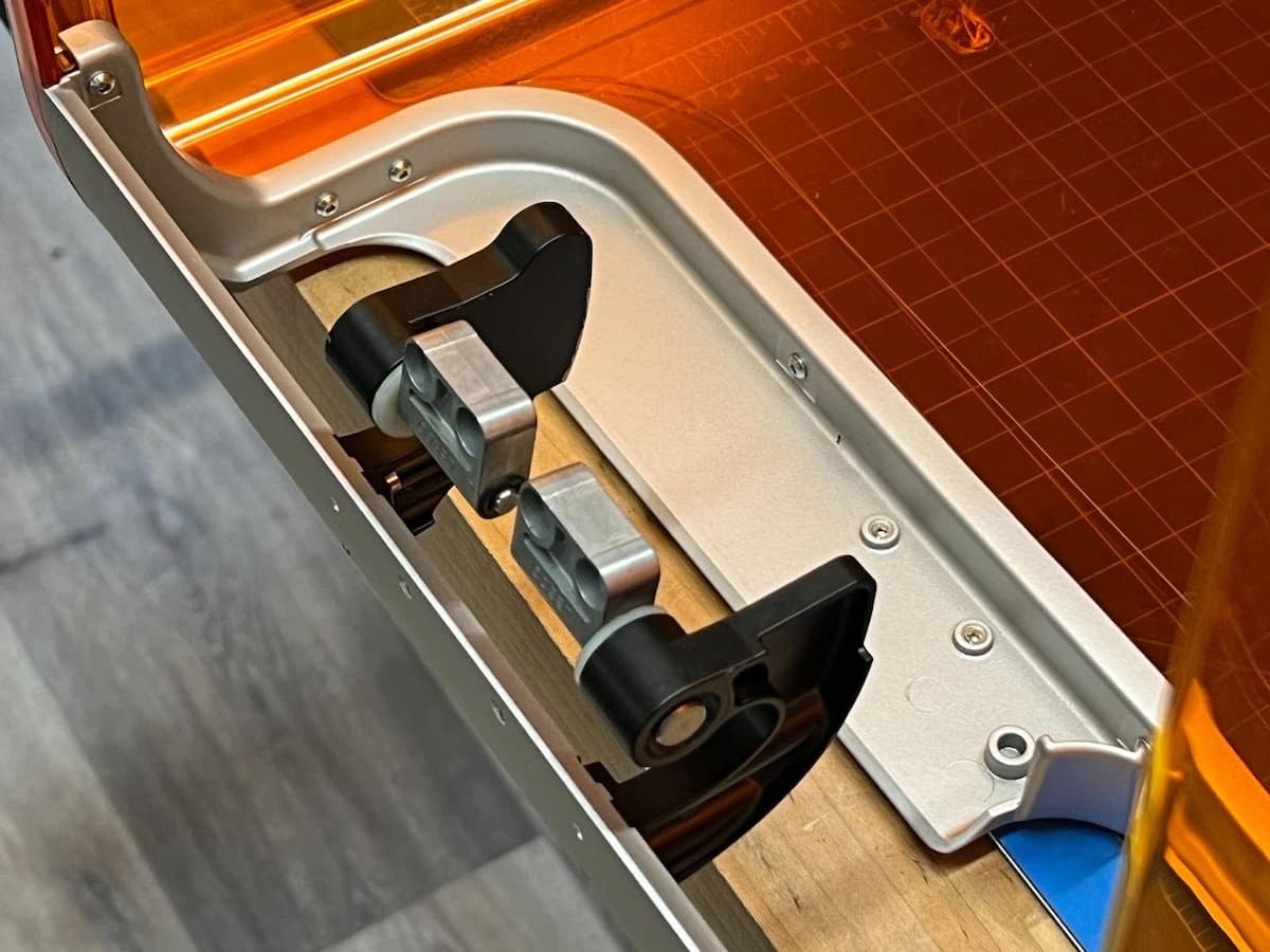

- If you have a set of replacement cover hinges, install them following the instructions in the repair guide Replacing the Form 4 cover hinges. The repair kit also includes new fasteners. If you also have a replacement cover damper, install it as well.

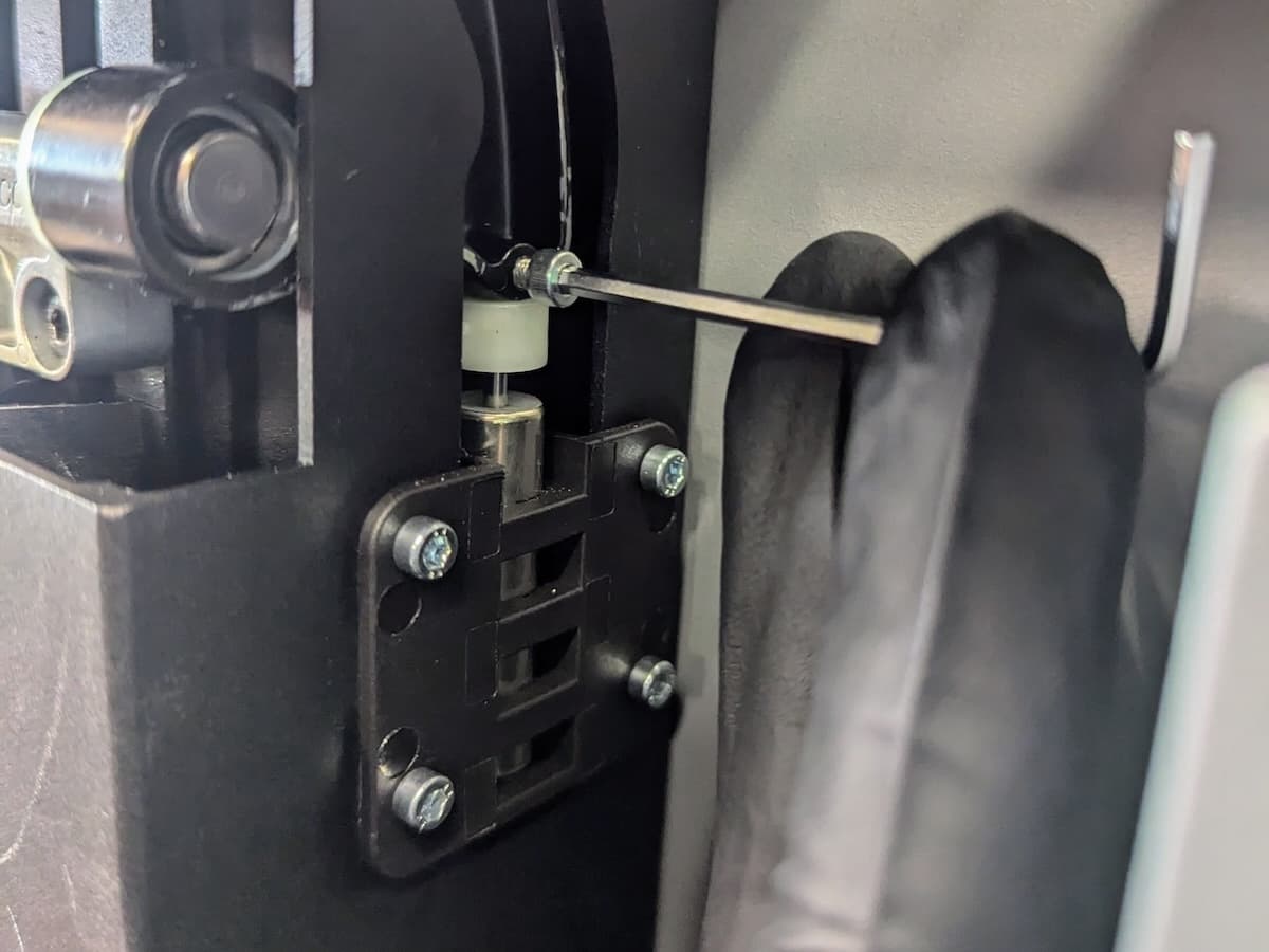

- If you do not yet have a set of replacement cover hinges, remove the cover hard stop screw. This allows the cover to open further than normal, helping it stay open. When facing the back of the printer, the hard stop screw is located on the right-hand cover hinge. Using a 2.5 mm hex driver, loosen and remove the hard stop screw. Be careful not to drop the screw into the Z-tower. Set the hard stop screw aside.
