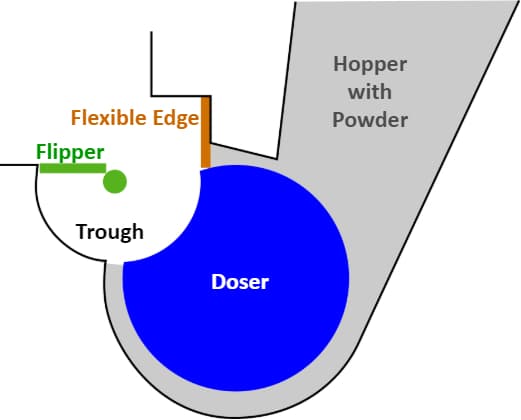

  1. Hopper flipper (on the right side of the print plane, near the powder hopper)
  2. Buffer flipper (on the left side of the print plane, opposite the powder hopper)
  3. Recoater
  4. Z-drive (drives the build chamber print bed up and down; marked as Cylinder in error codes)
  5. Doser

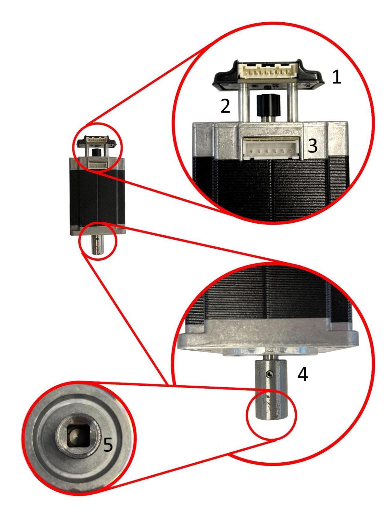

Large motor assemblies: flippers and recoater
Both flippers and the recoater are driven by the same motor assembly, shown below.
These motors feature:
  1. An encoder board mounted behind the end of the motor shaft
  2. A magnet on the end of the motor shaft
  3. A stepper motor (larger than the other motors in the printer)
  4. A spring pin that secures the coupler to the motor shaft
  5. A coupler that secures the motor to the square shaft of the component it drives
Fuse 1 generation flipper and recoater motor assembly

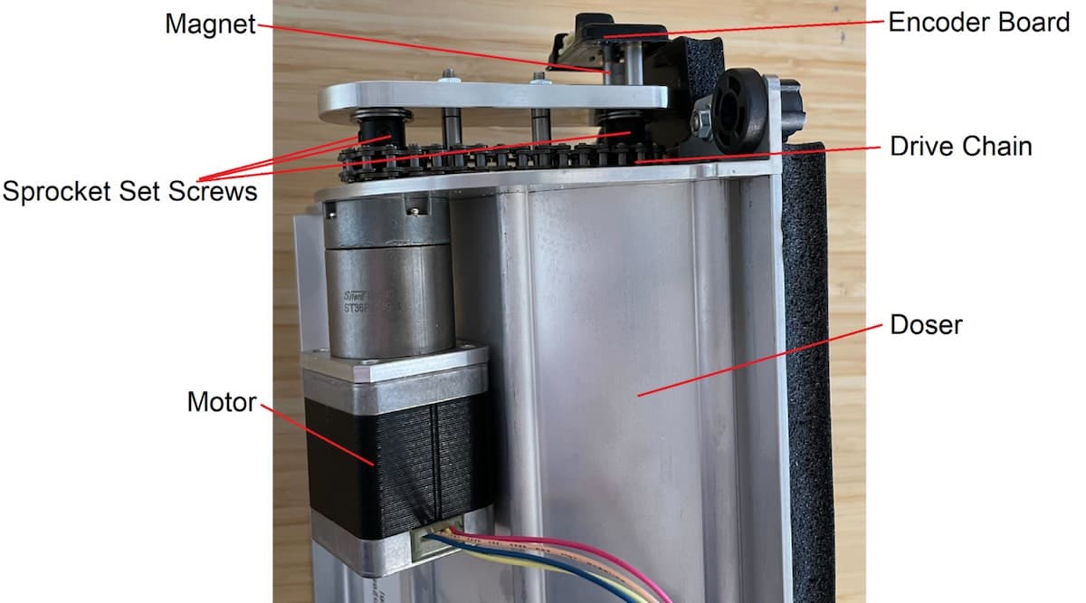

Doser motor
The doser is driven by a smaller motor with a sprocket attached to the motor shaft, which in turn drives a chain attached to the doser drum’s shaft. Unlike all other motors in Fuse 1 and Fuse 1+ 30W, the encoder board magnet is attached to the component’s shaft, not the motor shaft.
Fuse 1 generation doser motor assembly

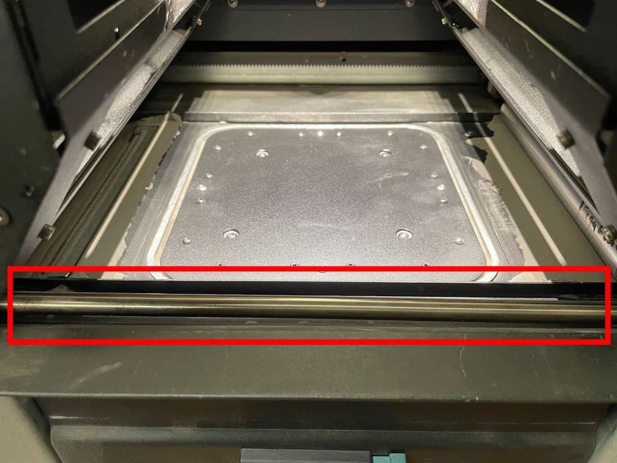

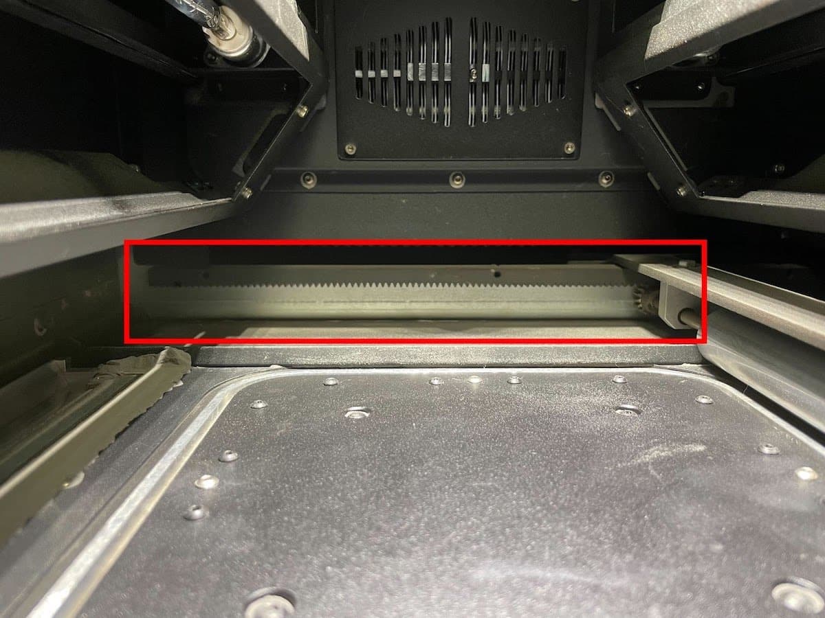

  1. Open the printer and inspect the recoater area, including:
    1. The roller
    2. The recoater rack and pinion gears (in the rear of the printer)
    3. The front linear rails
    4. The build chamber print bed
Fuse 1 generation recoater roller rack gear
Fuse 1 generation linear rail

      1. Closely inspect the rack gear in the rear of the printer for impacted powder. Use the picks provided with the Fuse Sift to remove any buildup, thoroughly cleaning each tooth.
      2. Remove the recoater roller and inspect the pinion gear on the roller assembly for impacted powder. Use the picks to clear any buildup, then reinstall the roller.
Fuse 1 generation recoater removed for cleaning

It can be challenging to observe the doser’s movement while the printer is full of powder. For cases that need detailed inspection of the doser assembly and doser motion, it may be necessary to empty the hopper and hopper trough area, if possible.
A diagram of the hopper, doser, and flipper assembly in a Fuse 1 generation printer
Hopper side flipper, doser, and hopper on a Fuse 1 generation printer. The flipper and doser are both in their home position.
Use the Motor Moves menu to drive the doser and hopper side flipper and evaluate their motion. Record a video.
  1. Move the hopper side flipper out of the doser drum’s range of motion. Moving it to or near its home position works well.

  7. If the doser moves erratically but you do not see an obstruction, the encoder board may be defective or a component on the drive train may be slipping.
    1. Reseat the doser motor encoder board cable.
    2. If reseating the doser encoder board does not resolve the issue, you may need to replace the doser assembly. Fuse 1 and Fuse 1+ 30W doser assemblies are available for purchase on the Formlabs Store.
