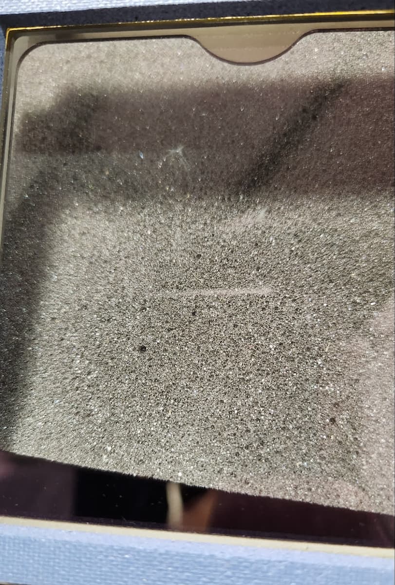

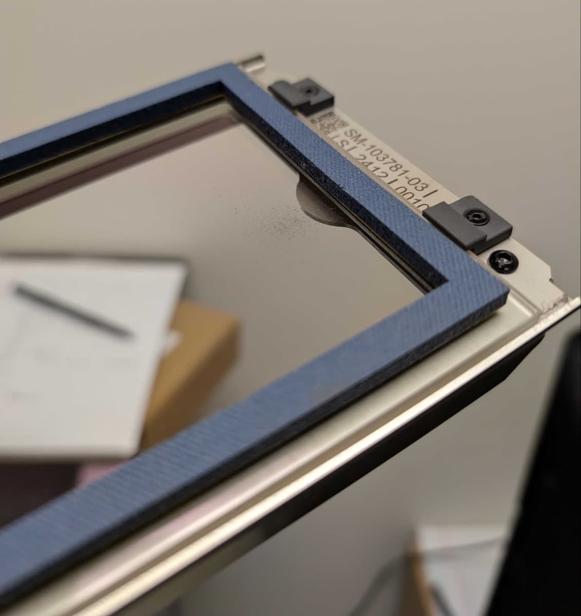

During normal operation, powder can accumulate on the bottom surface (i.e., the side facing the print enclosure) of the Fuse 1 generation optical cassette. As such, the standard cleaning procedure only involves cleaning that side of the cassette windows. Under some circumstances, powder can reach and settle on the top surface of the optical cassette. If there is powder there during a print, it can partially block the laser, leading to print failures and making the optical cassette harder to clean.

- Sintered powder on the top (gasket side) of the optical cassette
- Optics-related print issues, such as pitting

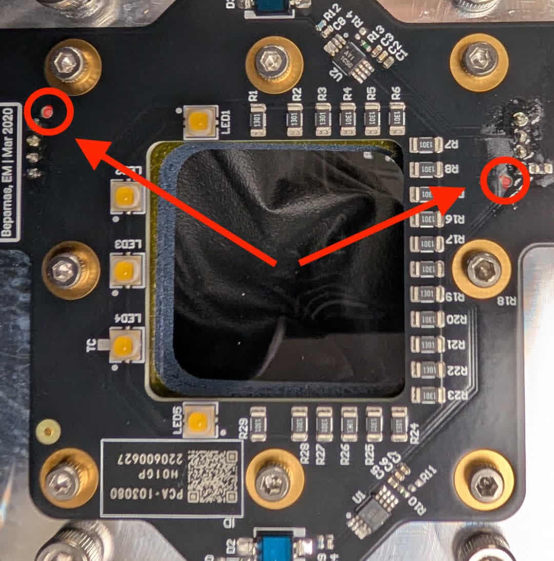

- The upper laser window has a variety of electronic components around the window itself. On some upper laser window assemblies, the holes for through-hole electronic components can be large enough to allow powder in the top of the printer to fall through onto the optical cassette below. These holes can safely be plugged to prevent further powder ingress.

- Open the print enclosure door, remove the optical cassette (if present), and locate the through-holes in the upper laser window, shown here. You can fill these holes with the upper laser window still in place or, for easier access, remove the upper laser window first.
- To remove the upper laser window, continue following the steps in the guide for replacing the upper laser window.
- Fill both holes with high temperature RTV silicone. Take care not to contaminate any other parts of the upper laser window.
