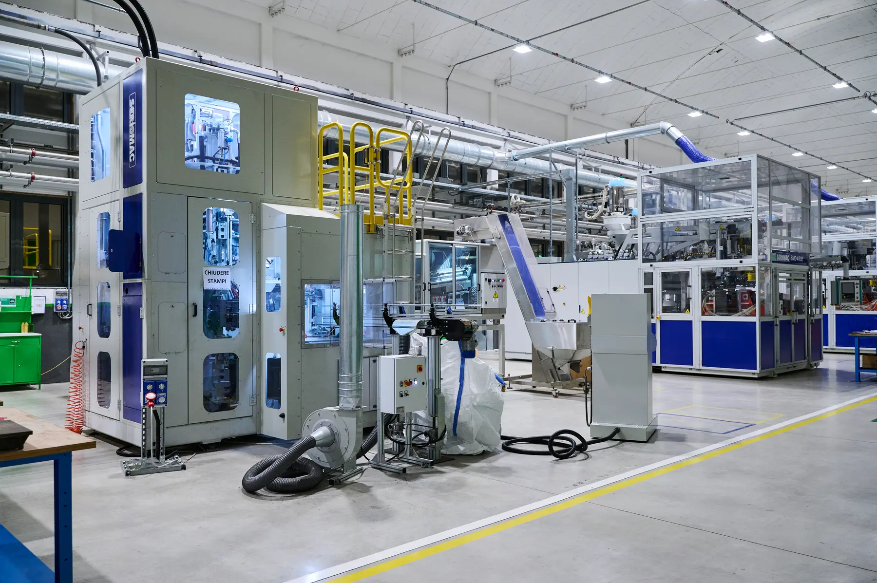

Industrial blow molding machines in Serioplast’s facility in Bergamo, Italy.

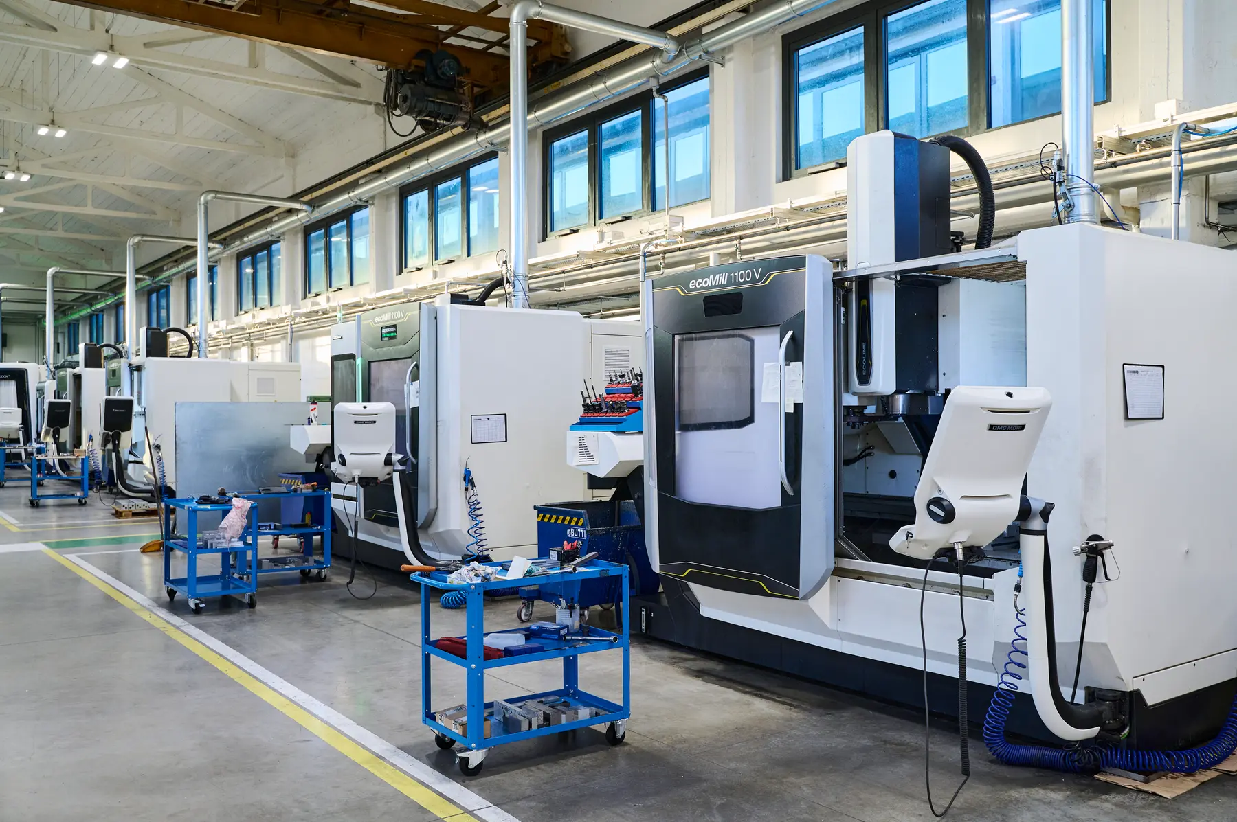

Typically, Serioplast would either directly 3D print mockups for prototypes or produce them through blow molding. Traditionally, 3D printed mockups didn’t represent the right feel or transparency and were not reliable enough to be sent to consumers. However, building production-quality samples through SBM requires expensive metal tooling, adding six to nine weeks of lead time to a typical pilot testing phase due to the complexity of the process and outsourcing the production of the mold. Even machining a metal mold in house normally takes six weeks as it requires several steps: lead time for material order, CAM and machine setup, manual polishing, and waiting time for machine availability.

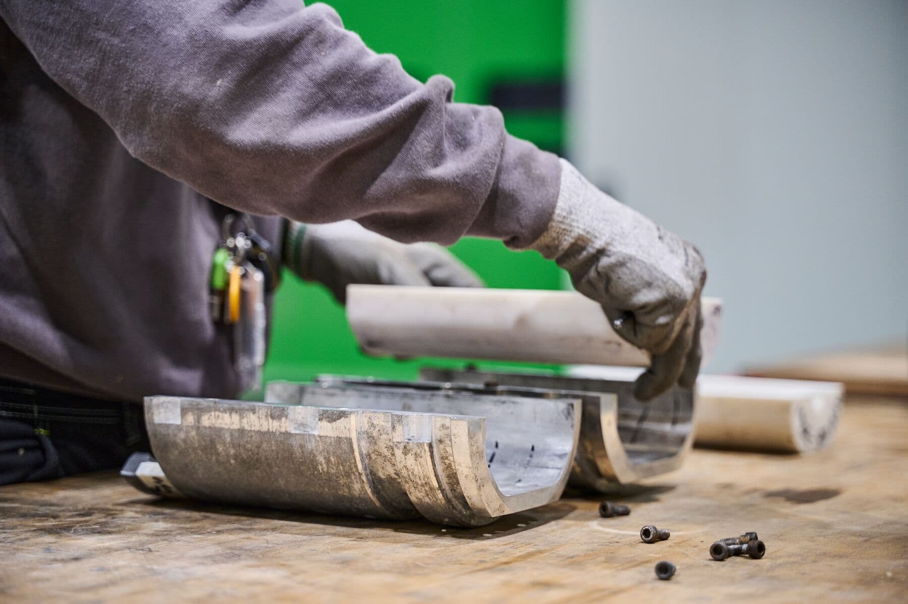

Serioplast’s tool manufacturing factory is equipped with CNC machines
Fabricated pilot and production tools in metal
Serioplast’s tool manufacturing factory is equipped with CNC machines (top) to fabricate pilot and production tools in metal (bottom).

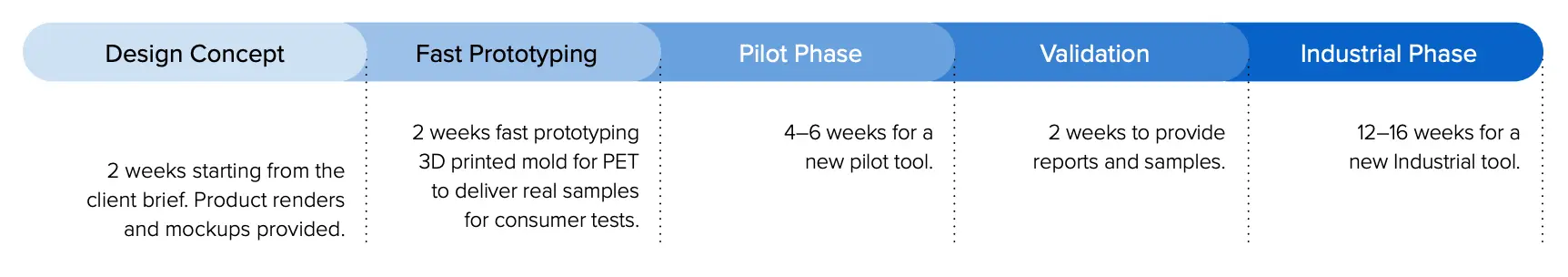

With 3D printing, a mold can be built in two days. 3D printed molds reduce the lead time to start pilot testing from six to two weeks while achieving realistic pre-production parts that are very close to production quality and molded using the same material and machinery as the eventual production units. Additionally, 3D printed molds allow operators to pilot-test multiple designs simultaneously.
Project timeline to fulfill a typical order
Project timeline to fulfill a typical order.
For one client seeking to test four different designs, Serioplast was able to produce 200 units of each design in only one month. Running such extensive testing with traditional methods is almost impossible. They would need to invest in a metal mold for each design without the benefits of economies of scale and would never recover tooling costs.

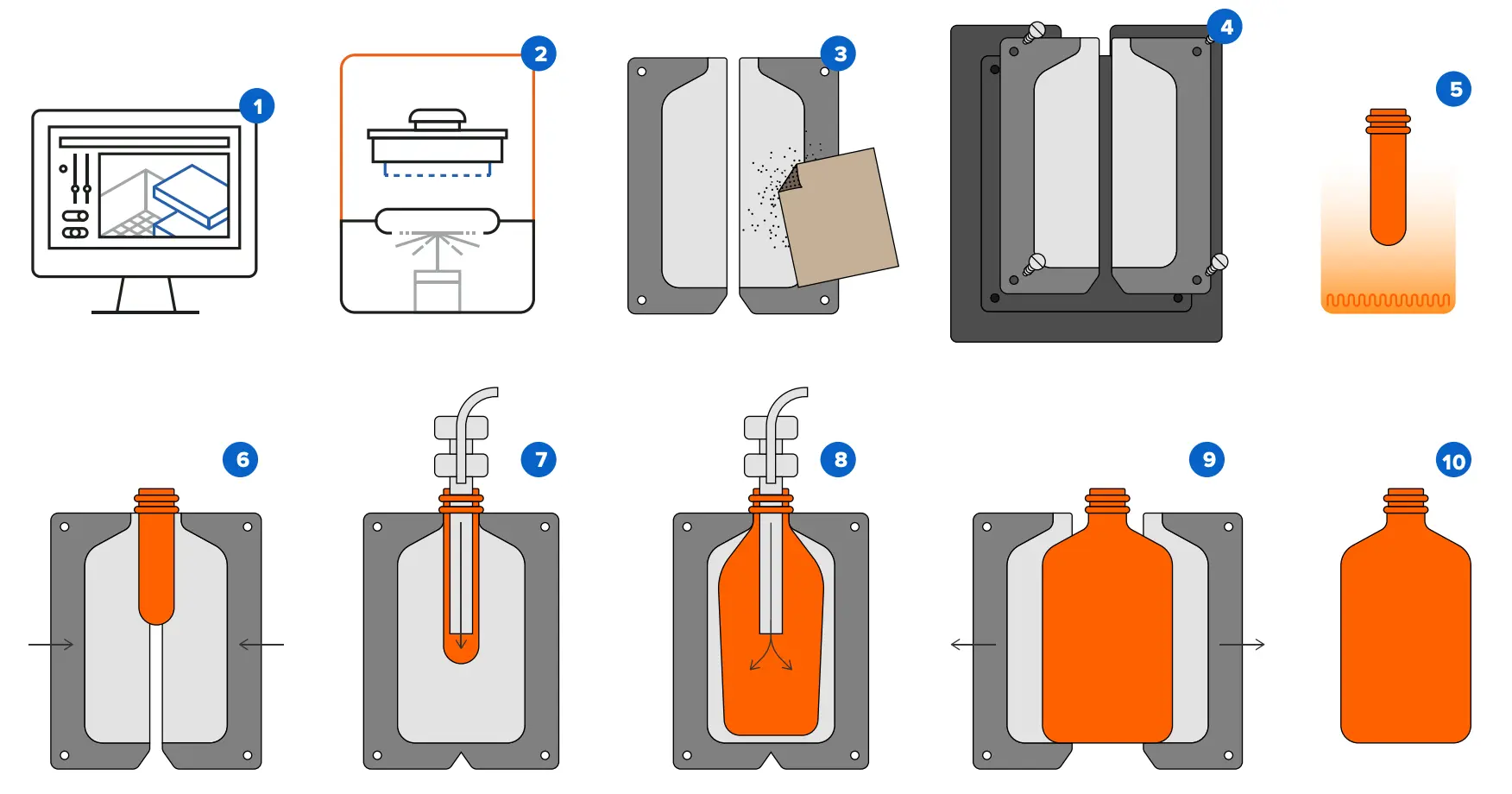

Process Overview
blow molding process overview
1. Mold design
2. Mold 3D printing
3. Mold post-processing
4. Mold assembly
5. Injection molded preform heated
6. Preform secured into blow mold
7. Preform stretched with core rod
8. Compressed air is blown in and preform inflates to mold
9. Product is removed from mold
10. Finish product

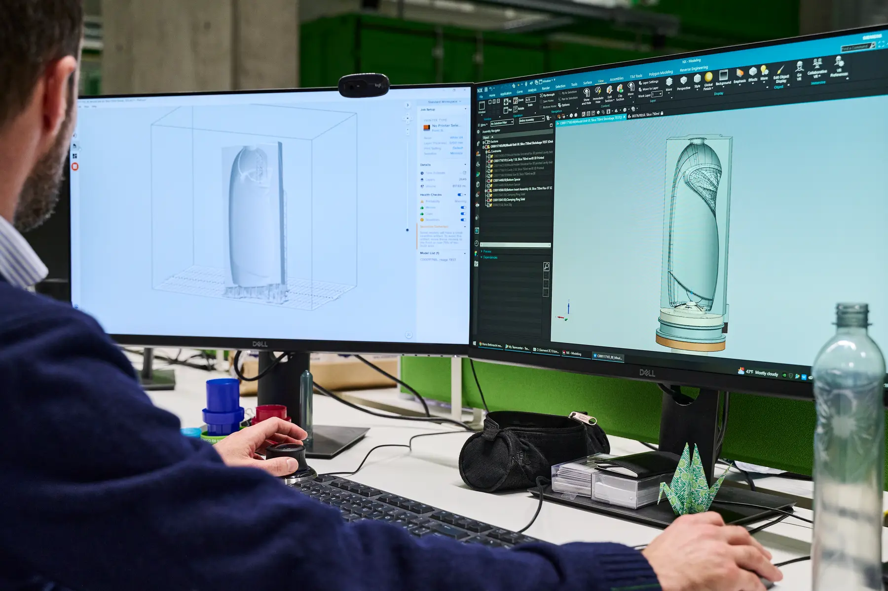

CAD model of the mold and STL file loaded in PreForm software

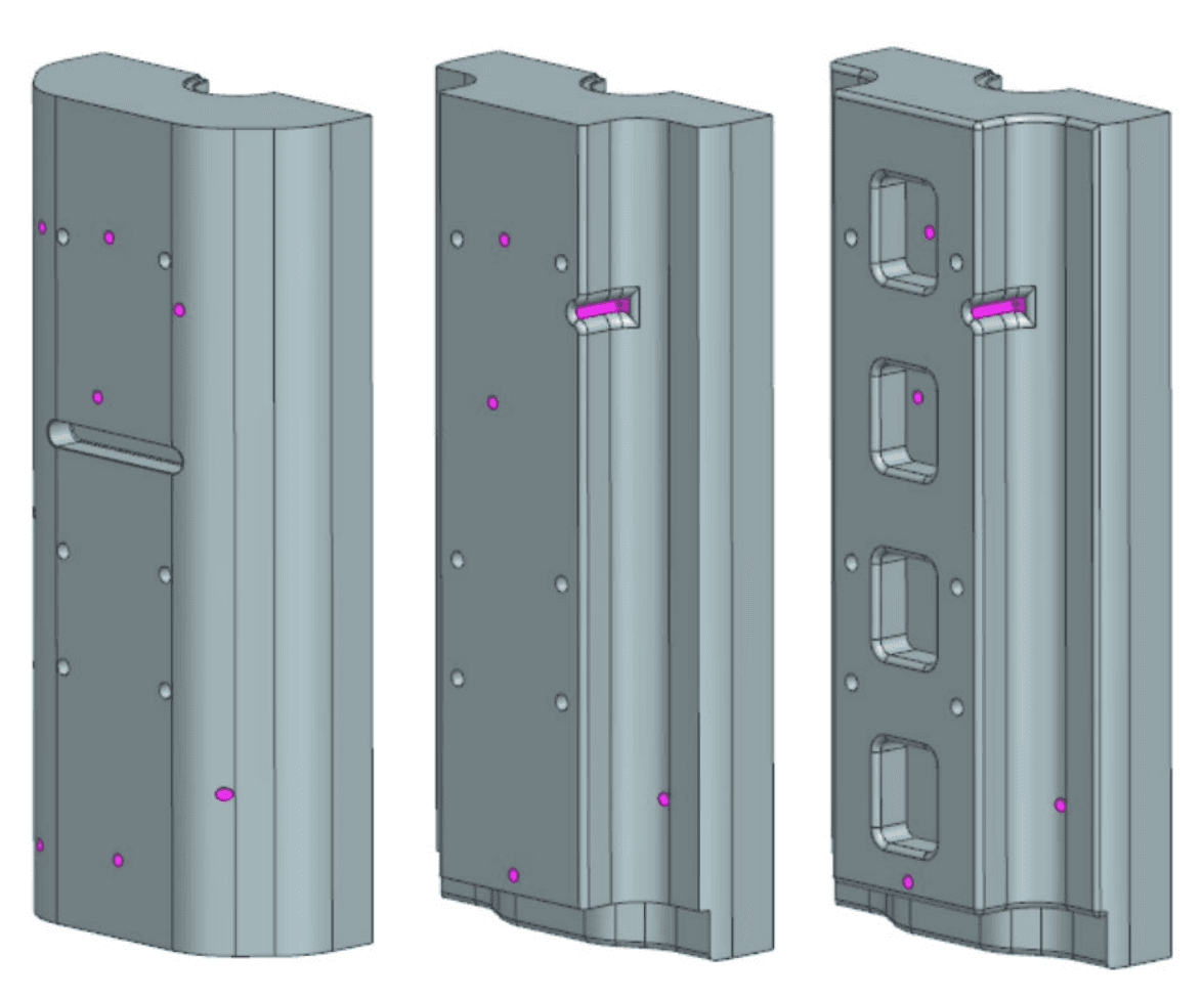

The team investigated the influence of the cavity design and print settings on the dimensional accuracy and planarity of the printed mold. In the first step of CAD design, they found that removing material on the back of the cavity reduces the risks of deformations, material cost, and printing time.

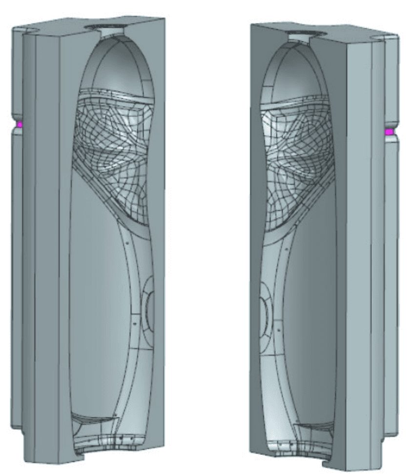

CAD design of the 3D printed mold
CAD design of the 3D printed mold assembly with the cavity back (left) cavity operator side (right), and bottom insert (bottom).
CAD design of the mold
Iterations on the CAD design of the mold starting from a solid block to guarantee robustness (left), to a block with removed unnecessary area not in contact with the shell holder (middle), to the final design with further slots added to decrease weight and material distortion (right).

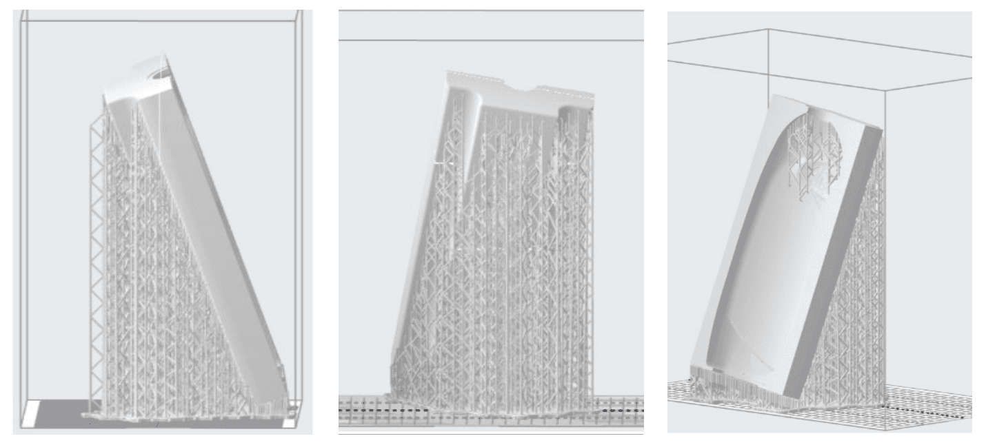

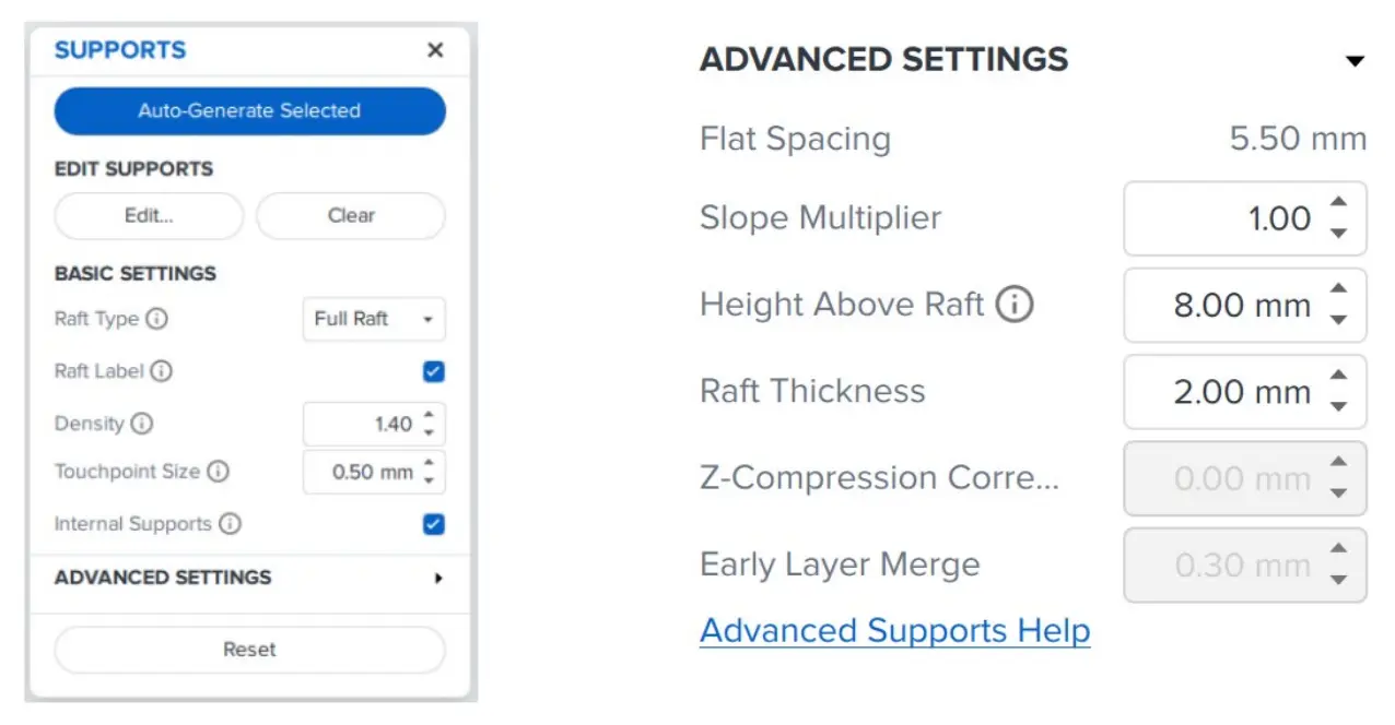

The print preparation in PreForm software is key to the success of the 3D printed mold. By finetuning the print settings, it is possible to maximize dimensional accuracy and planarity. For this project, they tilted the part by 30° along the z-axis, 20° along the X-axis, and 10° along the Y-axis. The orientation is optimized to minimize supports inside the cavity, avoid laser printing parting lines on the figure, and keep enough strength in the supporting.
Print settings used by Serioplast
Print settings used by Serioplast in the PreForm print preparation software.
A mold half in PreForm print preparation software
Once the Serioplast team has a standard mold design and print preparation they only need to modify the cavity for each new bottle design. It takes at most two working days to prepare, whereas designing a standard metal mold can take more than two to three weeks. Textures and surface finish can also be directly implemented in the CAD model.

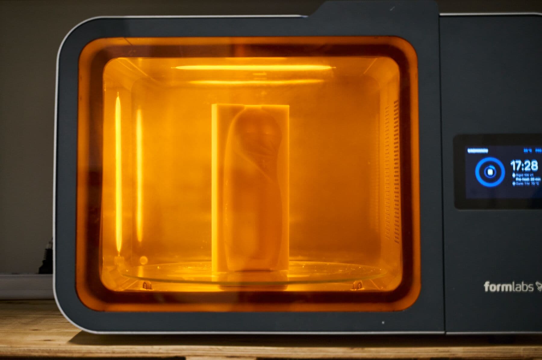

3D Printing the Mold
The next key step is choosing the right resin for 3D printing. The Serioplast team needed a material that could withstand the internal pressure and the temperature of the SBM process while showing good dimensional accuracy and stability. Rigid 10K Resin is Formlabs' recommended material for SBM as it combines strength, stiffness, and thermal resistance. It is an industrialgrade, highly glass-filled material with an HDT of 218°C @ 0.45 MPa and a tensile modulus of 10,000 MPa. Tooling printed with Rigid 10K Resin has good dimensional stability and is suitable for hundreds of blow molding cycles with high repeatability.
With Unilever’s 750 mL bottle design, one mold half requires 776.54 mL of resin and 25 hours to print at 100-micron layer heights. Each cavity is built separately to limit the deformation.

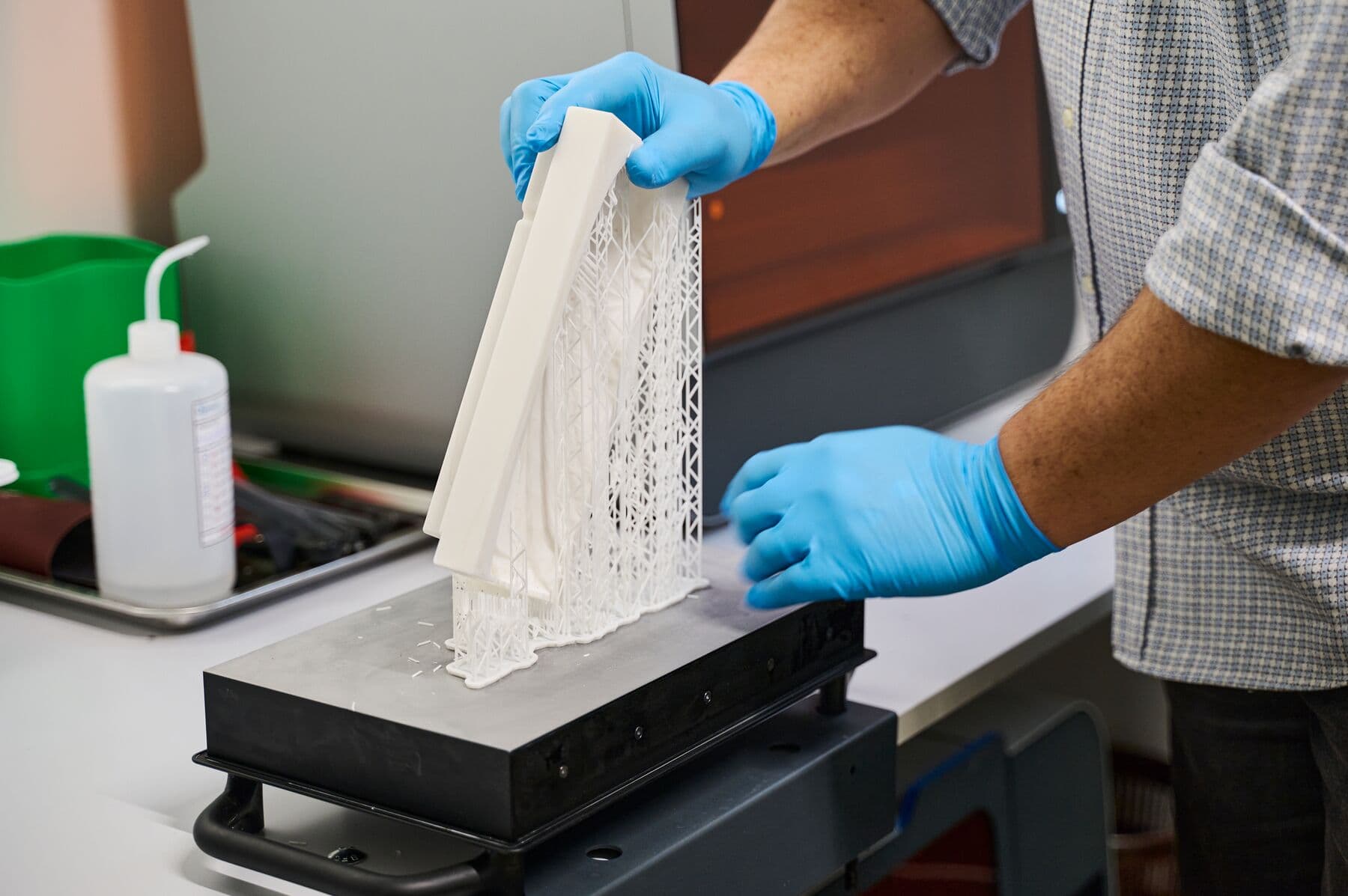

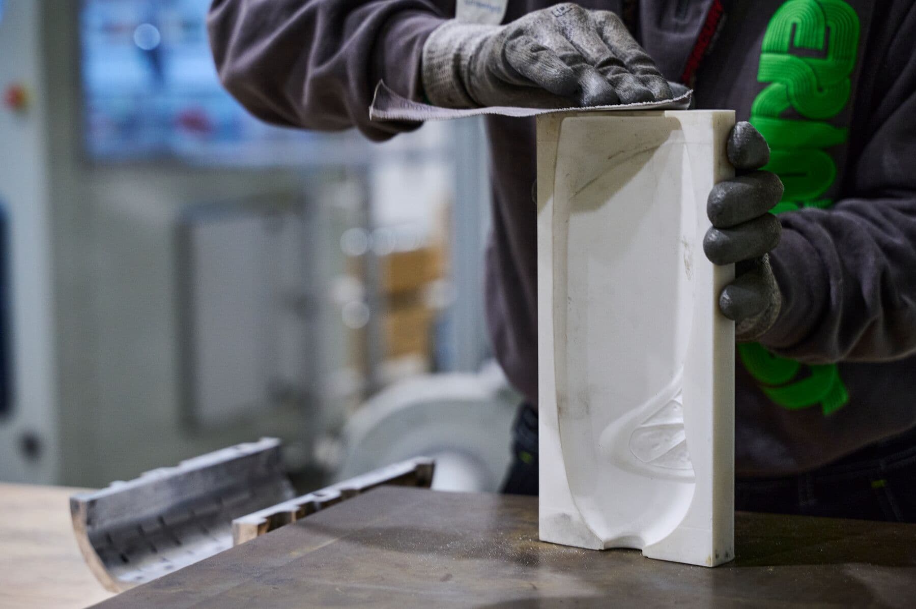

After printing, the parts are washed in IPA twice for 10 minutes, dried with compressed air if available, and post-cured at 70 °C for 60 minutes following Formlabs instructions. Alternatively, the parts can be heated in a non-food oven at 90 °C for 125 minutes for a higher HDT.
Rigid 10K Resin prints can be wiped with mineral oil to remove any excess powdery glass particles, and media blasted to improve the surface quality and mechanical properties.
Serioplast printing
Serioplast printing
Serioplast printing
Serioplast printing

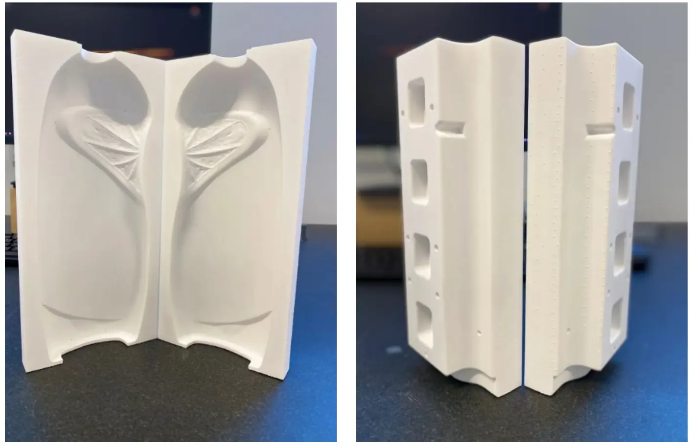

The mold is 3D printed on the Form 3L with Rigid 10K Resin. After washing, the supports are removed and the mold is post-cured.
Serioplast Rigid 10K Resin mold
By using Rigid 10K Resin, Serioplast obtained precise molds with smooth surface finish, capable of integrating fine features, including holes as small as 0.5 mm. They post-processed the tool with a polishing machine or manual sanding to meet the critical dimensions. Textured surfaces were incorporated in the CAD of the mold cavity.
The final dimensions differ slightly from the theoretical dimensions; further study might help to predict the printed plastic’s behavior in order to match the project specifications.

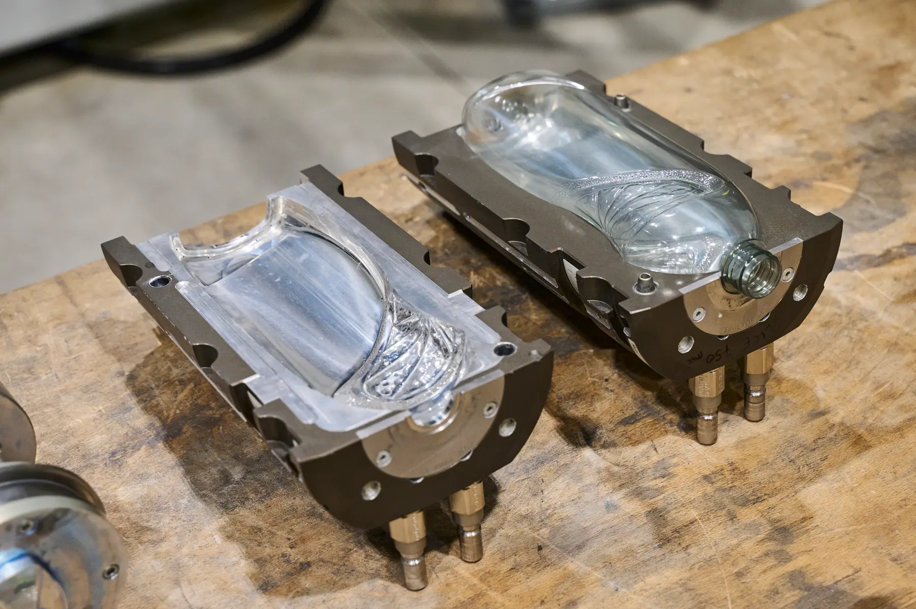

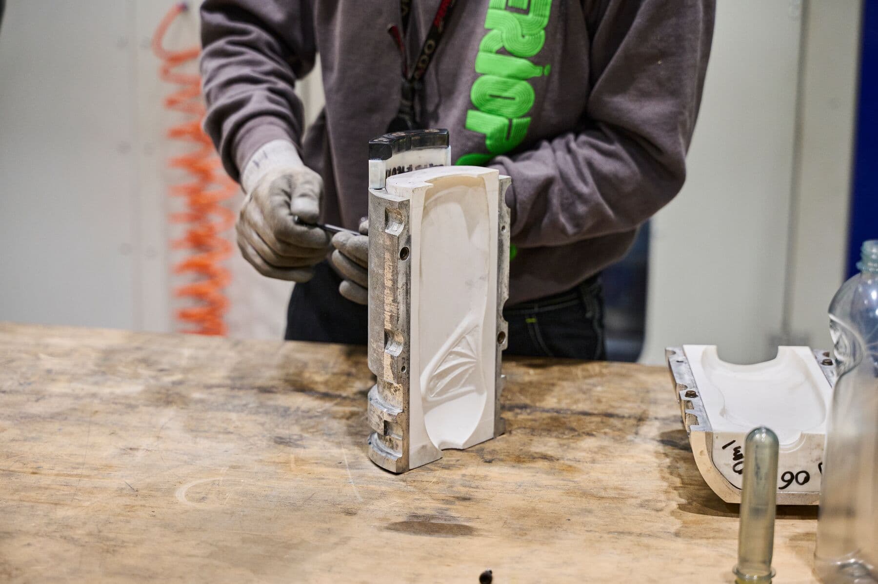

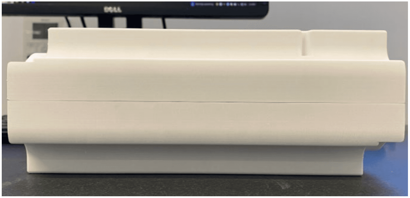

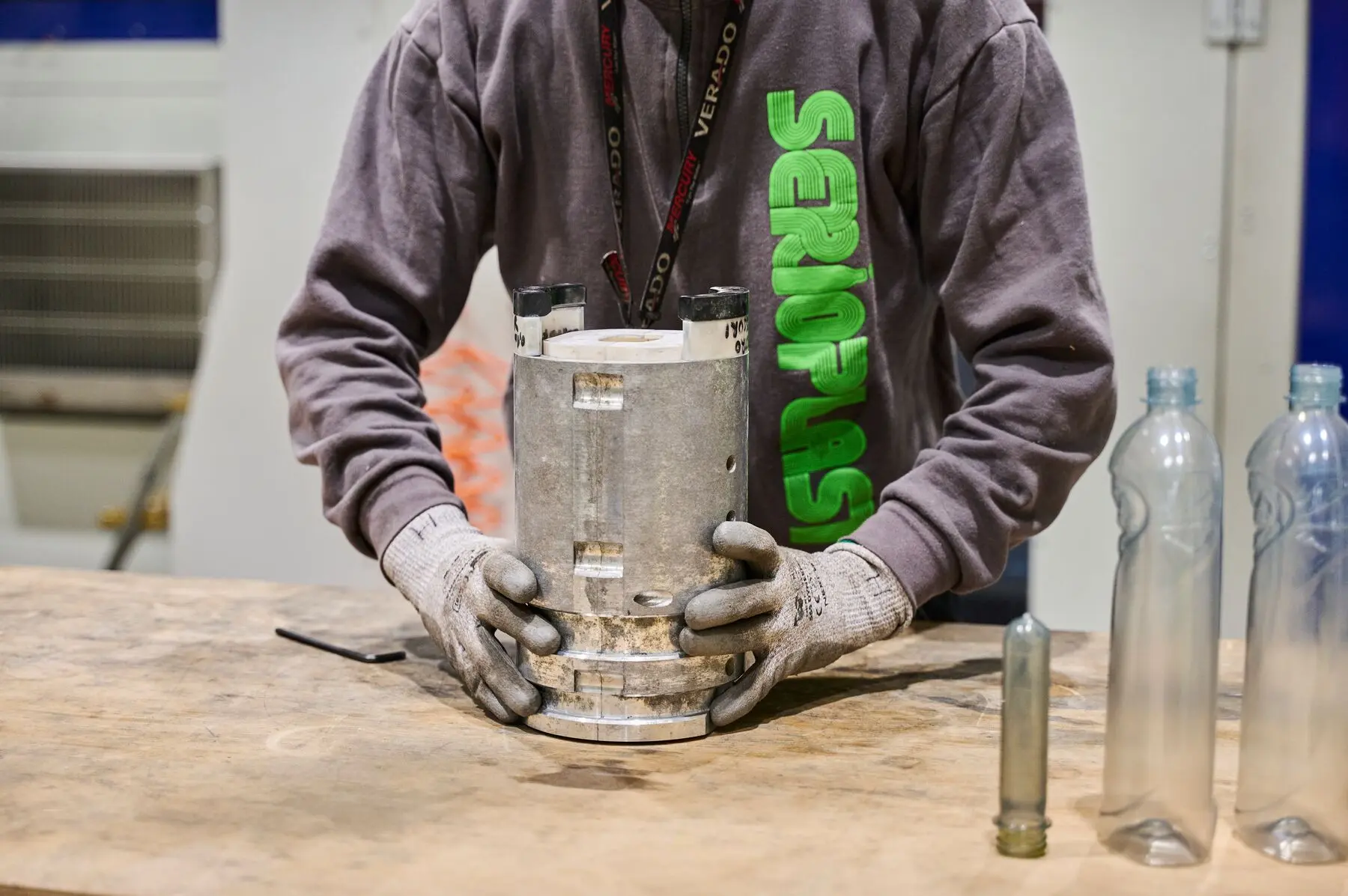

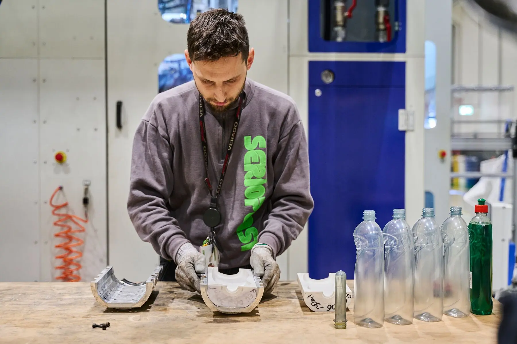

Once the cavity is printed and post-processed, it is assembled into a metal frame and then placed inside a shell holder that is already installed on the machine for a quick changeover. This metal frame was custom-made for 3D printed molds and can now be reused for each new cavity, it permits the reduction of the amount of resin needed on the 3D printed tool and it also helps absorb the forces in play.
mold 3D printed with Rigid 10K Resin
The mold 3D printed with Rigid 10K Resin is manually polished and then assembled into a metal frame.
With this tool assembly, Unilever and Serioplast have a solution for producing a modular SBM mold, that can accept different shapes as their product portfolio evolves. They ran the trial on their Seriomac UNIX 4 Cavities industrial SBM machine, which is the model they use for production.

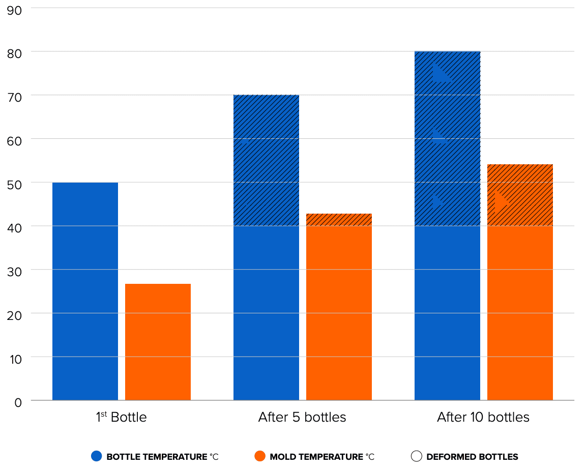

The temperature is another parameter to consider. With 3D printed molds, Serioplast processed mostly PET, from virgin to up to 100% recycled, which is usually blown at 100 °C. While this temperature does not threaten the integrity of the printed mold itself, it can alter the transformation of the preform and compromise the final bottle. If the temperature of the mold is too high, then the bottle may shrink in an unpredicted way and not meet the dimensional specifications. In a traditional metal mold, water cooling channels usually cool down the cavity to avoid that.
In 3D printed polymeric tools cooling channels require extra time for design and cleaning and are not as efficient as in a metal tool because heat transfer occurs slower. It is the user’s choice to increase the time for design or cooling. For reference, the Industrial Technical Center IPC studied the impact of adding a regulation system on a 3D printed thermoforming tool in a previous report.
Instead of adding cooling channels, Serioplast operated trials while monitoring the mold temperature. They found that letting the mold cool down for at least four minutes between each shot was a simple way to maintain the temperature to about 40 °C. Compressed nitrogen can help speed up the cooling process but they found that for large series it is not worth the manual work.
Evolution of the 3D printed mold temperature
Evolution of the 3D printed mold temperature with increasing the number of cycles. The team made some trials during which they measured the temperature of the mold cavity after each cycle with a thermal scan. The bottle temperature started at 50 °C at the first cycle, after five cycles the temperature rose to 70 °C and the bottles started to deform, and after 10 cycles the temperature reached 80 °C.

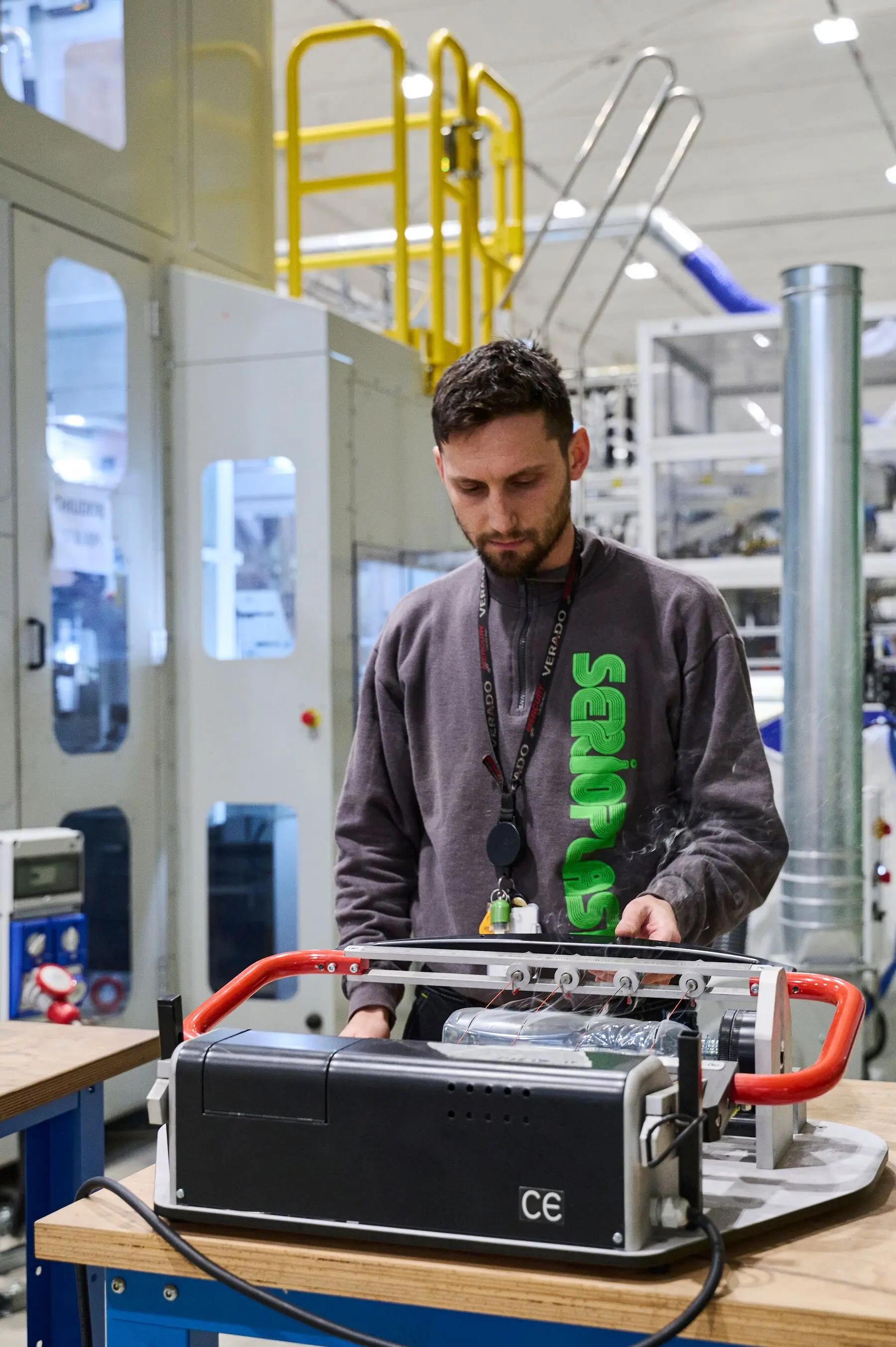

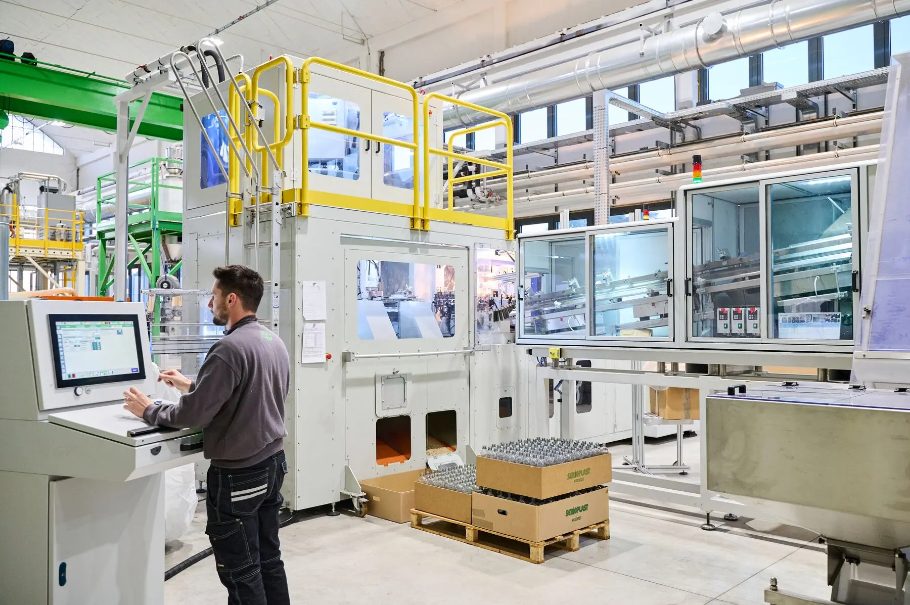

Seriomac UNIX 4 Cavities SBM machine
Seriomac UNIX 4 Cavities SBM machine from Serioplast in their production facility in Italy.
Serioplast blew one preform on the machine every 48 spindles in order to increase the cooling time and maintain a 10-15 bottles per hour output. The table below reports the SBM configuration Serioplast used with 3D printed molds:
PARAMETER VALUE
Machine Seriomac UNIX 4 cavities
Material PET (virgin and up to 100% recycled)
Blow temperature 100 °C
Stretching rod speed 1,100 mm/s
Pre-blow pressure 3.5 bar
Blow pressure 24 - 30 bar
Cooling time 1.7 s

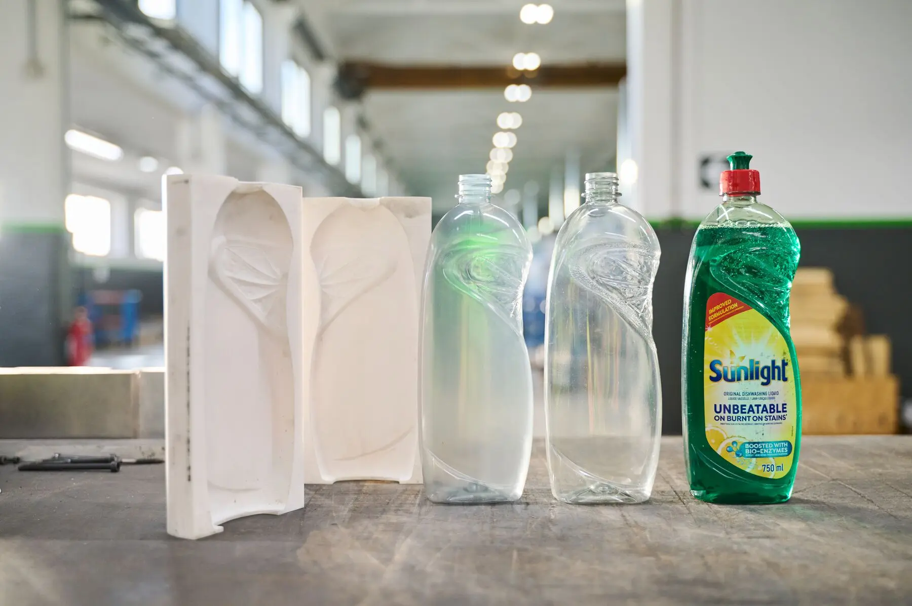

Serioplast tested about 15 different models of bottles, working on two to three design iterations for each. With one mold 3D printed with Rigid 10K Resin, Serioplast stretch blow molded about 200 units without breaking the mold. They did not observe any sign of breakage and they don’t expect the mold to crack under more cycles at these molding conditions. The cavity would most likely show more wear over time than a metal mold, but they did not perform any dimensional stability study at this point.
The bottles produced with the 3D printed mold were not as transparent as the ones formed with a metal tool because the metal mold goes through mirror polish finishing. However, the overall quality of the bottles was very close to production in terms of aesthetics and functionality, suitable to be considered as a final product for consumer testing.
two-part mold 3D printed with Rigid 10K Resin
From left to right: the two-part mold 3D printed with Rigid 10K Resin, a bottle produced with the mold 3D printed with Rigid 10K Resin, a bottle produced with a metal mold, and a labeled prototype bottle for customer testing.
bottles produced wit 3D printed mold

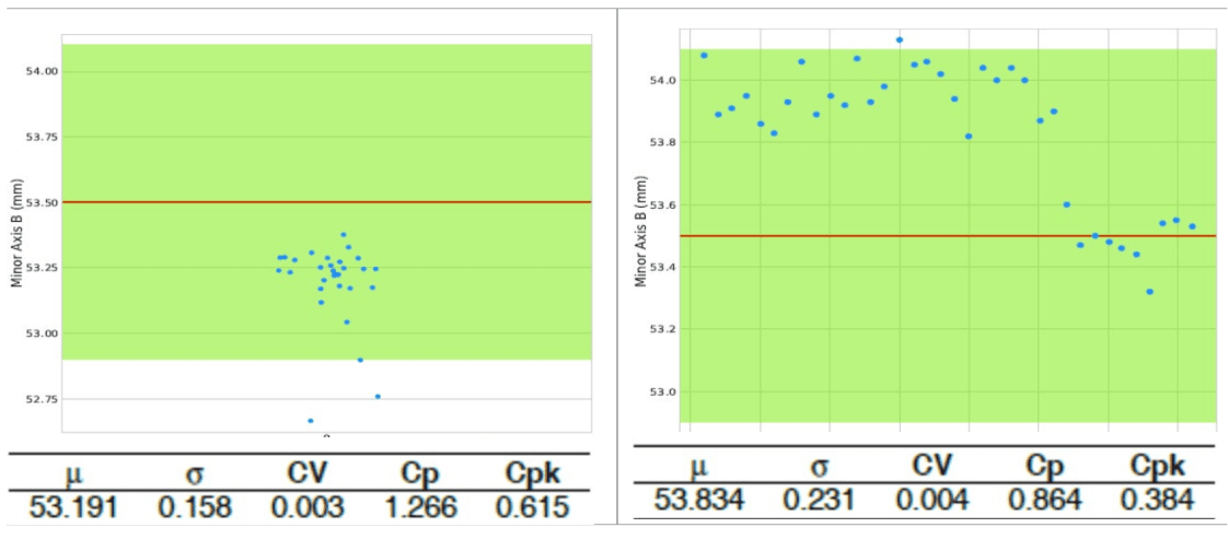

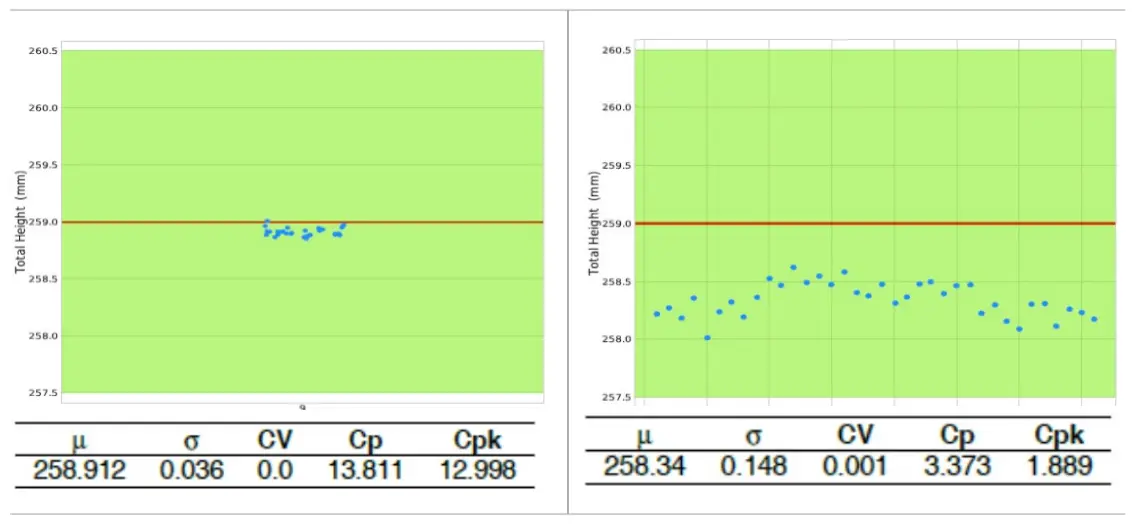

Dimensional Accuracy Analysis

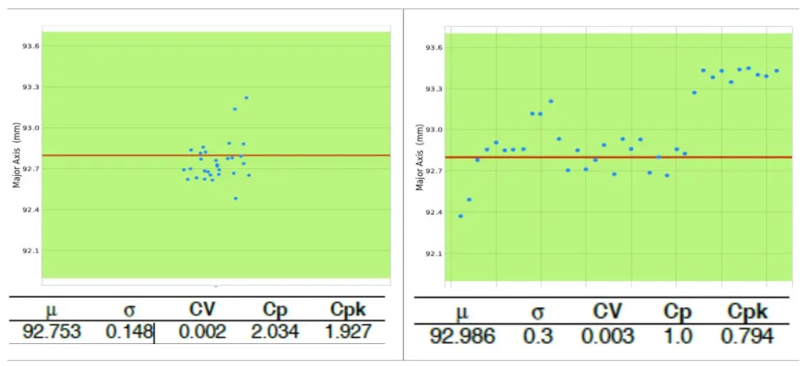

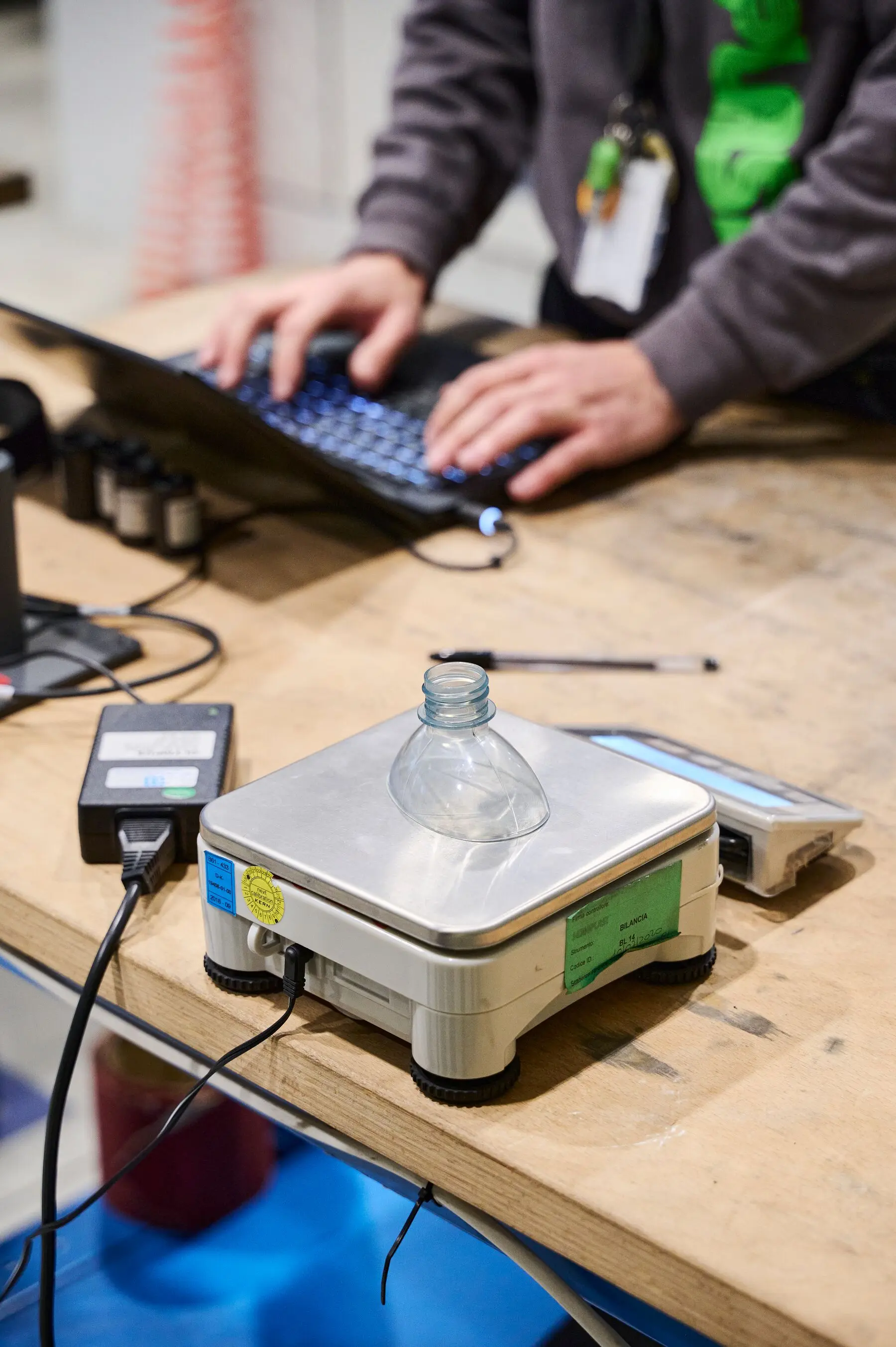

The team measured the dimensional accuracy of bottles blow molded with a 3D printed mold and compared it with the results from a production mold. The measurements were done with a coordinate-measuring machine (CMM) on a sample of about 40 bottles. The graphs below show the following parameters for the principal dimensions of the total height, major axis, and minor axis:
  • µ: mean
  • 𝜎: standard deviation
  • Cv: coefficient of variation
  • Cp, Cpk: process capability index
  • Δ: variation from production tool to 3D printed tool
BOTTLES BLOWN WITH A PRODUCTION TOOL
BOTTLES BLOWN WITH A 3D PRINTED TOOL
Total height
total height
Major axis
major axis
Minor axis
Minor axis
Evaluating the results:
  • The total height is the most controlled dimension with σ = 0.148 mm for the 3D printed tool. The results with a 3D printed tool are quite close to the ones from a production tool (Δµ = -0,572 mm) and show that it is not particularly altered by this new process.
  • The major axis is influenced by the bottle shrinkage driven by the mold temperature. The output with a 3D printed mold is variable because of the lack of cooling ( = 0.3 mm). More trials are necessary to predict the shrinkage behavior. (Δµ = 0.233 mm)
  • The minor axis is mostly influenced by the tolerances between the shell holder and the mold planarity in the closing phase. Small gaps can make a difference in the final dimension. (Δµ = 0.724 mm, Δ = 0,073 mm)
