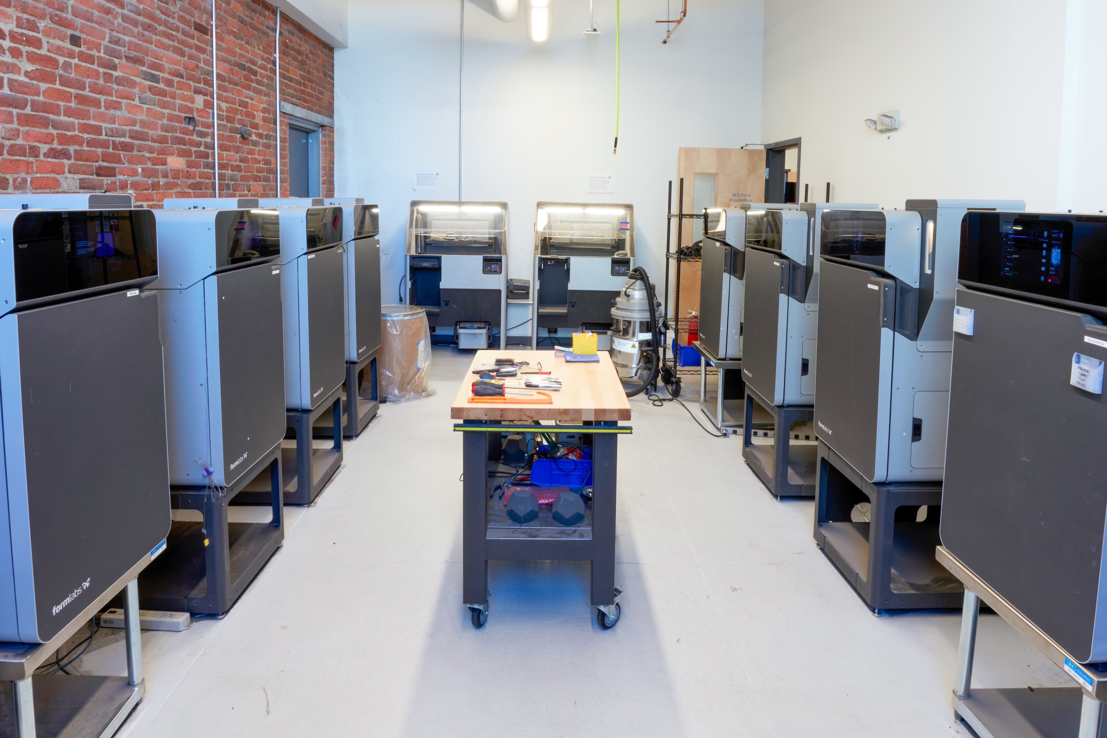

Formlabs R&D SLS materials lab in Somerville is about 37 m² (180 m³) with over 10 Fuse printers and four Fuse Sifts.

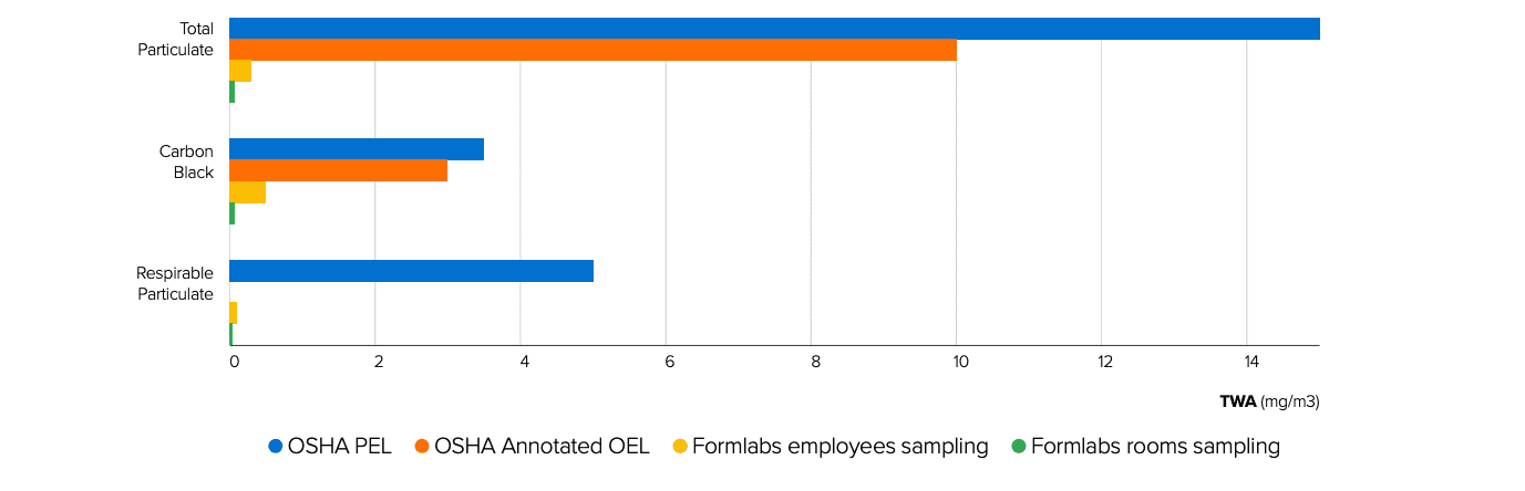

Average airborne powder concentrations associated with the normal use of the Fuse ecosystem are below 2% of the OSHA permissible exposure limit for the total particulate matter and respirable particulate matter, and below 15% of the OSHA permissible exposure limit for carbon black. Even with more than a dozen printers in one room, the normal use of the Fuse ecosystem does not represent a risk of respiratory adverse health effects and complies with OSHA dust exposure regulations.
graph
Averaged TWA concentrations of particulates measured at Formlabs SLS R&D facilities and TWA OSHA exposure limits.

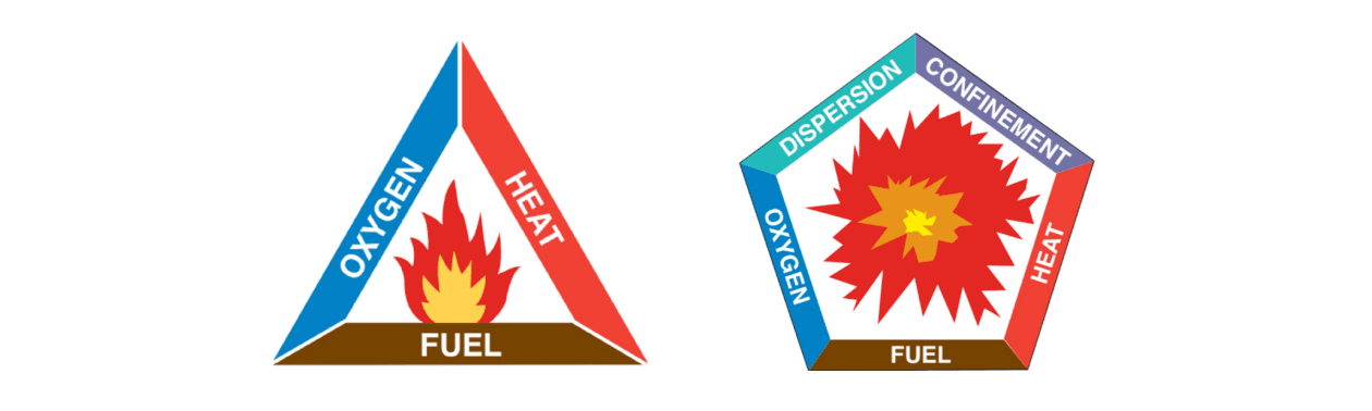

SLS powders, along with many other materials such as sawdust and flour, are combustible and can catch on fire under certain conditions. Three elements are required for a fire to occur: oxygen, fuel (combustible), and an ignition source. For an explosion involving a combustible powder to occur, two additional conditions are needed: the components must be confined in a contained volume and the dispersion or concentration of powder in air should be above the minimum explosive concentration (MEC).
fire triangle and explosion pentagram
The Fire Triangle and Explosion Pentagon.
Based on this understanding, Stonehouse evaluated dust explosion hazard potential by checking oxidizing atmosphere, credible ignition source, and credible suspension mechanism from Formlabs SLS ecosystem. They evaluated both the equipment and the building that are used to house the process, including the SLS powders, the Fuse Series printer, the Fuse Sift, the powder handling and processing areas, and the facilities’ housekeeping process.
