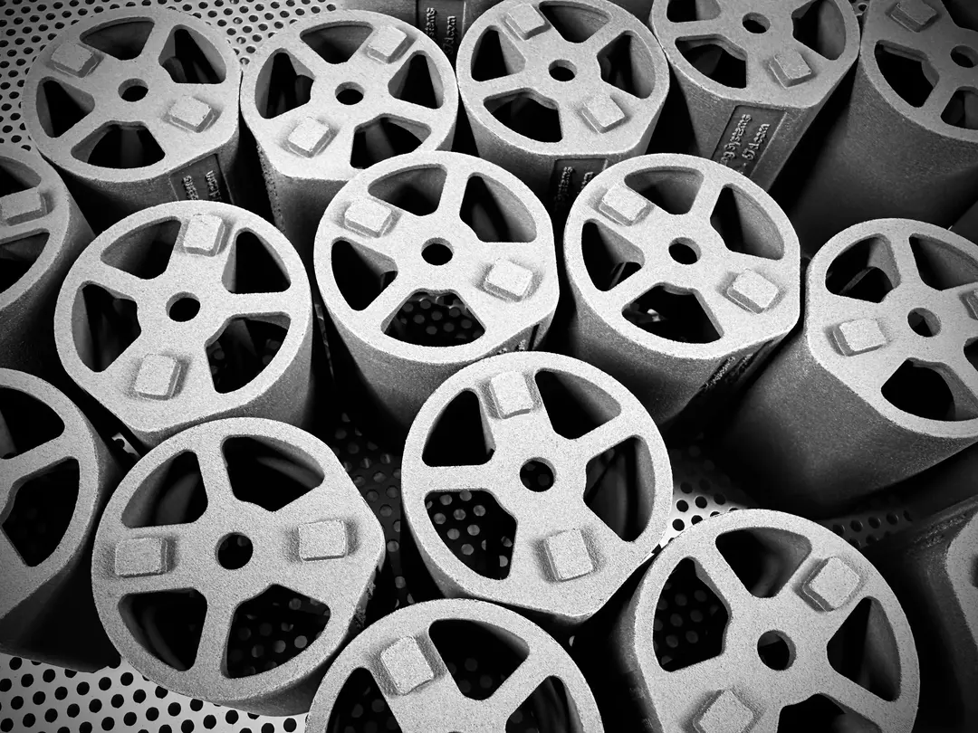

Step 4: (Distribution Class) Transfer Station
The new Centering Device is made up of a main base that stays the same, with interchangeable top parts that have been redesigned and optimized for material usage, strength, and printing efficiency.
The previously machined Delrin centering blocks (white Delrin affixed on top of a solid aluminum base, left) were heavy, clunky, and inefficient, not to mention expensive and difficult to get machined on short notice.
Different stages in the single-piece flow require MOVs to move through them at different speeds and with different spacing. To facilitate the transfer from one operation to the next, a transfer station has to rearrange the spacing of each MOV on the conveyor belt. A robotic elevator-like device picks up each MOV and moves it to the next conveyor belt, placing it down at its new spacing interval.
Historically, these recentering devices were bulky, heavy for the robotic operation, and made from clunky, machined Delrin. Though at first the team 3D printed a 1:1 replacement, the geometric possibilities with SLS 3D printing have allowed them to go one step beyond, creating a lightweight, easy-change device that saves on material and simplifies operations.
“When we first started incorporating 3D printing, we did direct replacements of machine nylon components. Now, we've kind of taken that a step further: how can we improve those original designs where we aren't confined by ease of machinability or ease of adoption. So it's been able to open up a lot of doors, a lot of new, more elegant designs."
TJ Zurell, Senior Manufacturing Engineer, Eaton at Olean

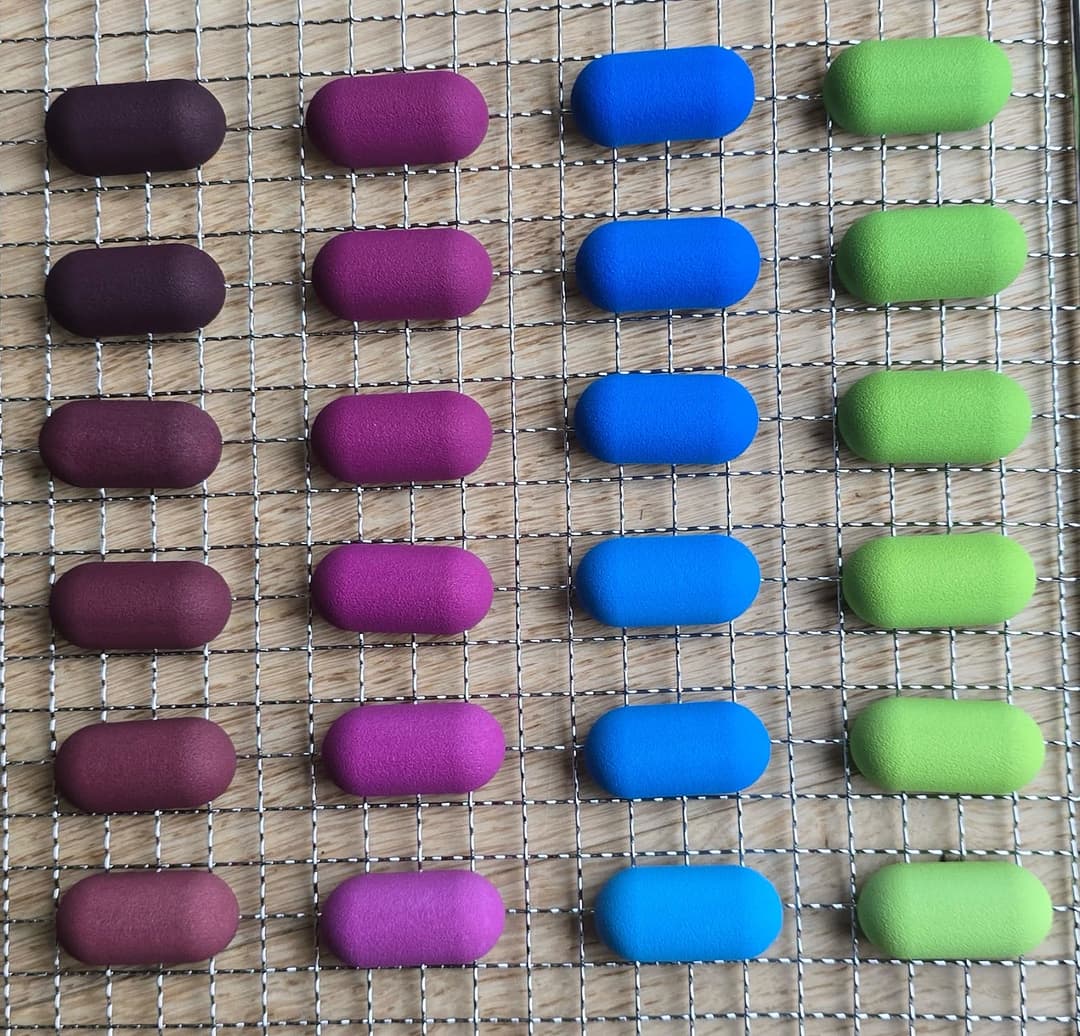

Step 6: Electrical Testing in Color-Coded Tester Cups
These tester cups hold the MOVs during the electrical testing phase, where voltage is shot through the parts to ensure performance when they’re assembled into full surge arrestors.
Previously machined from Delrin, the tester cups are needed in high volumes and for different-sized MOVs, which are identified by small colored FDM TPU inserts in the tester cups.
Ease of operation is a big driver of innovation at Olean. Previous versions of these tester cups were machined from Delrin and required masking tape or printed labels to identify which size of MOV was being tested. During line changeovers, these colored inserts make quality assurance easy — it’s immediately identifiable which part is being tested or needs to be changed. “We came up with a color coding system, a chart that will help operators quickly change over. So you'll see we have green, blue, and orange, and those all signify a certain size disc,” says Zurell.
The tester cups are a great example of utilizing both SLS and FDM 3D printing for their respective strengths. The cups themselves need to be highly accurate, strong, and impact-resistant, while the FDM colored dots are fast, easy to print, and require no special mechanical properties. “These were originally done in machined nylon. I think the cost out was about $17,400 for a full suite of parts that was needed. So this was huge,” says Zurell.
