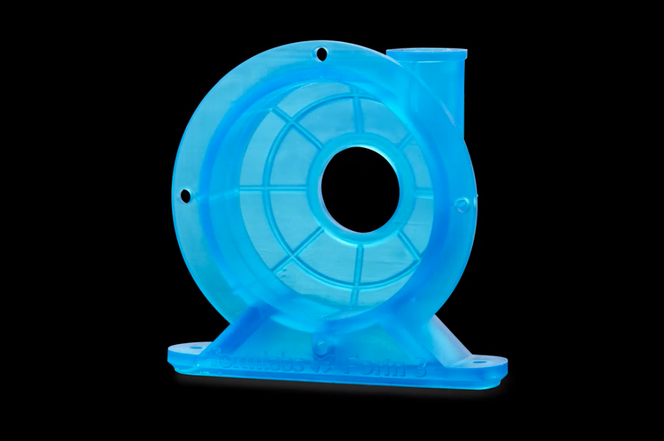

3D Printing
Professional 3D printers create three-dimensional parts directly from CAD models by building material layer by layer until a complete physical part is formed.
Manufacturing Process
  1. Print setup: Print preparation software is used for orienting and laying out models within a printer’s build volume, adding support structures (if needed), and slicing the supported model into layers.
  2. Printing: The printing process depends on the type of 3D printing technology: fused deposition modeling (FDM) melts a plastic filament, stereolithography (SLA) cures liquid resin, and selective laser sintering (SLS) fuses powdered plastic.
  3. Post-processing: When printing is complete, parts are removed from the printer, cleaned or washed, post-cured (depending on the technology), and the support structures removed (if applicable).
As 3D printers require no tooling and minimal setup time for a new design, the cost of producing a custom part is negligible in comparison with traditional manufacturing processes.
3D printing processes are generally slower and more labor-intensive than manufacturing processes used for mass production.
As 3D printing technologies improve, cost per part continues to fall, opening up a wider range of low- to mid-volume applications.
3D Printing
FormHigh degree of freedom
Lead timeLess than 24 hours
Cycle time< 1 hour to multiple hours, depending on part size and volume
Setup cost$
Cost per part$$$
VolumeLow to mid-volume applications (~1-1000 parts)
While most plastic manufacturing processes require expensive industrial machinery, dedicated facilities, and skilled operators, 3D printing allows companies to easily create plastic parts and rapid prototypes in-house.
Compact desktop or benchtop 3D printing systems for creating plastic parts are affordable and require very little space and no special skills, enabling professional engineers, designers, and manufacturers to speed up iteration and production cycles from days or weeks to a few hours.
Materials
There are many types of 3D printers and 3D printing technologies on the market, and the available materials vary by technology.
3D Printing Materials
Fused deposition modeling (FDM)Various thermoplastics, mainly ABS and PLA
Stereolithography (SLA)Thermoset resins
Selective laser sintering (SLS)Thermoplastics, typically nylon and its composites
