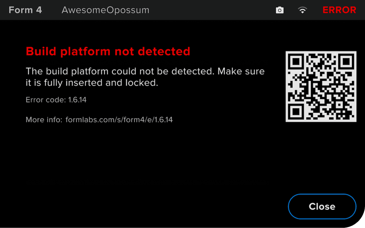

If the Form 4 or Form 4L encounters any abnormalities, the touchscreen displays error messages and displays more details about the error. This article outlines initial troubleshooting steps to resolve common error codes seen on Form 4 generation printers or that are expected during normal operation. If you encounter an error code not found in this article, refer to the general troubleshooting steps below.
Form 4 and Form 4L generation error codes have the format X.YY.ZZ, where X is the machine code, YY is the subsystem, and ZZ is the unique error code which signifies the relevant warning. The machine code for Form 4 generation printers is 1, so the full error code for all such printer errors starts with 1. The error group number describes the type of error, while the subcode designates a specific subsystem or failure mode. For example, all subcodes of Form 4 generation Error Group 3 relate to the heater and resin temperature, while Error 1.3.1 in particular relates to the resin failing to reach the target temperature.
An example of a Form 4 error message

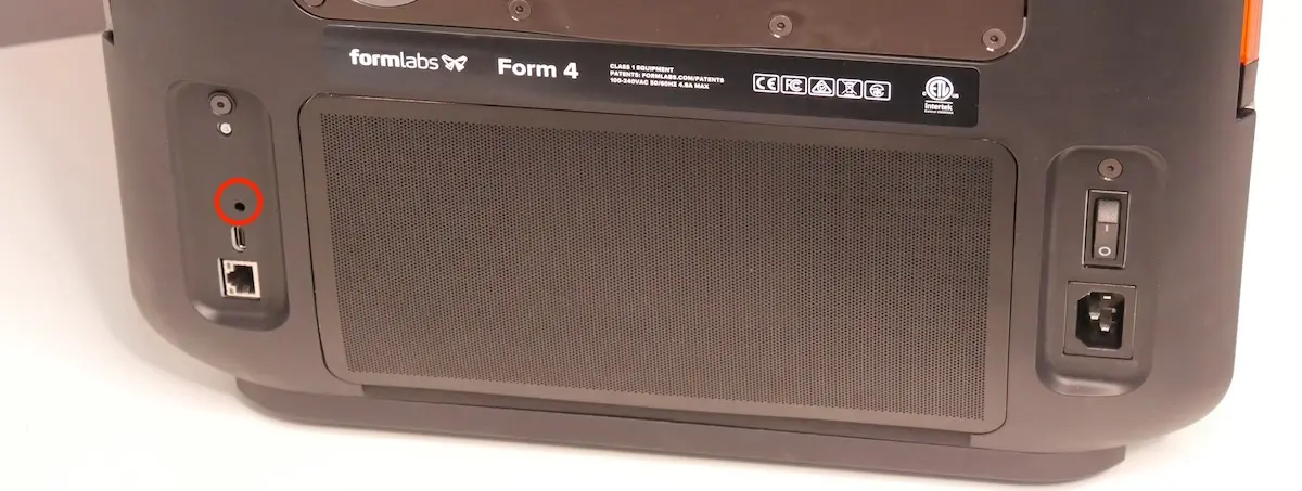

    3. Power cycle the printer using the switch on the rear of the machine. Leave the unit powered off for at least 30 seconds before powering back on.
    4. If an issue persists and the printer’s firmware is already up to date, manually reinstall the latest firmware package.
    5. If an issue began immediately after updating the printer’s firmware, roll back the firmware package to the previous version.

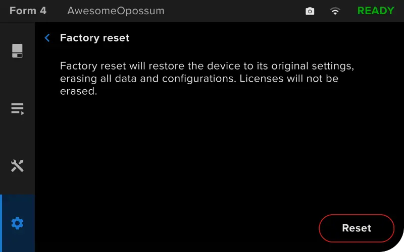

  1. Perform a factory reset.
  2. If the error persists, replace the motherboard. Follow the instructions in the repair guide Replacing the Form 4 motherboard (post 2024-11-15), Replacing the Form 4 motherboard (pre 2024-11-15), or Replacing the Form 4L motherboard, depending on the type and date of manufacture of your printer. Replacement motherboards can be purchased from the Formlabs web store.

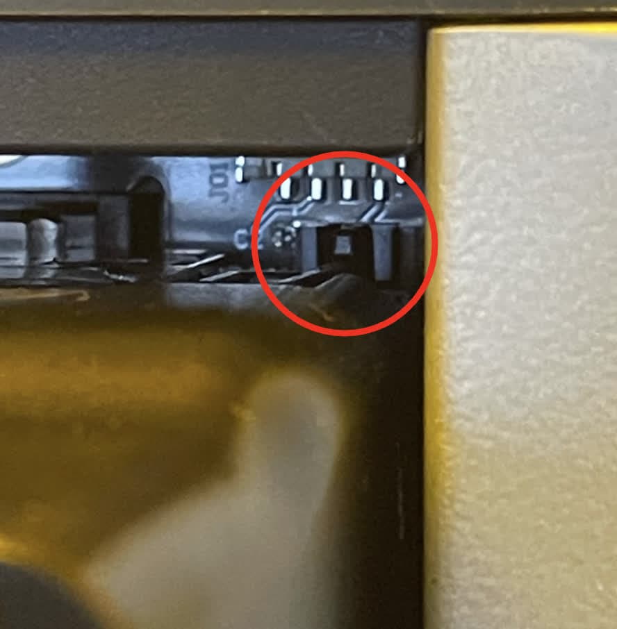

  2. Ensure that the printer's firmware is up to date. If the firmware is up to date, manually reinstall the latest firmware package.
  3. Inspect and reseat the LevelSense cables.
  4. If the error persists, replace the LevelSense board. Follow the instructions in the repair guides Replacing the Form 4 LevelSense board or Replacing the Form 4L LevelSense board. Replacement LevelSense boards can be purchased from the Formlabs web store.

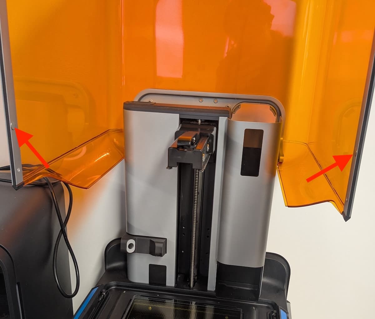

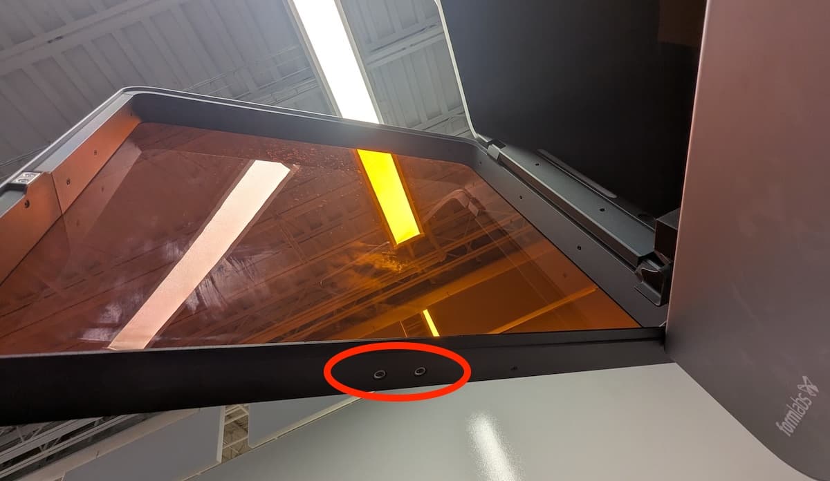

Error 1.1.17: Cover opened
Error 1.1.17 indicates that the cover (Form 4 generation) or door (Form 4L generation) was opened during printing. For safety reasons, the print pauses whenever the cover or door is open. Close the cover or door to continue.
If the cover or door was not open or closing it does not resolve the issue:
  1. Open the cover (Form 4 generation) or door (Form 4L generation).

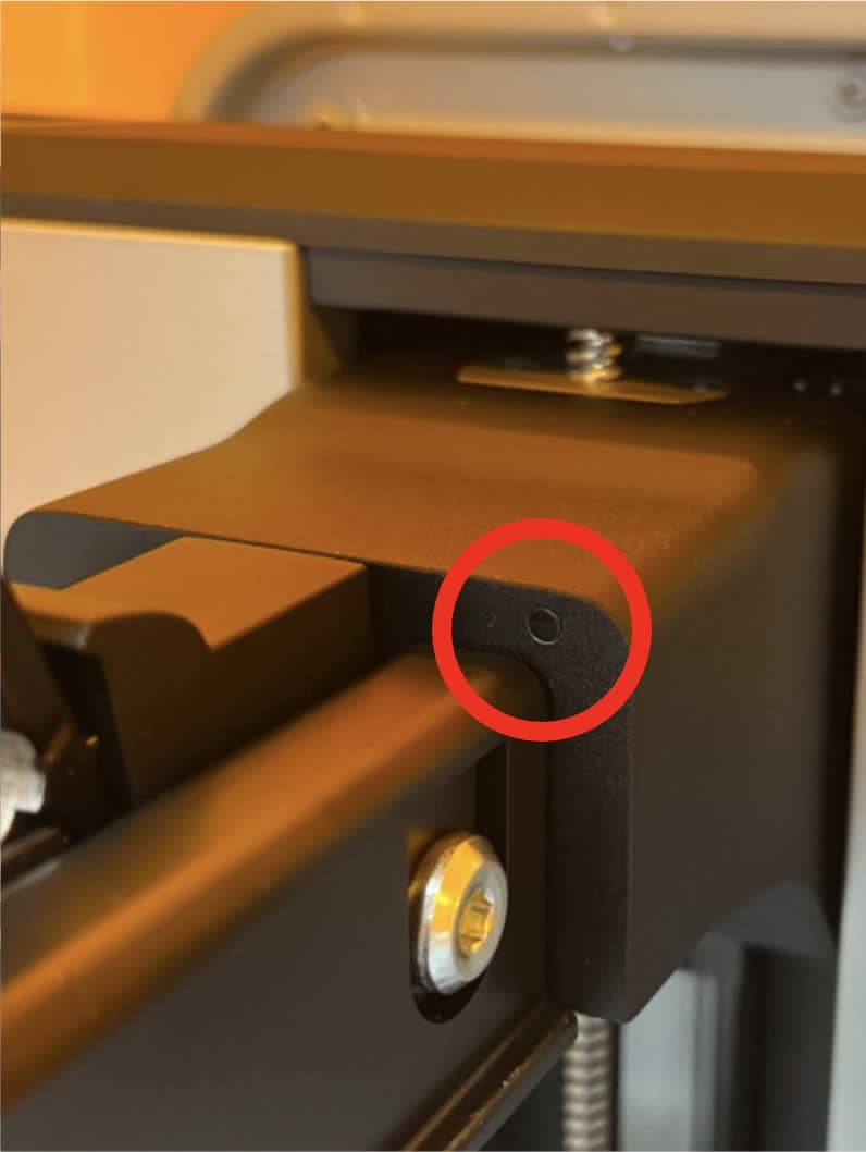

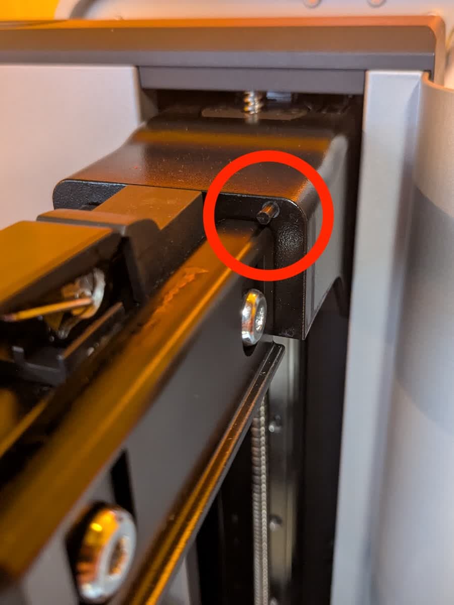

  2. Check for the interlock magnets.

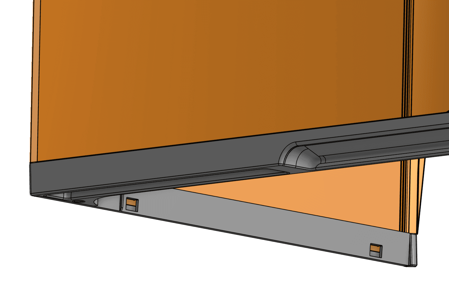

Form 4 generation: The printer has two round interlock magnets glued to the bottom edge of the cover.
Form 4 generation: On newer Form 4 generation printers, the magnet is held in place under the cover trim. It is less likely that these magnets will become damaged or dislodged.
Form 4L generation: The printer has two round interlock magnets on the bottom edge of the door, each secured by a screw.
Form 4 generation: The printer has two round interlock magnets glued to the bottom edge of the cover. The magnets are N52 grade. 10 mm in diameter, and 2 mm thick.
  1. If any magnets are not present, contact Formlabs Support or your authorized reseller for assistance.

Error 1.6.14: Could not detect build platform
Error 1.6.14 indicates that the printer could not detect a build platform. Insert and secure a build platform to continue. If you are certain that a clean build platform is inserted in the printer, you can also tap Ignore to continue.
If that does not resolve the issue, open the printer cover, remove the build platform, and inspect the plunger pin in the top-right corner of the build platform mount.
Normal Form 4 build platform detection plunger
Stuck Form 4 build platform detection plunger
If the plunger is visible:
  1. Manually push the plunger in. If the printer detects that a build platform has been inserted, try again with another build platform (if available).
  2. Reboot your printer.
  3. Ensure that your printer's firmware is up to date. If the printer’s firmware is already up to date, manually reinstall the latest firmware package.
  4. Check if the U-shaped limit switch on the far side of the plunger is undamaged.
Form 4 build platform detection limit switch location
If the plunger is stuck inside the build platform mount:
  1. Download the plunger trim tool. You can also contact Formlabs Support for the tool.
  2. Print the tool in any inflexible resin, such as Grey Resin, Tough 1500 Resin, or Rigid 10K Resin. Do not use Elastic 50A Resin, Flexible 80A Resin, or another resin with similar material properties.
    • If you see the Could not detect build platform error, tap Ignore to continue.
  3. Wash and post-cure the parts appropriately for the material you use.
  4. Remove the resin tank and build platform. Close the printer cover.
  5. On the printer touchscreen, tap the gear icon. The Settings screen appears. Tap Tools > Move motors > Start.
  6. Under Z Axis, tap Mid. The build platform mount moved to the middle of the Z-axis lead screw.
  1. The build platform detection plunger should now be free.
    • If it remains stuck in the build platform mount, use a tool or finger to pull the plunger forward towards the front of the printer, as shown here. The plunger should protrude 4–5 mm from the front of the build platform mount. Repeat this process as needed until the plunger returns to the protruding position on its own.
  1. Place the plunger trim tool over the build platform mount. Adjust the tool until the plunger extends through the hole on the right side of the tool. Press the tool firmly towards the back of the printer.
  2. Press the flat side of a sharp pair of flush cutters flat against the circular pad on the trim tool that surrounds the plunger. Use the flush cutters to trim away the length of plunger that extends beyond the trim tool.
Notice:
Do not cut the plunger without the trim tool. The trim tool ensures the correct length is cut. Cutting too much will prevent the plunger from interacting with the build platform sensor, permanently breaking build platform detection.
  1. Insert a clean build platform into the printer. Close the printer cover.
  2. Tap Close. The build platform mount returns to its home position.
  3. If you see a notification that the build platform was detected, the fix was successful.
If the error persists, contact Formlabs Support or your authorized reseller for assistance.

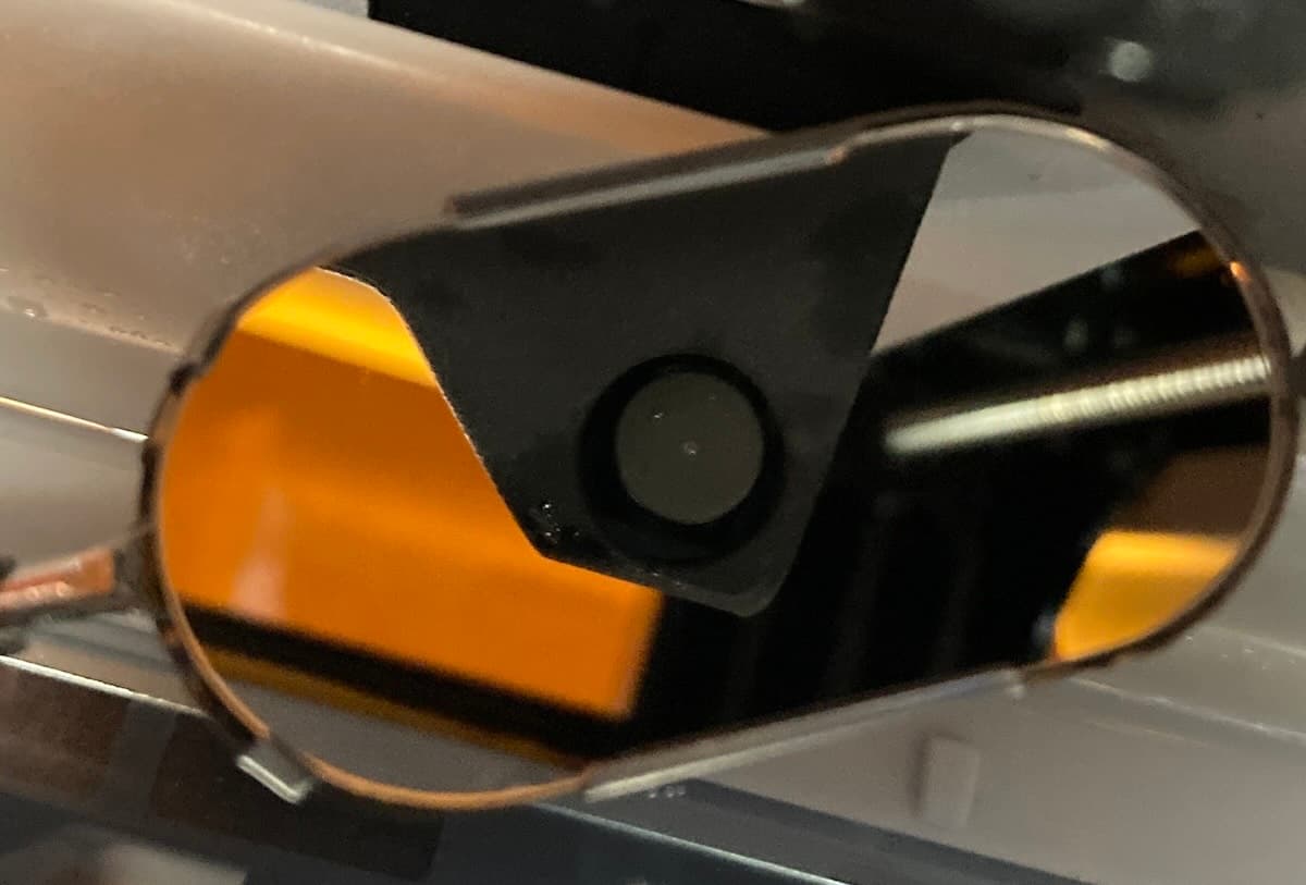

  2. Check for obstructions blocking the resin sensor, either on the sensor or between the sensor and the resin tank. It is located next to the camera, pointing down at the back-left corner of the resin tank.
  3. Check for any drops of resin on the sensor. You may need to use a mirror to look upwards at the sensor. If you see any resin, clean it with a lint-free cloth dampened with isopropyl alcohol.

Error 1.12.2: Camera is not connected
Error 1.12.2 indicates that the camera, which is used to capture post-print photos, is not connected. If you purposefully disconnected or removed the camera, ignore this message. To resolve this issue:
  1. Reboot your printer.
  2. Ensure that your printer's firmware is up to date. If the printer’s firmware is already up to date, manually reinstall the latest firmware package.
  3. Inspect and reseat the camera ribbon cable.
  4. If the error persists, replace the camera. Follow the instructions in the repair guides Replacing the Form 4 camera or Replacing the Form 4L camera. Replacement cameras are available from the Formlabs web store.

Factory reset instructions
On some occasions, a factory reset may correct unusual printer behavior. Unusual behavior may include unknown error messages, incomplete firmware updates, an unresponsive touchscreen, or trouble connecting to PreForm. A factory reset erases custom settings, including prints saved in the Queue and network connections.
Notice:
A factory reset erases all print job information, custom settings, and diagnostic logs. Upload diagnostic logs before performing a factory reset.
To perform a factory reset:
  1. Tap Settings > General > Factory reset. The Factory reset screen appears.
  2. Tap Reset. A confirmation screen appears.
  3. Tap Reset. The printer is restored to its original settings.

If you cannot perform a factory reset using the touchscreen, use the physical button on the back of the machine:
  1. Turn the printer off using the power switch at the back of the machine.
  2. Turn the printer back on.
The factory reset button on a Form 4 generation printer
  1. When the Formlabs logo appears, push and hold the reset button located above the USB port in the rear of the printer. If you press the button too early, the printer will not boot and the touchscreen will flash until you power cycle the printer. Hold the button for at least 10 seconds, until Resetting to factory defaults appears on the touchscreen. You may need to use a paperclip or other small tool to push the reset button.
  2. Release the button. If you release the button too early, power cycle the machine and try again.
  3. The touchscreen displays Factory reset complete before initializing the printer.
