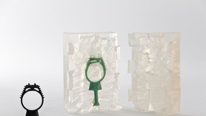

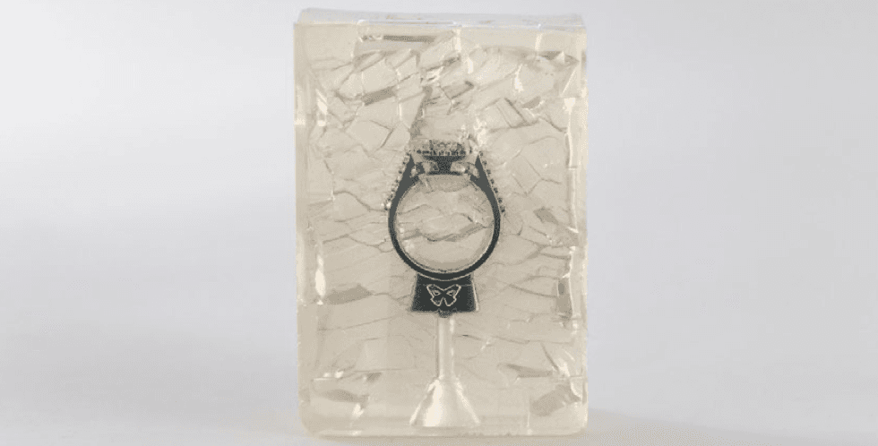

RTV silicone may be clear, which can be helpful when cutting molds with complex geometries.
