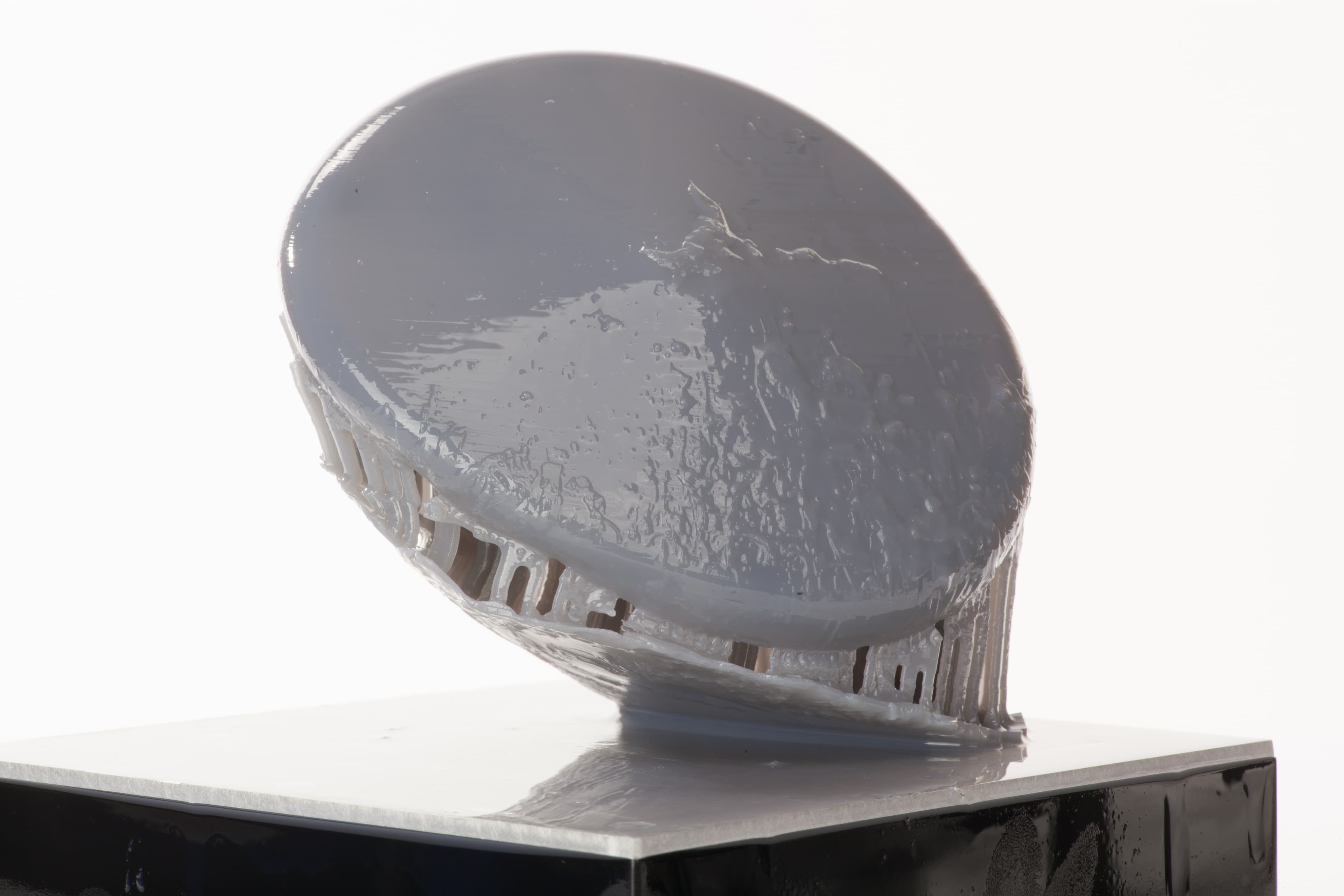

Part peeling away from the build platform
If you've had this problem while trying to print very small parts, you may have more success by trying another print location. Particularly, if printing in the middle of the build area, try moving to parts to the hinge side.

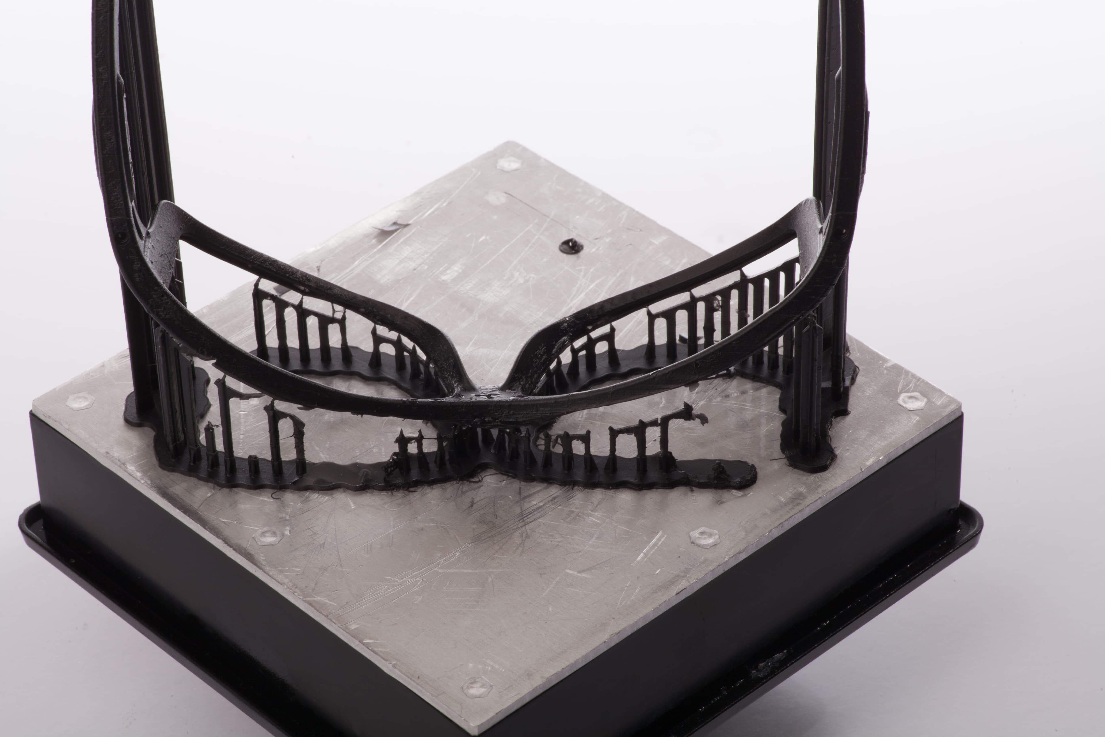

Part separates from supports
If the part was pulled from the supports, that usually means that the support tips were not strong enough. Try experimenting with the advanced support settings specifically by:
Model on the build platform with gaps where the part has separated from the supports
  • Increasing the touch-point size.
  • Increasing the density of supports.
  • If you are printing a larger part, it may be under-supported. You can add add manual supports, especially if the part is separating in one area.

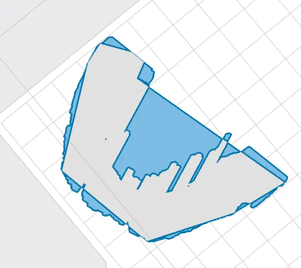

  • A problem with your model mesh or orientation. Walk through the slicer in PreForm and if you see abnormalities (such as a hole or abnormal geometry), then go back into your 3D modeling program and check the mesh and how the faces of your geometry are joined.

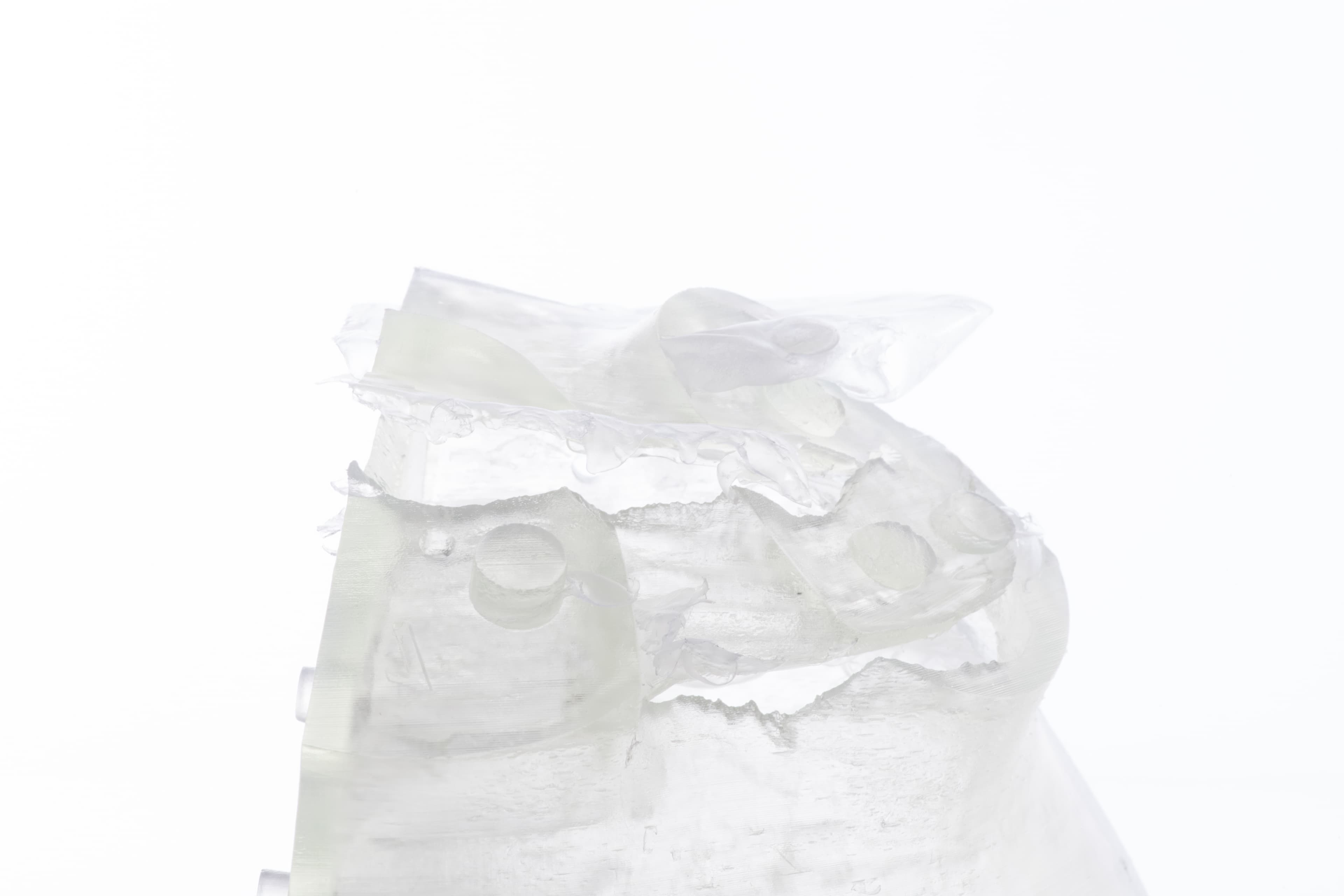

Explosions from cupping
If you are printing a hollow object but have no drainage for it, it may “explode,” with a small failure propagating throughout the part. To ensure your hollow model prints successfully, change its orientation or add a hole for drainage.
