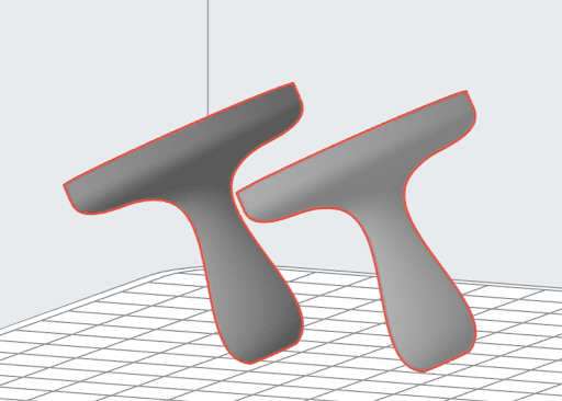

Separate part clearance
PreForm indicating that two SLS parts are too close to one another
Minimum: 1.0 mm/1,000 microns
Recommended: 2.0 mm/2,000 microns
Clearance is the distance between two parts of a model. Parts that are intended to be separate and not interact with one another should be placed at least 2 mm apart to minimize thermal warping effects from the neighboring part.

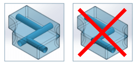

Minimum drain hole diameter
Recommended: 3.5 mm/3,500 microns
Enclosed cavities remain filled with unsintered powder without proper drain holes. For best results, include at least two drain holes when designing a cavity, each greater than or equal to 3.5 mm in diameter.
Model showing the minimum recommended drain hole diameter for parts printed on Fuse 1 generation printers
Tip:
More and larger drain holes make it easier to remove unsintered powder from internal cavities. To guarantee a clean internal surface, design the part so that the surface in question is easy to access with cleaning tools.
